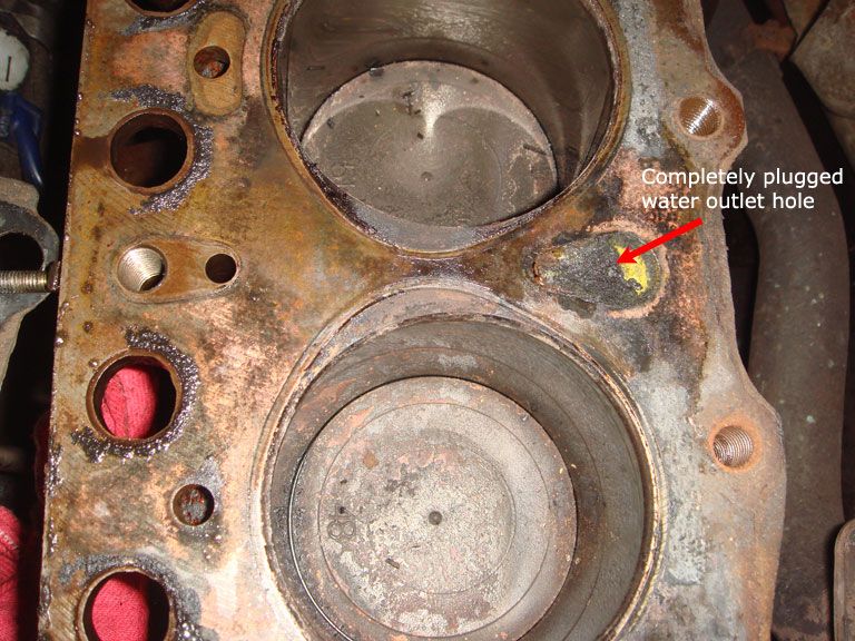

Overheating is not always caused by bad fan clutches, clogged radiators or malfunctioning thermostats.
The water inlet openings at the junction of the head gasket on the head and block can plug up with a clay like gummy substance that blocks the water flow completely. The slightly ferrous "clay" can grow over time and can seal off coolant openings on the block and head completely.. blocking the flow of coolant to the head.
[Edit - The plugged coolant opening shown below developed in only 5 years.]

I know this is an oldy but this is the first post I’ve come across that makes sense with my symptoms and condition of my engine.
Do you know a way to clear these passages without removing the head? Pipe cleaner / coat hanger through freeze plug opening? Etc.
I’m thinking my water jacket needs a cleaning. Cooling system is new (new rad, water pump, thermo, fan clutch) and works great until a long hill climb. Then temps rise towards red. (86 HJ60)
Some people use a weak hydrochloric acid acid solution. Im not sure of the procedure. But fit some nylon stocking across the coolant inlet to the radiator to stop anything that gets loose from entering the radiator
