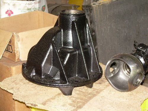

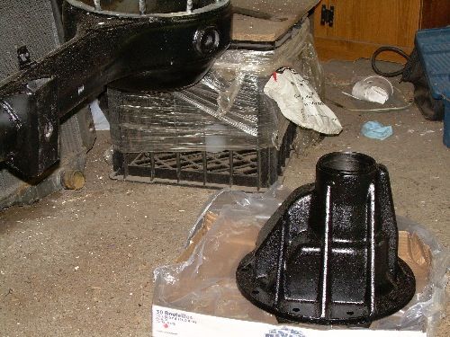

Well sports fans, I have some more pictures to post. first, a couple of shots of the diff. housings, freshly crushed-glass blasted, primed and painted. The spots on the parts are just some dust that got blown onto them.

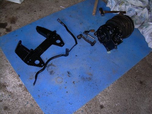

Here's some shots of the new a/c compressor and its mounting bracketry - 5 cast pieces comprise the mounting (!), all of which I blasted primed and painted, then installed with new CAD-plated bolts. I need to get a hold of the correct double pulley for the front of the water pump, and will be sending my single pulley to the fellow I bought the pump from in exchange for the double one.

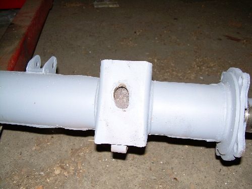

Pictures of the rear axle, showing the mangled spring perches. I've taken a cold chisel to the inside of the torn holes and chopped the metal out. Next I will put some copper plate in as a temporary backer and weld-fill the holes. Then it will be a simple matter to grind the perch surface flat, re-drill the holes, and make it all good again.

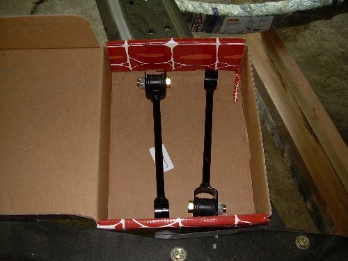

Today I received the components to rebuild my anti-sway bar from Australia. I got Toyota links, D-bushings, upper and lower link bushings, bolts, and mounting brackets. The old links had stretched mounting holes and the mounting brackets were fairly pitted, so I went with new stuff. Should be 'set and forget' for the next 20 years
Another photo of the completed install of the sway bar. I just need to pick up some stainless split pins and complete work on the rear axle mounts and it's done.

Left work a bit early today and got a good 7 hours in on the truck, mostly welding work on the rear axles. I welded on some .25" plate onto the rear spring perches, and on the front, since the holes were less elongated, I backed them with copper plate, filled in with weld, and then was able to grind them flat and re-drill the holes to the correct size. The front axle required 15/32" holes, while the rear required 9/16" holes.
I tried to build up with weld the damaged section on the rear axle tube where the u-bolts had crushed things a bit - the result of my efforts was some improvement, but a little short of perfect.

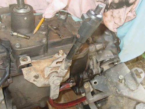

I sourced a pto lever mounting bracket from a 70 series, and it pretty much bolts right onto the transmission, save for one corner. I will cannibalize the auto-trans plate (visible in the top picture perched atop the pto drive unit) tomorrow for a section to weld in to connect the raised tab with the rest of the plate. I'm also really looking forward to the day when I do the transmission-to-transfer seal and can remove the frickin' red hose from the tranny and put the proper fill plug back in place.

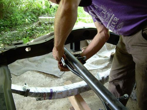

then a show of the rear of the rad frame and shroud, with the rad support bars that I just finished straightening. Will repaint tomorrow.

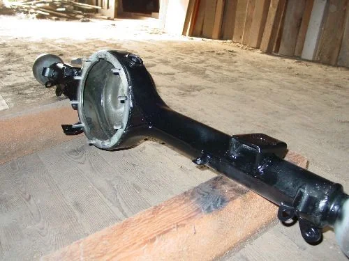

The last two shots are of my axles, at last getting their final paintwork. I'm soooo looking forward to putting the axles back in place. The shackles still haven't shown up yet, so I will probably throw the originals back on for now so that I can get the axles and brakes all together.
