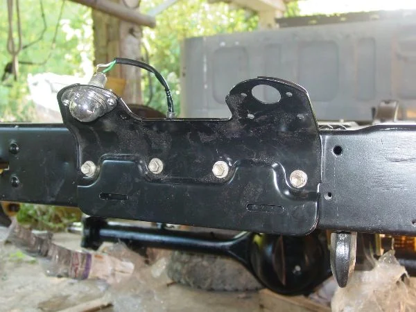

I mounted the license plate bracket and one of the lights on. The was a pretty simple affair, mostly involving figuring out where to place it, and then drilling 4 holes. I tapped them too, but I don't think the attachment is all that solid so I'll probably back them up with nuts.

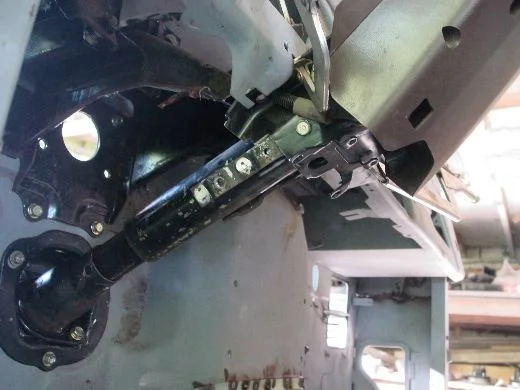

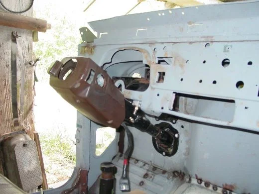

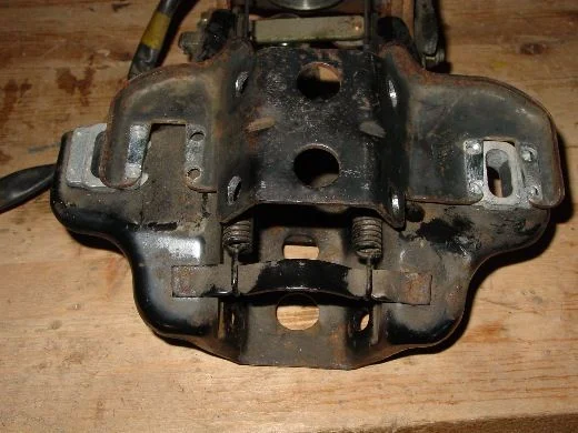

The last tow days have seen some progress on getting a 60 series column to work. I picked up a second column from the wreckers.

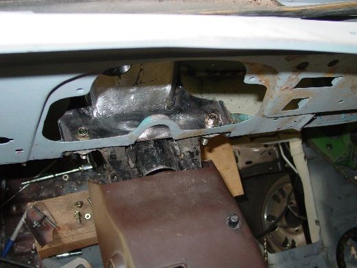

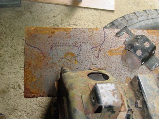

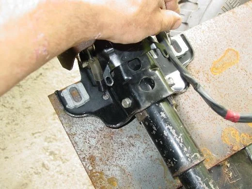

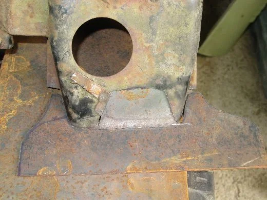

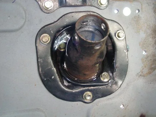

The first puzzle was fitting the column to the firewall. The shape of the 60 flange mount would require cutting into the firewall and relocating mounting positions for bolts, yada-yada. I couldn't be certain of where the centerline of the hole would be. I thought about it a bit more, and decided to cut part of the 60 series column mount, and fit into into the 40 series mounting flange. I rigged one up and tack-welded it together. It isn't looking especially :princess: at the moment, but it looks like it will work.

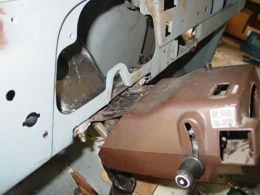

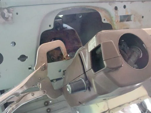

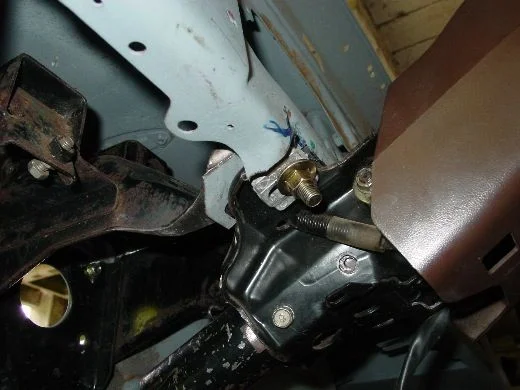

Then I took the plunge and chopped some metal out of my lower dash. The 60 column needs some additional room opened up to get it to fit high enough. The first picture shows the column I had modded previously, clamped up into position.

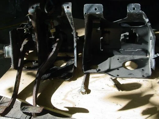

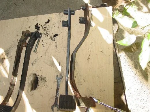

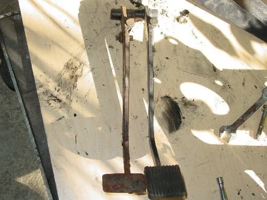

Then I discovered today's '1 step forward 2 back' item: the RHD pedal box, which I had assumed would be the same as the LHD one, turns out to not fit at all. This is after carefully media blasting, priming and painting it, along with the pedals. Not only is the box itself asymmetrical to the place it could be fit to, but the pedals are shaped differently as well. With the RHD box pedals, they don't work well with the lower the steering column the need to fit around.
So, it was over to E4 to look at one of the wrecks in the yard to see if John had a pedal box, and he did: a 1977 one in the FJ40 wreck and a 1982 one out of a BJ42. The '77 one had the 3-bolt clutch master as my firewall incorporated, so I went with that, though I had been toying with the idea of converting the firewall mounting to the newer 2-blt clutch masters. John, i might add also wanted to hold onto the newer one if he could, to have as a spare.
Here you can see the difference between the RHD pedal box and the LHD one I picked up today.
It was a bit deflating to have to deal with the whole clean up and repaint of the pedal box, but the advantages actually are in the new LHD box, as the shape of the box itself makes it easier to modify in some ways.

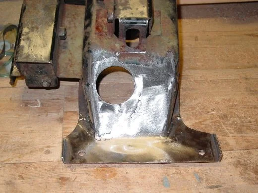

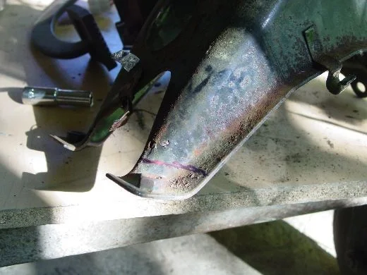

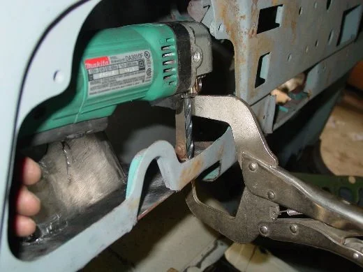

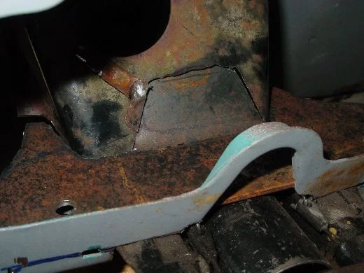

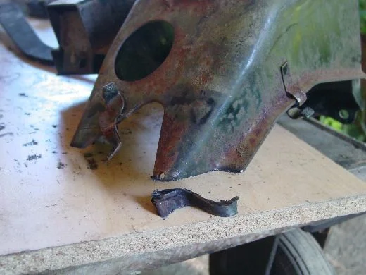

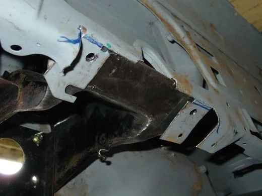

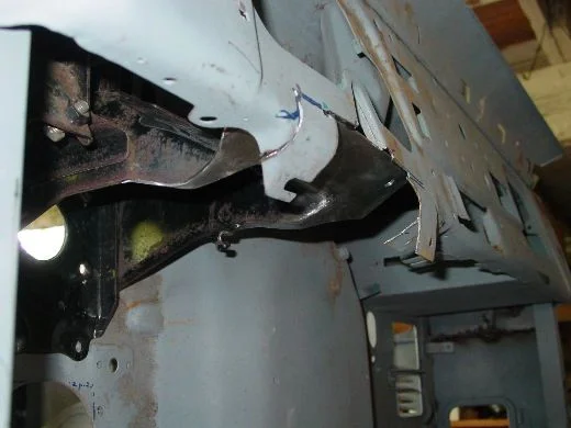

First, because of the way in which the column has to rise up into the lower edge of the dash, the lower extension of the box-dash mounting had to be cut back. I marked it out after eyeballing the best line I could, erring on the conservative side, and chopped it down.
Then I chopped it a bit more after another trial fit

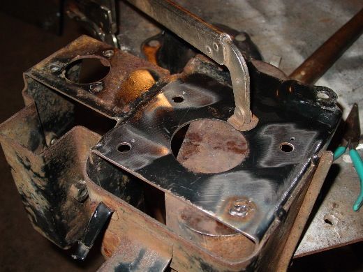

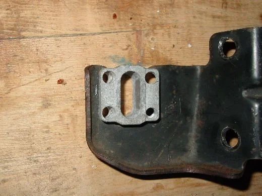

I'm planning to weld a 1/8' plate across the pedal box-dash mount s and then mount the 60 series column's breakaway type of aluminum mounts to the pedal box as well as the dash. The purpose of the aluminum bolt mounts, with little cast plastic ties within, is that in an accident, if I were to slam forward and hit the steering wheel with my chest, it would collapse inward to the dash. I hope I never get to test out that feature, let me assure you. I aim to fit the column so that this breakaway feature can work as it should. If you're wondering why the mounting bracket with the alu. bosses is not visible in the second picture, that's because it's a separate piece that i have left off for the moment

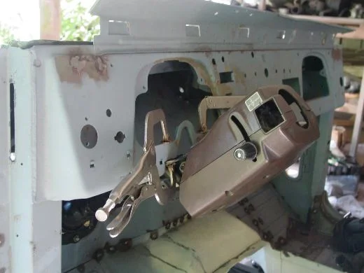

I spent a bit more time then getting the seat set up in the approximately correct place to check the steering wheel position and range of tilt.
The current positioning of the steering wheel leaves me wondering if I needed to bother at all with those previous mods I did to the column, the chop job I did so as to allow the mounting points it to hold the steering wheel in the same relative place as the 40 series column did. The mounting would be so much better with the original boss location.
The steering column's plastic shroud will look better the closer it is in towards the dash, and I noticed that if the wheel were inwards a couple of inches from the stock position (which frankly does seem a little in too far towards my chest), then it would still be a good spot, and the mounting between the column, pedal box, and dash would be be better all around. So long as I get a rock-sold connection between the steering box and the dash, in such as way that I can then swing up into location and bolt the column to that assembly using the alu. breakaway bit, then all should be golden.
So, 45/47 owners out there: sitting behind the wheel of your rig, given the small amount of seat adjustment that you can have in cab, do you think that the steering wheel would still be in a good position if it were in towards the dash 2 inches? I could use some feedback so please don't be shy.

I think it'd be ok, especially with the smaller wheel. one of the issues with the 45's is that the giant wheel is a bit low, so what you're doing should help in that regard...
I like what you're doing with the column, I may have a go at that with a 70 series column at some point...
I don't think the two inches would make a lot of difference.
I've actually shorted a colomn for a guy once by about an inch. He was a really short guy and he had to move the seat at the most forward point to get to the pedals. Only to find the steering wheel to close.
I'm 6'4" and could drive that 45 pretty easy to.
HTH
Mark
After sitting in mine for about an hour pretending to steer and shift it, I think 2" closer to the dash would be fine. The biggest problem it might present is that it would lower the bottom edge of the wheel and reduce the space between the seat and the wheel--making it harder to slide in there. But I think it'd be fine.
Especially with a smaller wheel I think you'd have no problem.
Dan
After a bit more work on mocking up the new column, I'm pretty much convinced that having the wheel another 2" forward will be if anything a benefit. Thank everyone for your feedback - it was helpful. The tilt feature allow me to set the clearance to my legs as I like, and the point raised by a couple of you that I could downsize the steering wheel if necessary, gave me an additional useful option to get the set up just right.

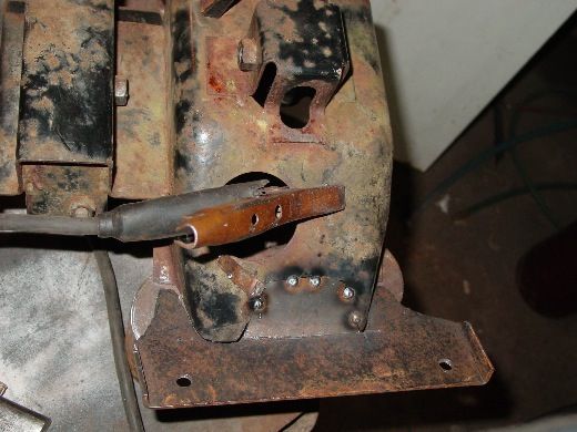

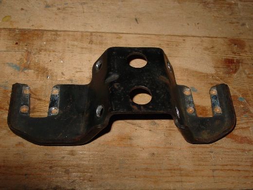

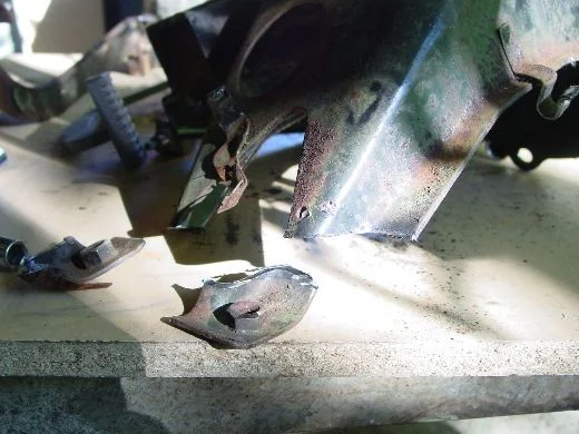

I noticed that the steering column bracket from the mini-truck, which I had previously grafted on to my first 60 series column, would make a good mounting front pedal box mount if turned upside-down, the aluminum bosses removed, and then welded to the pedal box. So, that's what i set about doing today. The camera was low on batteries so I didn't get too many shots - here is the bracket, then the holes drilled out, and then the raw piece.

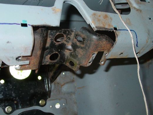

I chopped a little more out of my dash and got the position of the column into a pretty straight line, though you can only see some preliminary marking lines in the second photo. I've taken the horizontal line up to the top of the square holes (used for mounting clips for the dash pads). I think it's gonna work! I may have to cannibalize a third column (and maybe another pedal box...), to get material I want to make the column just the way I want it. Once I have the pedal box support finished, then I will form a piece of sheet metal to conform to it so as to re-establish the lower edge of dash sheet metal.
You can see that the mini-truck bracket has a narrower spacing between bosses, so I might take a trip to the wreckers to see if I can find something maybe a little better. I've pared even more material off it now so to tuck it close against the inside face of the dash sheet metal, and up to the pedal box, which has also gone through even more radical slicing.

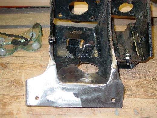

Today I abandoned the support bracket that I had taken the alu. inserts off of yesterday. I found a chunk of 1/8" plate, and fabricated a support bracket from scratch. I realized that the span across the top of the breakaway inserts was flat, and thus the arched style of the other piece I was messing with was unnecessary.
