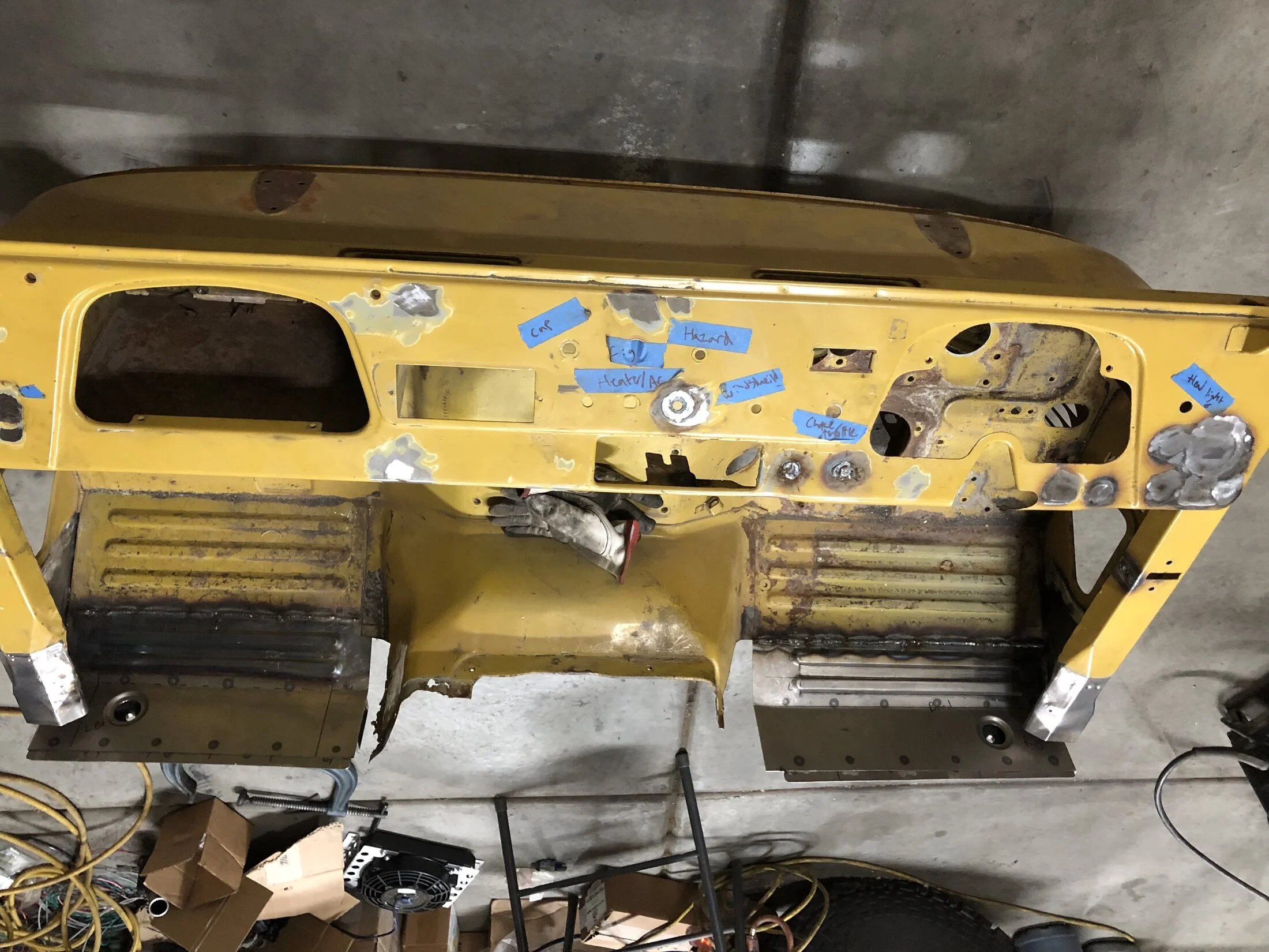

Installed the front floors and supports, filled dash holes, fixed the bottom of the pillars.

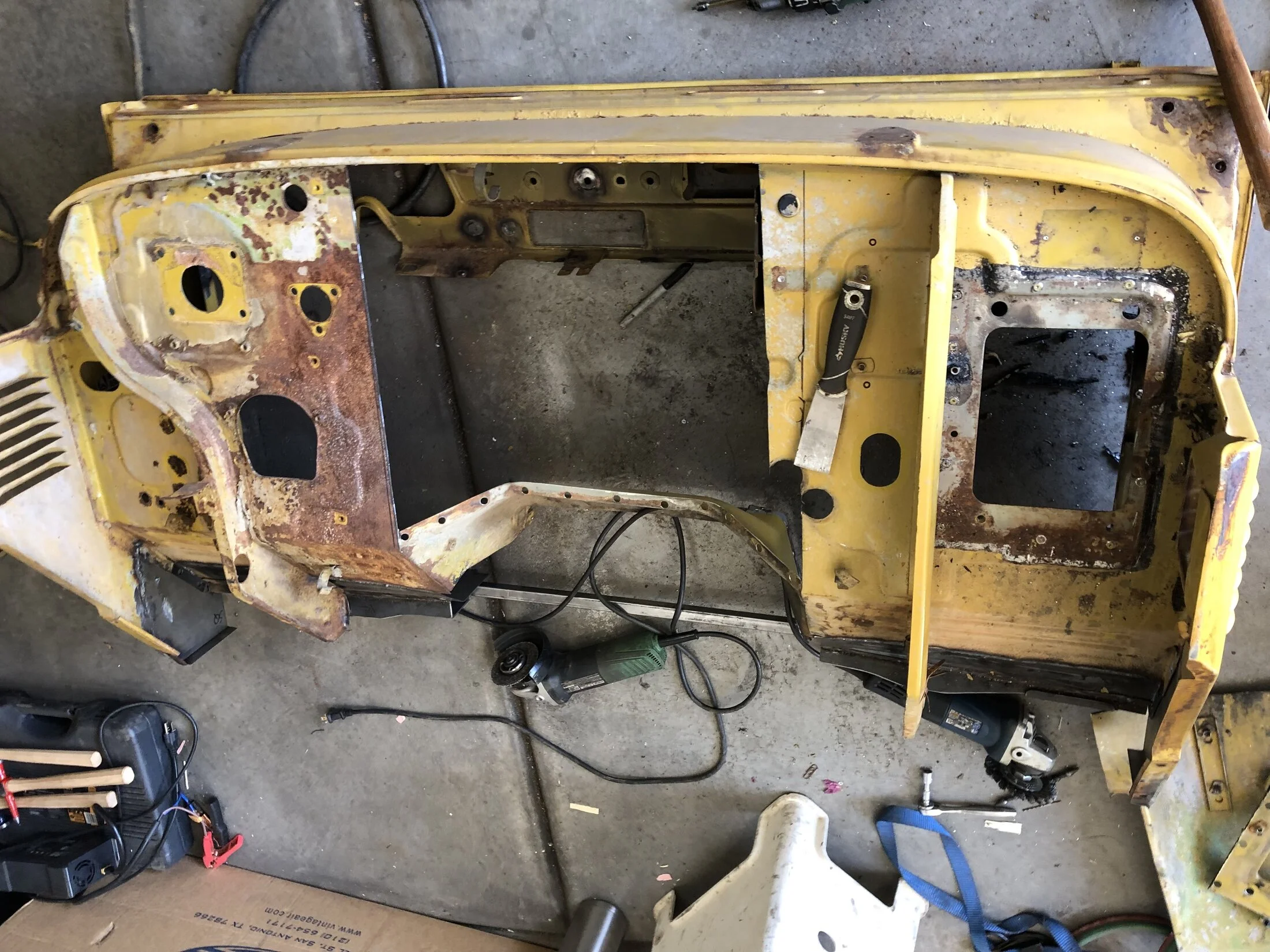

Cut out part of the engine clearance hump - with the v8 this will be flat, and it needs to be flat to fit the vintage air in a RHD vehicle since everything indexes off of that for the vintage air style AC units. I also removed the blower panel.

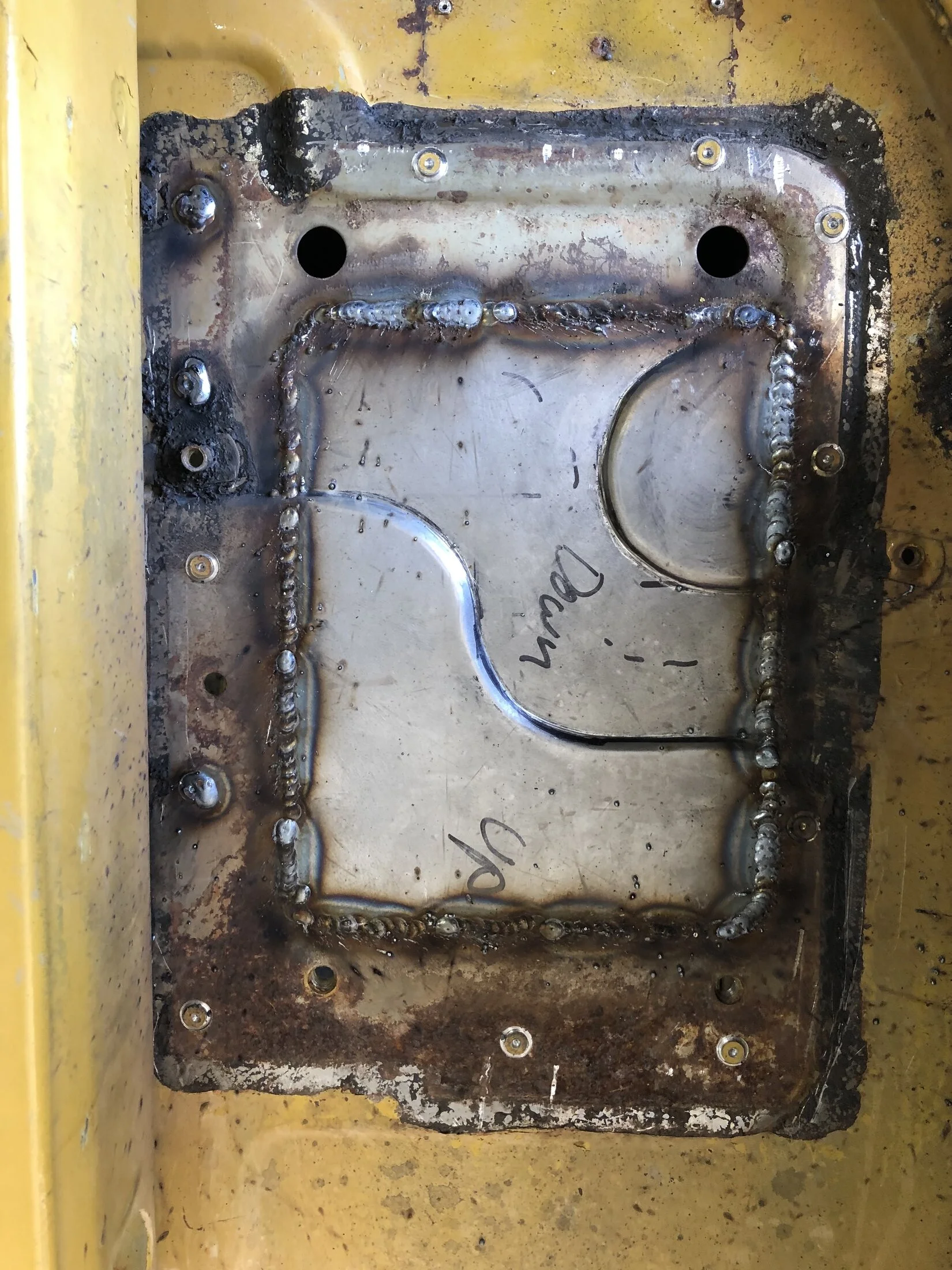

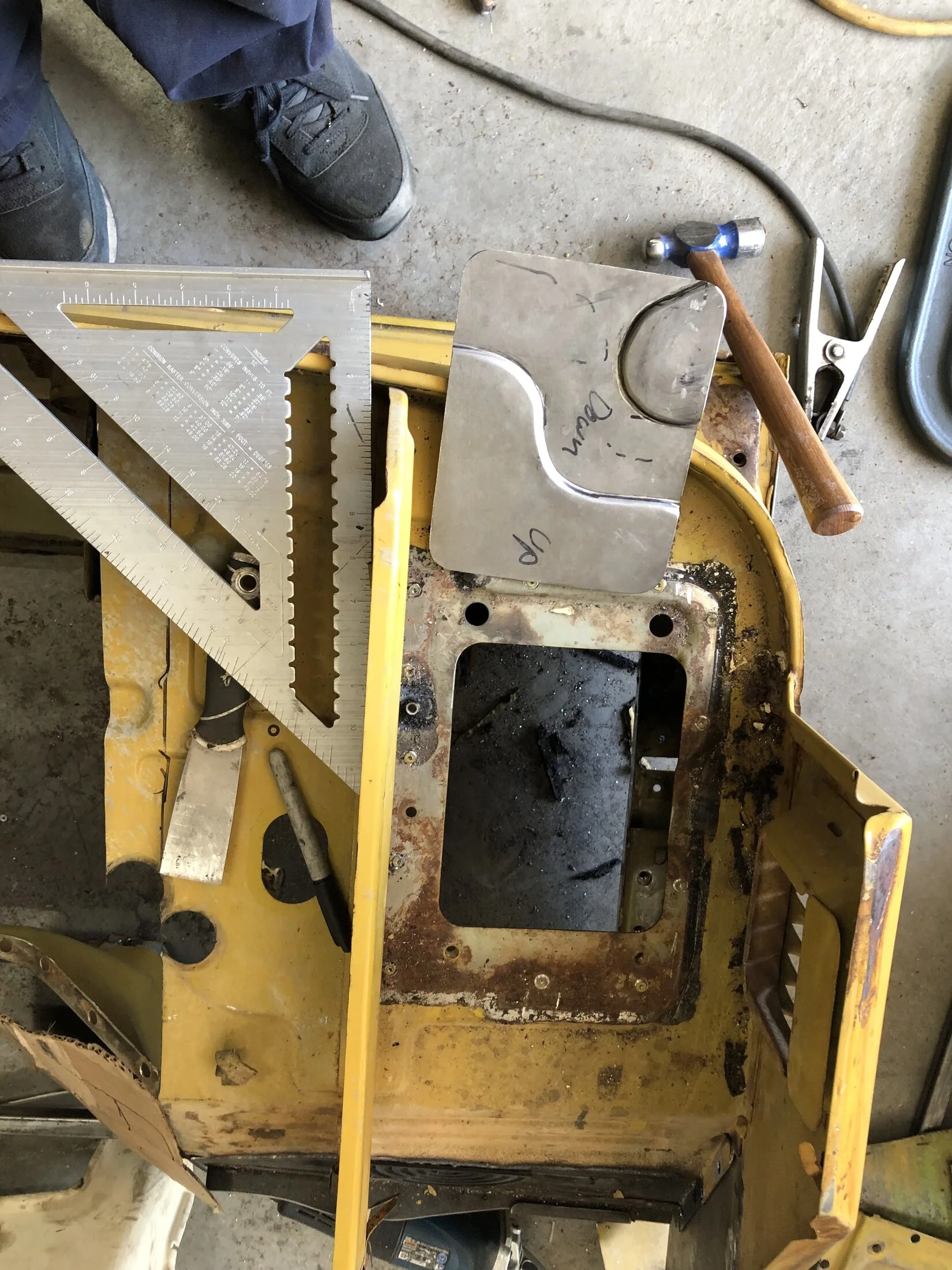

Made a patch panel for the blower panel on the bead roller. Not sure why Toyota had the ribs or what they would look like if they were completed so I made up a pattern that fit the existing ribs.
Patch panel welded in
