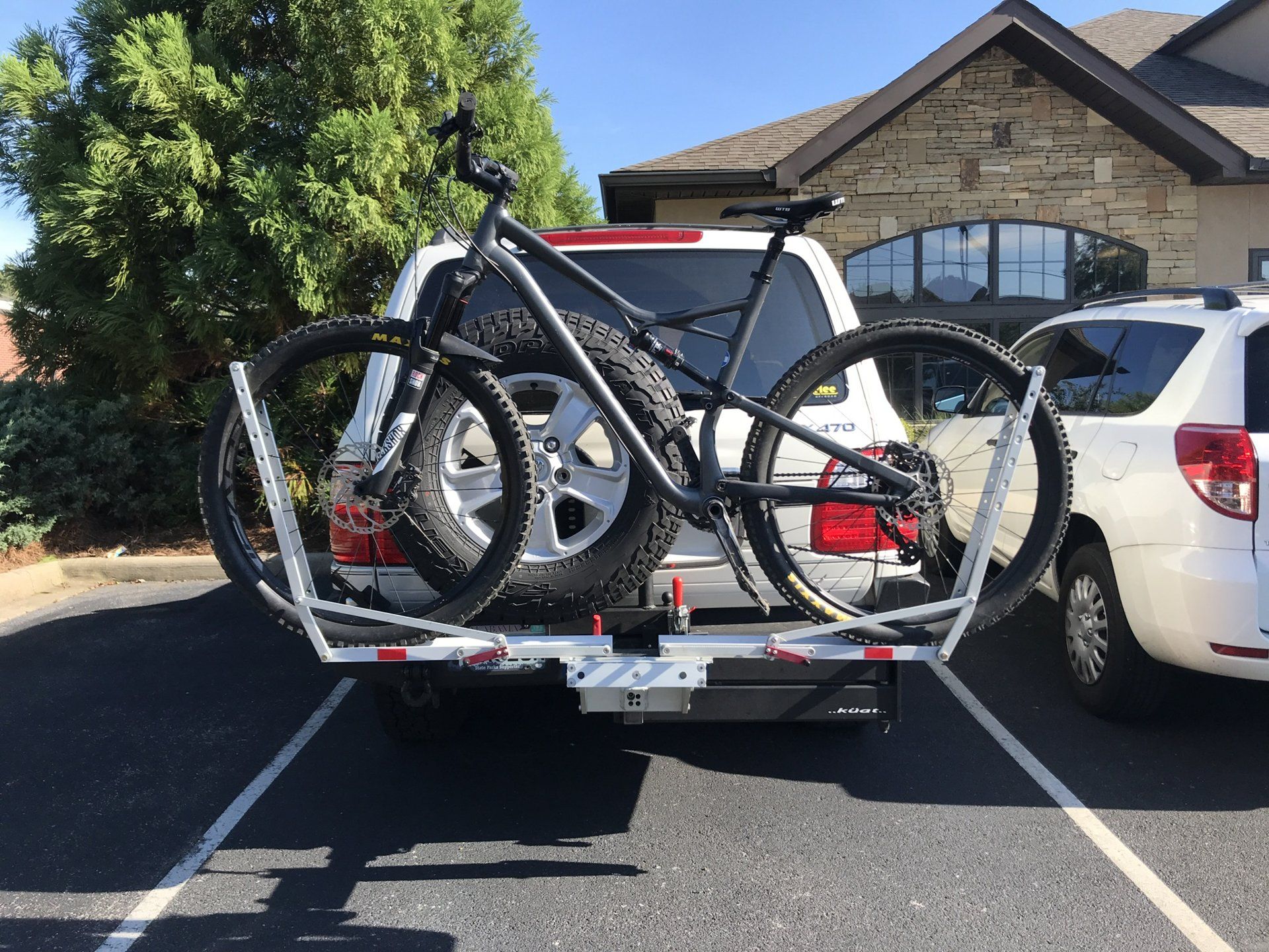

I have a BIOR rear bumper that has the tire swing out on driver side. I did that because my Kuat Pivot swing arm swings to the passenger side. The Kuat is pretty inexpensive for what it is and it works. I have had issues with mine sitting level and seems to get tweaked easily. I would look st the 1Up RackAttach. It does the same thing but comes in multiple sizes and you can pick what side it swings to.
Pics of my setup are below.
