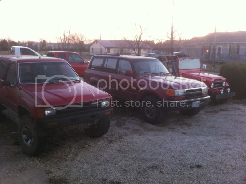

This is what happens when a hilux and a landcruiser mated. just joking guys,newly acquired TOY. 91 4runner with 215k and a 5 speed its fairly straight and interior is clean. she is leaking at the right axle seal and there is a dead miss while running.will find the problem soon i get this in the garage.:cheers::clap:

For your compliments,yes my neighbors don't mind about my cars being rotated around the driveway and the street from time to time.

:D I'm picturing a line-up of 4Runners instead of 60's the next time we're out your way. :popcorn:
