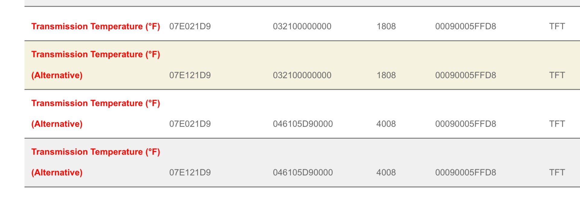

No help here on the issue with 5th gear, but a thought on the transmission temps.
When you programmed your “X-guage” parameters for trans temp, I’m wondering if you used the codes that display temp at the torque converter, rather that at the pan.
TC temps are reliably hotter than pan temps. One way to tell is by noting how quickly the temp rises and falls. TC temps move quickly, depending on load and if the TC is locked or not. Pan temps move much more slowly and through a narrower range.
Below are codes for TfT (Transmission Temp, fahrenheit ) for Gx470’s, from the ScanGauge site.
The top 2 both work…one displays TC, and the other displays pan.
I can’t quite remember, but I *think* the top code is TC.
Maybe if you monitor your pan temps, it will give you more peace of mind, or at least more data.
Good luck and please report back.
Just tried all of those codes and only the top one works. Last 3 don't display anything.
