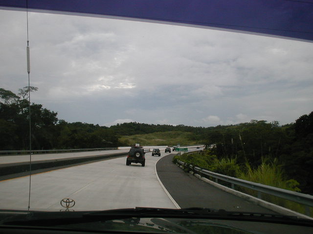

I so proud of all highways on Panamá maybe not with US standards .. but good ones.
This one is a 3rd level way to Darien ( colombian side )
this one is the panamerican
