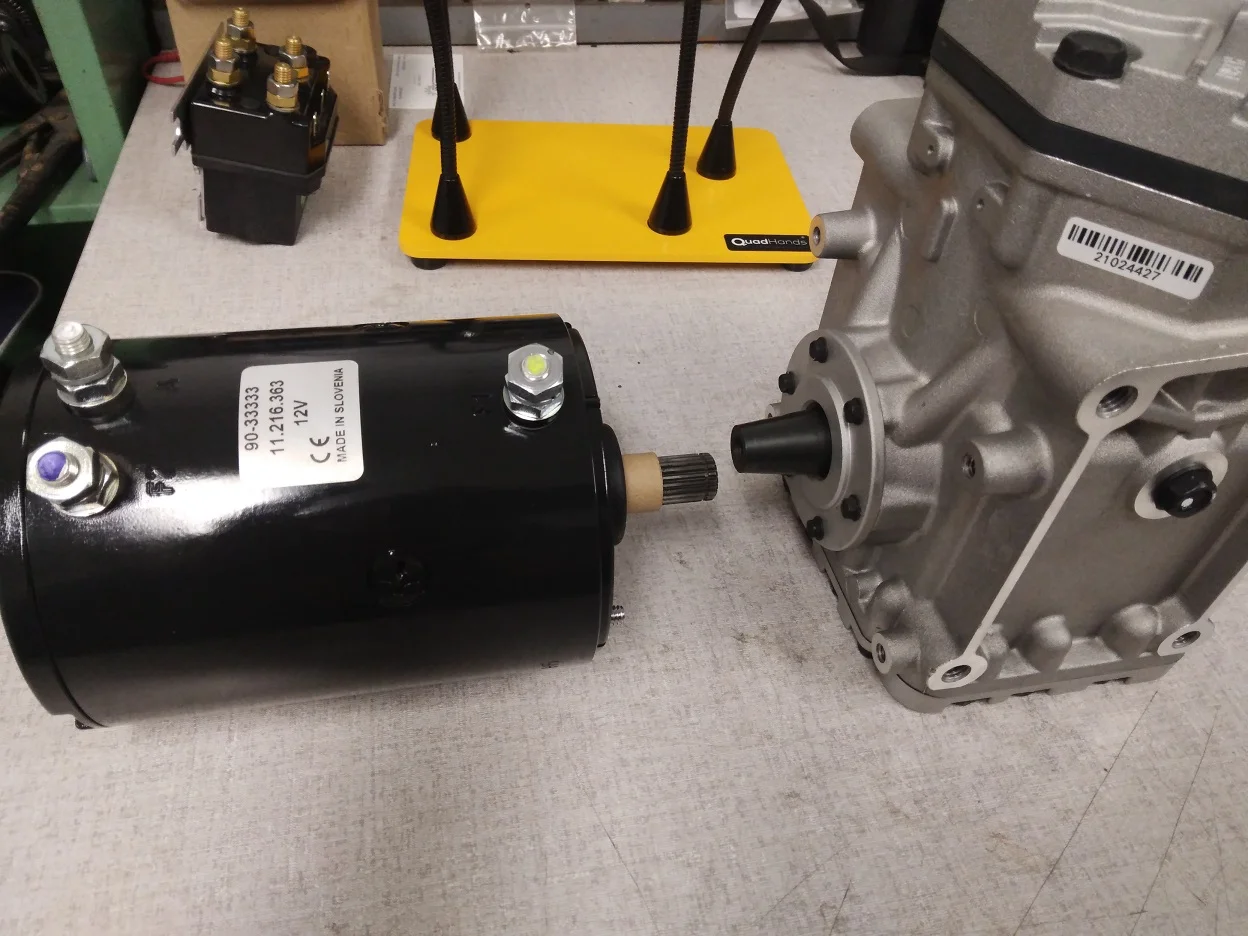

My background in winch testing and manufacturing and selling winch parts like Albrights got me thinking about using a 12V winch motor to run a larger pump. My first thought was make an old school Warn Powerplant- Mount a compressor pump onto a Warn 8274 in a way that the sliding motor pinion would disengage from the winch gears to engage the pump crankshaft. However, mocking it up it didn't look right. Any pump that's small enough to put out much air is way too big to mount onto an 8274.
Even though a York isn't a real air compressor many people use them as such. Seems well proven enough to try it, but with a common 20 spline 12V winch motor driving it instead of a belt. Winch motors rev under low load to about 5000 RPM. Supposedly York compressors can handle that. The bigger Yorks are 9-10 cubic inches/rev
I don't know how a York compressor would load a series wound winch motor, but I'd expect lower pressure to be 4000 RPM+ with RPM dropping as the pressure increases. At low pressure with a 10 cubic inch York spinning 4000 RPM that would be 40,000 cubic inches per minute or 23.1 uncorrected CFM. Pumping isn't 100% efficient. Compressor's usually fall in the 65% to 75% efficiency range. If we call it 65% efficiency that would be 15 CFM at low pressure, like the first 20 PSI of filling a tire.
The max CFM would come down to the HP of the motor used. Most winch motors are advertised as having 4 to 6HP, but these are momentary meltdown ratings and winch real world HP is more like 2 to 2.5 HP for anything more than a few dozen seconds. In testing I've observed winches run continuously under load on dyno stands for hours at loads around 2 HP.
Searching around online I found it stated several times that one real motor HP equates to about 4 CFM airflow @ 100 PSI. That sounds believable to me. So in that case my goal for a motor driven York compressor would be 8 CFM @ 100 PSI.
I didn't find any rating for ARB compressors at 100 PSI. I found one specification sheet listing 4.68 CFM @ 29 PSI for their "big" maximum performance model.
I'm building this for myself and two friends, but if it works well I'd like to sell the winch motor mount and coupling as a DIY kit. Last week I sent out a winch motor and a new 8274 Warn coupling gear to a broach manufacturer for reverse engineering. I'm supposed to have a broach in 2-3 weeks.
I don't have anything to show until the broach shows up, but any build ideas or suggestions? Stuff that could be incorporated into the motor mount design?

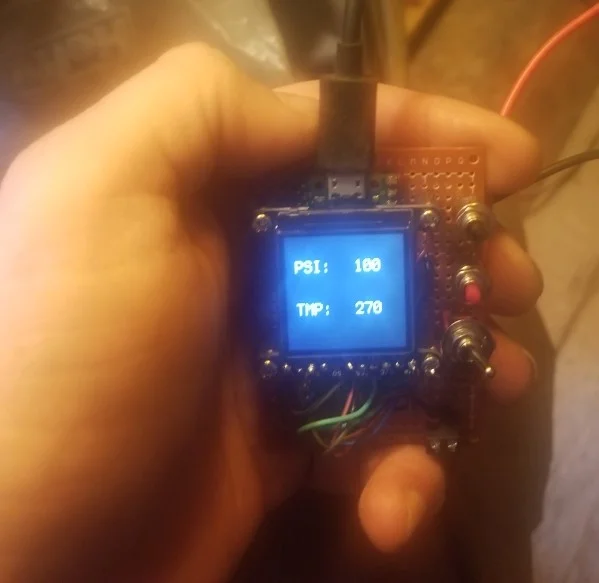

My friend Matt will be using one of these on his rock crawler. He is building a low cost controller for the compressor using a $5 microcontroller. Screen would display pressure, temp and run time (for oil change interval). Programmable cut in/cut out pressures, possibly different modes, like low PSI locker mode vs high PSI air tool mode. It will have high temp shutdown for the motor or pump or both.
Other features that might be useful?
Which compressor temperature would be more relevant- The cylinder head temp or the sump oil temp?
Would a calculated flowrate display be of actual use to anyone? We could install a sensor to pick up crank revolutions. Combine that with pressure data and we could display theoretical compressor CFM.
Would it be possible to program in pressure set points that correspond to the user's desired tire pressure? I.e. have the compressor cut off so as not to overfill tires.

I'm only planning on making the parts to connect the most common style of winch motor, ones with a 20 spline shaft, to any York AC compressor. Many winch motors are sealed up pretty good. Some have gaskets where they seal up to the winch. I don't think the York would care if it got dirty and wet. So if this thing ends up working well enough to turn into a product and you bought it, you get to decide what quality of winch motor to use on your build.

Controller proof of concept. It's just displaying text currently. We're planning to use a small 120V portable compressor to test the functionality later this week.

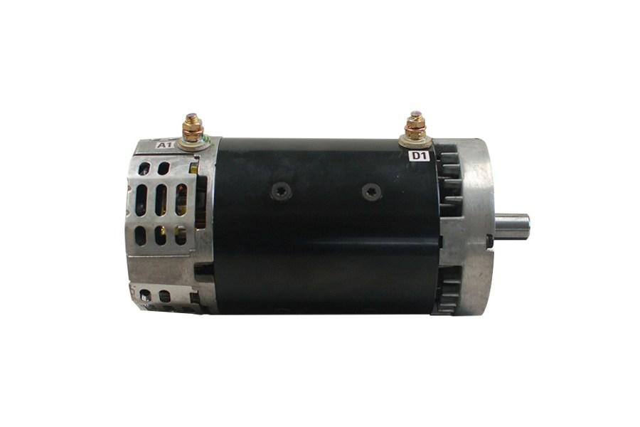

I believe older oasis compressors were just yorks with winch motors. New ones seem to use a motor with a fan on the end plate.

The motors they use appear to be an industrial, continuous duty DC motor, which is probably a large part of the hefty price tag.

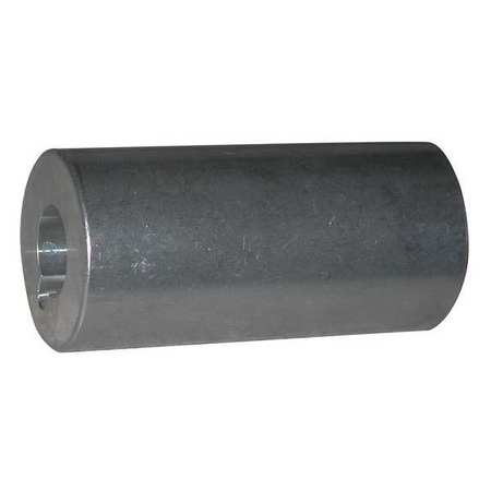

That coupler looks interesting, I wish they provided some specifications for it; I am very curious to know the shaft and key size it is made for, and if it has the York taper on the other end. Looking at specifications for Oasis compressors on Grainger it appears they have a working speed of around 1500rpm, which is quite a bit slower than I would have expected. If that is the case, a winch motor from a Ramsey type winch with a keyed shaft and a 2100rpm free running speed might work just fine, and may even fit that coupler.
I haven't found a picture of the pump.
