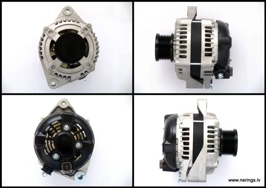

What ever came of this? Did you rebuild or replace the alternator? I'm trying to source an alternator for my 93 kzj78 and its been difficult
The 1KZ TE alternator may work with the 1KZ T Its DXA 519
The OEX "DXA519" is for the 1KZ TE, it may work with the 1KZ T
Perhaps Terrain Tamer makes high output alternators that will work in your application.
Doubt it. KZJXX never went to Oz.
Maybe this 100amp TT alternator from a 1KD FTV in a 150 series would work if you can change the pulley. Some aussie ebayers are advertising a 130amp alternator for this model. The Hiace and Hilux are the same alternator as the Prado
