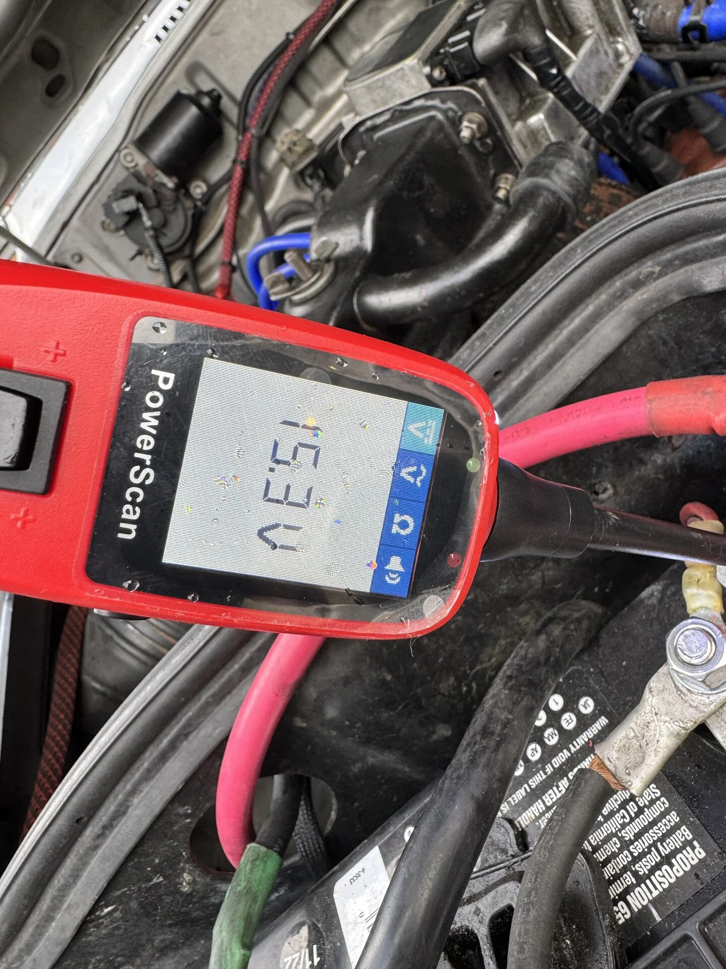

Key off 12v
Key on 15v engine not running on main battery with second battery totally disconnected

That was checking at the battery with a multimeter

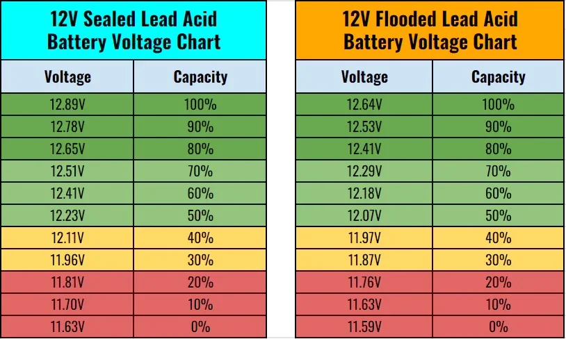

12v is low for a healthy, charged battery at rest.
