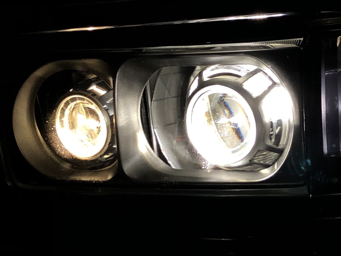

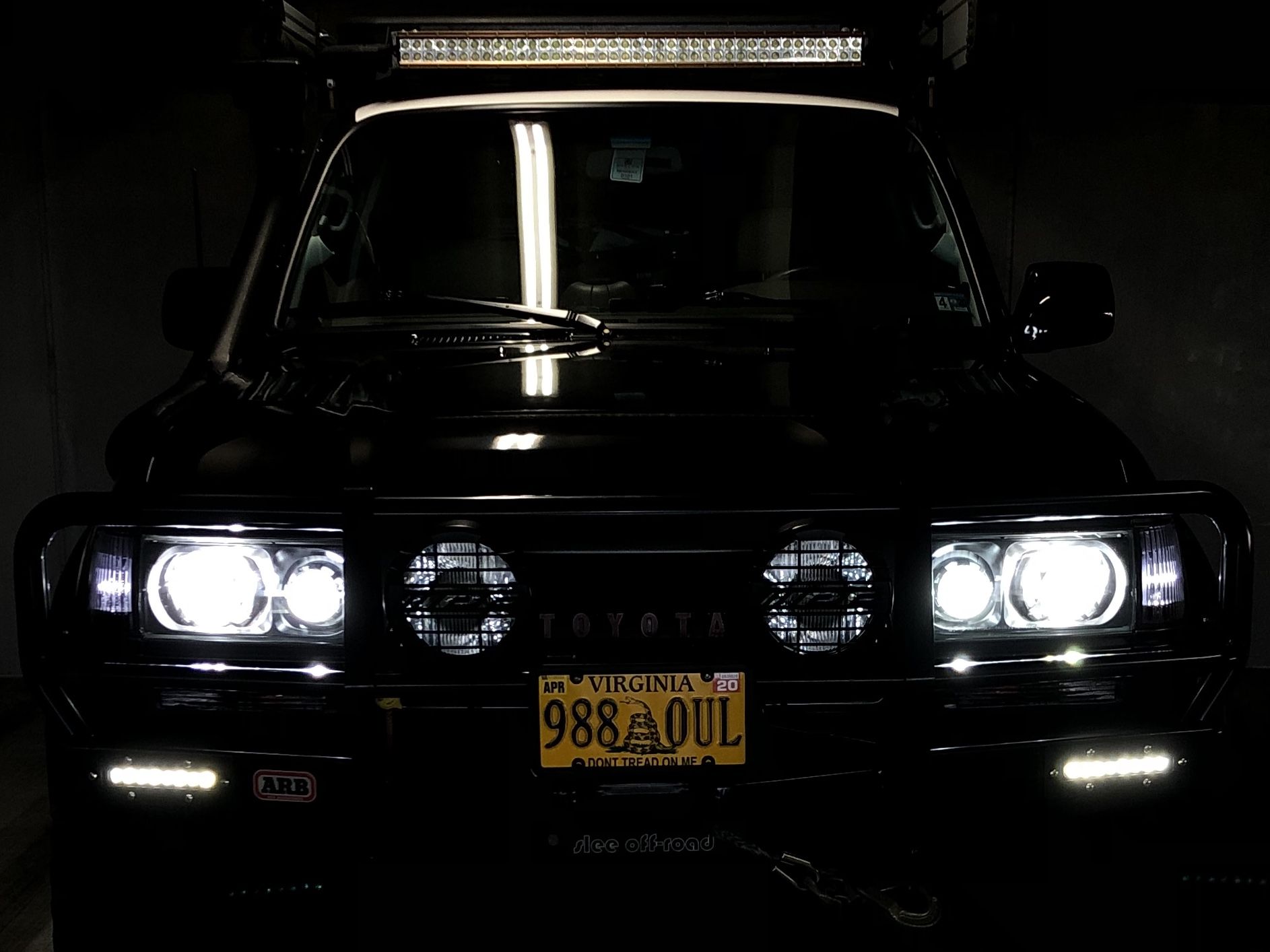

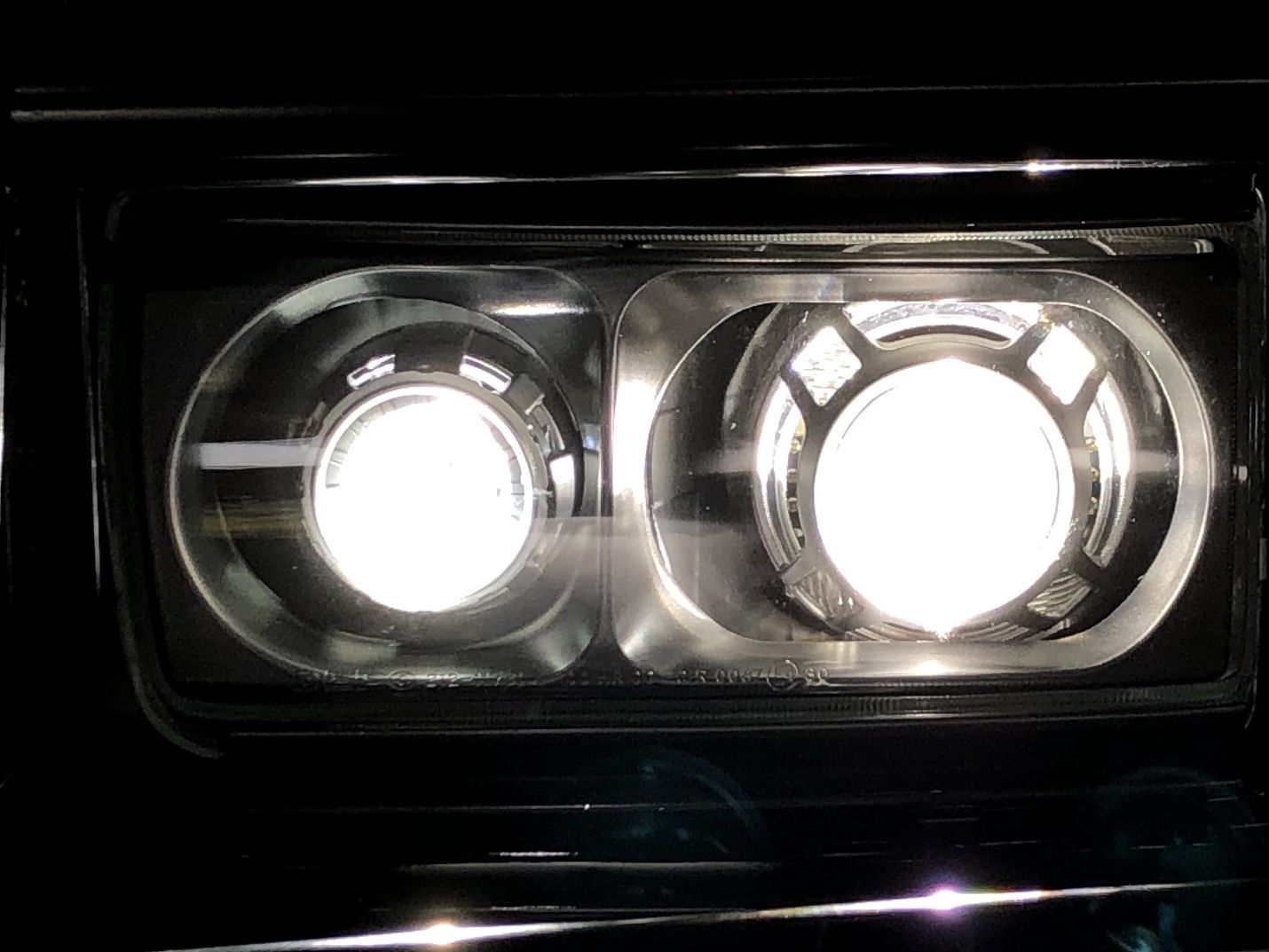

The lights are a quad set I built for my 80. The larger projector is a D2S 5.0 running a 50w ballast and 5800k Morimoto Bulb. The smaller projector is running a 35w ballast. In the first pictures I’m running a 4500k bulb and it did not color match the D2S so I bumped it up to the 6500K bulb and it’s just about the same and pure white
