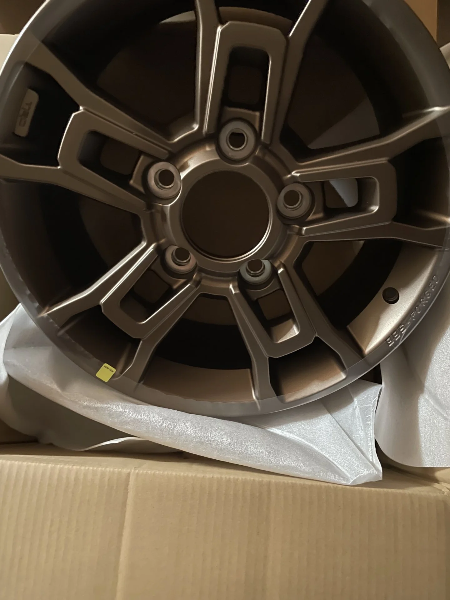

On an other note. If you look at the picture of the back of HE wheel, you will notice the deep dips. I want slightly wider stance without going on the line of fender (avoid chips / corrosion) and this give an opportunity of smaller spacers like 0.75"
I believe the issue is the wheel stud. It isn't long enough to just use a spacer like you might on a sportscar, that slides over the studs. Most of the ones for the LC incorporate their own studs (check out Bora and Spidertrax for examples). Then you have the issue of trying a thinner spacer where the factory studs protrude further than the face of the spacer. If your rims have casting holes in the right places (some Toyota rims do), they might be okay with that. I think the 1" spacers are the thinnest I've seen personally. This is all a non-issue with a 1.25" spacer (I run the Spidertrax).
I did some math on my previous 20LC and seemed that you needed slightly more than an inch spacer for factory studs to be flash with spacer. With HE wheels having such a big dips HE wheels should accommodate studs extending beyond spacer. I need to take a look at my damaged HE wheel how deep are those dips.
I've got 1" Bora spacers that I'll be putting on as soon as I return home from overseas in July. I'll make sure to take some pictures. But based on the pics above of the backside of the HE wheels, shouldn't have any issues clearing the OEM lugs.
