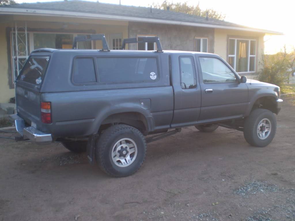

I bought this the other day. I drove it for two days, and then I started having problems with the clutch. It grinds when I try to put it in reverse, as if there were no clutch, but it works when shifting up through the gears. At the same time I noticed the problem with R I also noticed that it became more difficult to shift into 1st.
Thanks for any help.
