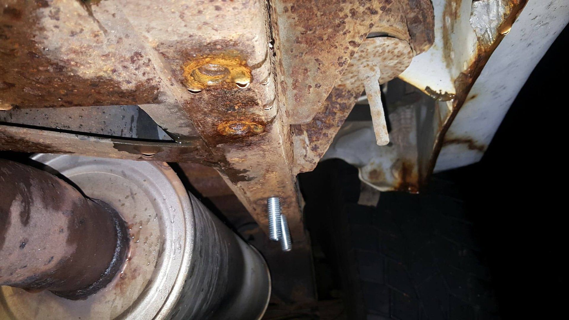

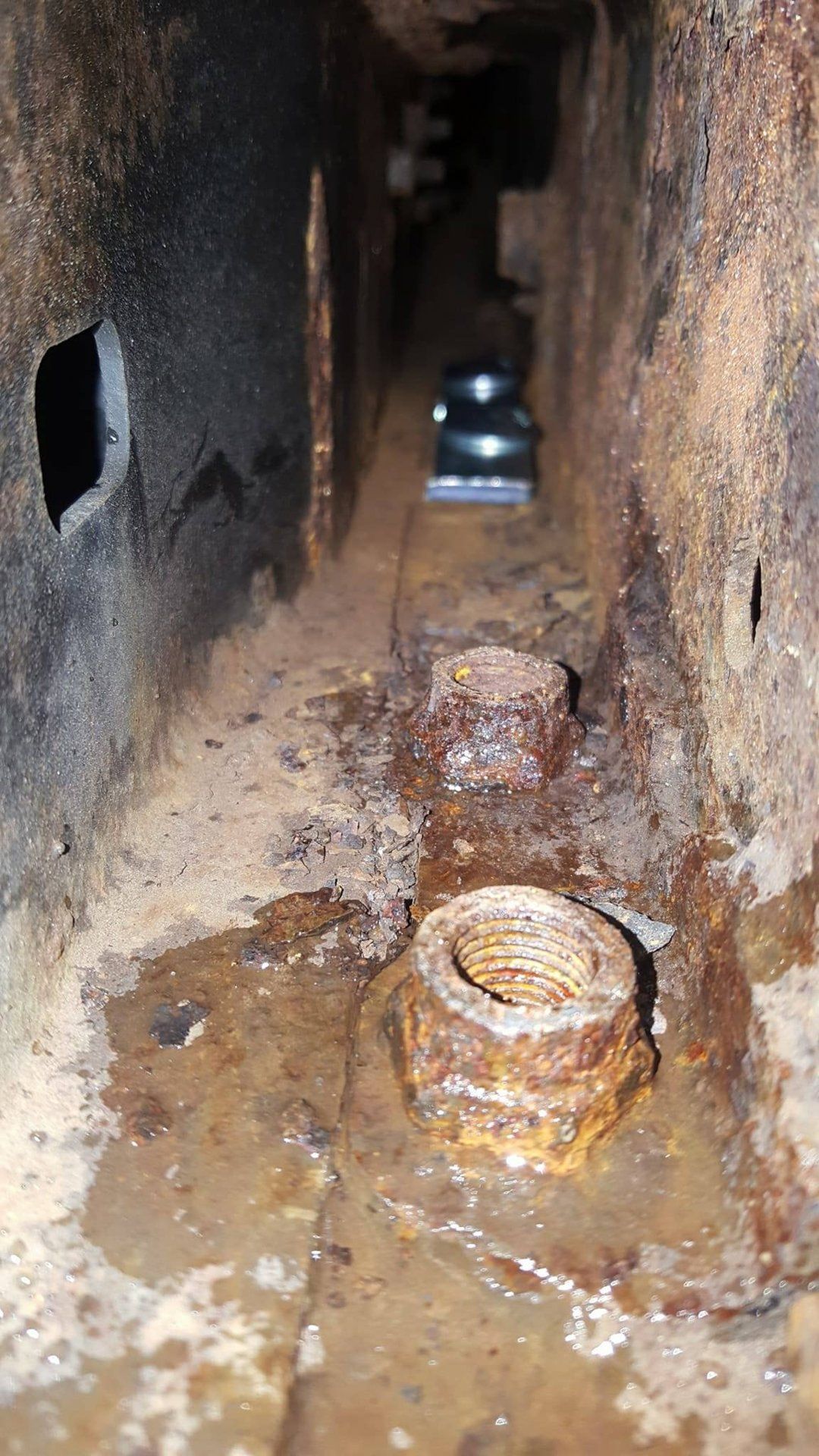

Sorry, no updates. I haven't found any time to work on the project. I tried to install the rear bumpers that day but whoever installed the aftermarket hitch must have tried to remove at some point and spun loose the inner weld nuts. I need to drop off the lx to have new weld nuts installed. Bumpers came in at the worst possible time. We moved into our new house that weekend. I haven't had much time to do anything in between working on the house, work work, and planning for a wedding. Schedule should be clearing up soon. Getting married on the 16th of October. Work slows down fall and winter months. Looking to get some serious work done in the coming months.
Found some time to work on the lx this week. I was not able to have new blind nuts welded in yet. I found a temporary solution though.
Etrailer.com sell these blocks that you can place Inside the frame with a 1/2 carriage bolt.

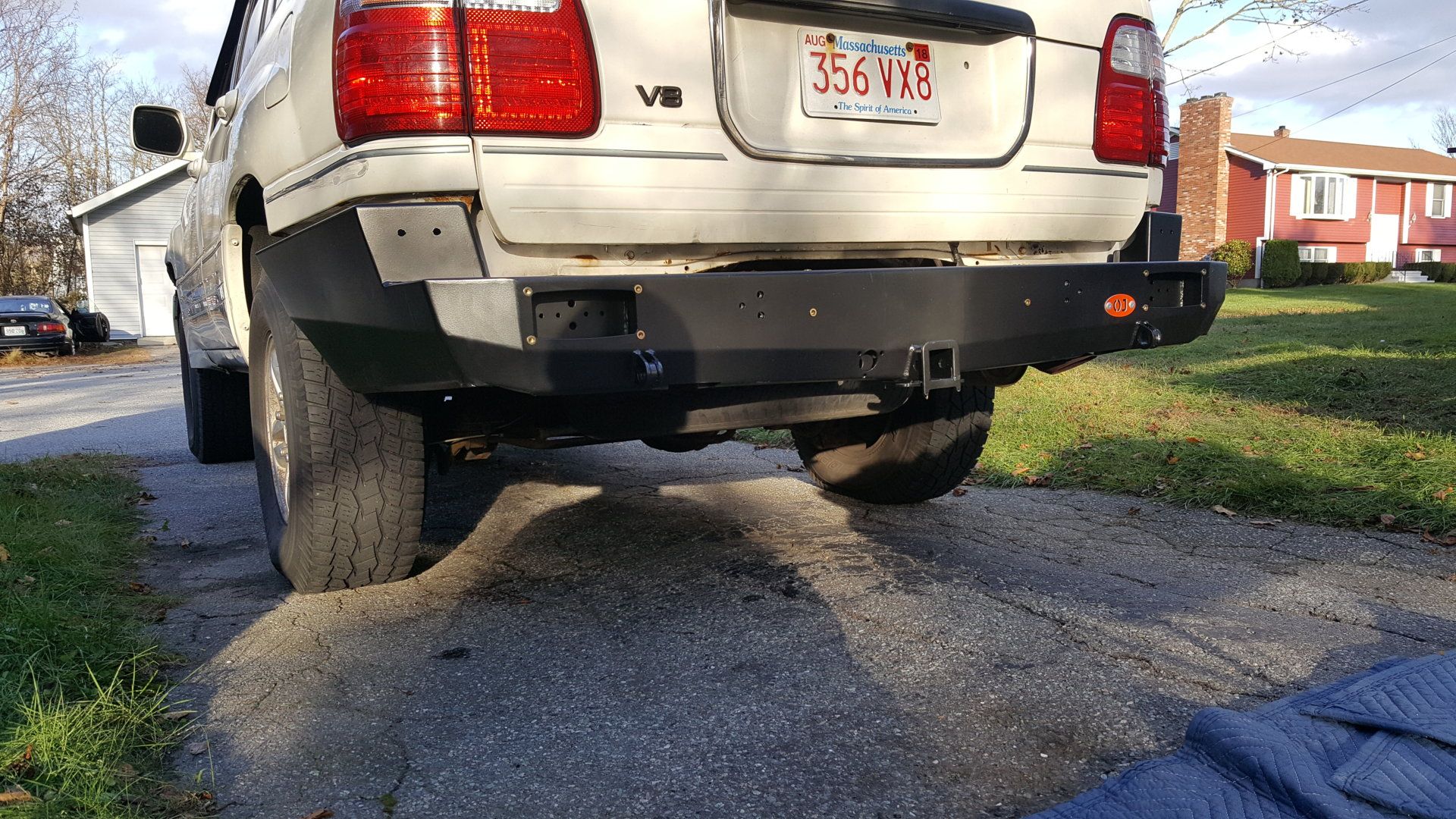

This allowed me to test fit the rear bumper.

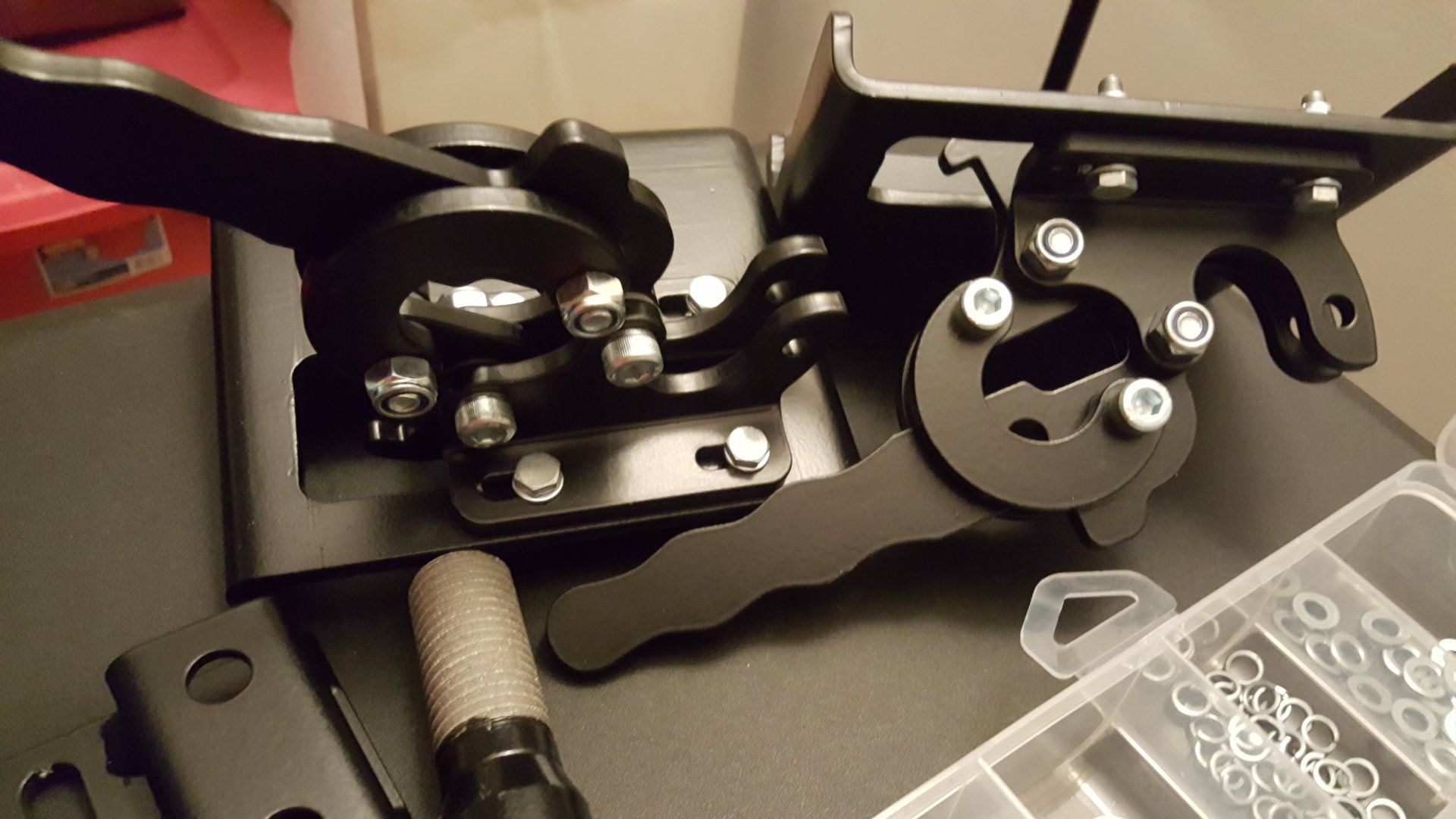

Build quality of the bumper is not bad. It does need some tweaking to fit properly. The bolt holes needed to be enlarged a bit. I wasn't able to install the swing arms today. I did all the prep work this evening. (Assembled the latching mechanism andpressed in bearings) Hopefully I will be able to install them tomorrow .
I was able to mount up almost all the accessories. I was not able to mount a spare. There wasn't enough clearance for the spare tire with the left Jerry can holder mounted. I have to extend the mount for the can a few inches to keep it or remove it all together. Not sure what I want to do yet.
