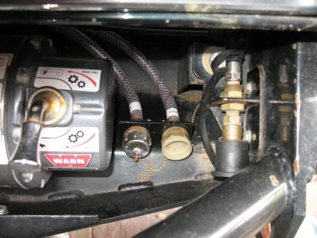

Installed
Quick connects for the shower
Pump and line to the exchanger:
http://a3.sphotos.ak.fbcdn.net/hpho...80424556_110490778987957_434446_4094564_n.jpg
Thats my install. Here is where my plan started from the beginning, just need to add another T, anti scald device, and valve to the system for it to match the schematic, which is terrible I know.

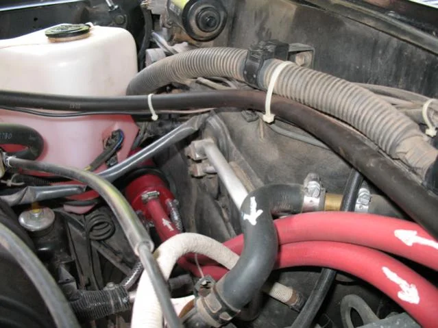

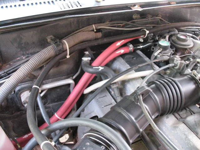

I bought the same heat exchanger from Kurt last summer after I got to use a buddy's shower on a trip to Utah. I used a different mounting location and I spliced mine into the vehicle heater circuit so I can control the temperature using the in-cab control. Works great! Here's some photos:
I like your install way better. Very clean, very tidy.

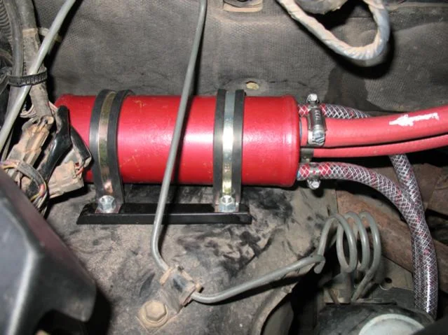

Thanks! I probably spent more time trying to find the best location for the heat exchanger then I spent actually installing it. I must have tried every possible place under the hood before I settled on that final location. Here's a close-up of the exchanger mounting (I got the clamps from Kurt with the unit):
Nice location. Looks like I'll relocate when I have the engine bay pulled apart. Thanks for the great images.

Nice setups - very tempting. Do you have any closeups of where you "tapped" into the stock coolant lines? Can I assume it was one of the heater hoses running on the back of the fire wall? And did you just install a tee on the circuit to move the water through the exchanger?

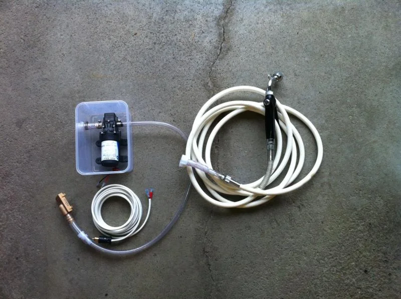

I made a pump kit from West Marine components. The pump has pressure switch. I tested it in the sink and it worked exactly as I wanted. I went with the 1.1 GPM pump to see if it will be enough. And it was.
So I have a cold shower solution. But no real Landcruiser owner can stop here. Oh No. It has to be hot shower, even if I don't know if I ever going to use it.
