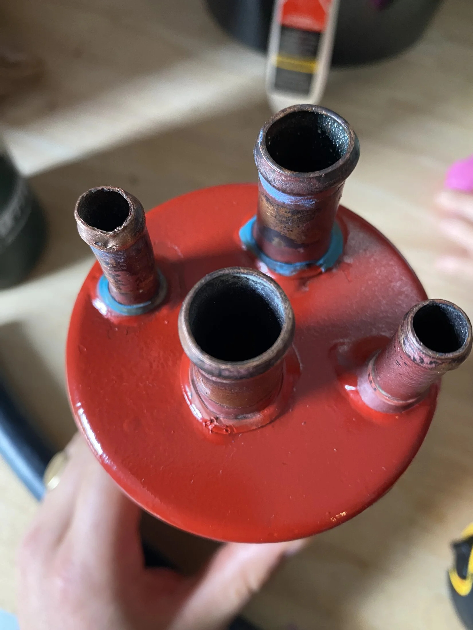

Reviving a very old thread here. I came across one of these used and am excited to do the installation. One question I had for @cruiseroutfit or anyone else that may remember- there are four ports on the heater- two -5/8" and two-3/4". One of the 3/4" is painted blue and one is painted red. Pretty obvious there that blue is input and red is output. But what about the 5/8"? Is blue output (because the heat has been sumped to the water)? Or is blue the input port, in keeping with the 3/4" trend? OR does it even matter because it's just a U-shaped pipe going through the water coil?
Most ideal is if the hot coolant flow direction is opposite that of the water flow direction. It will work better this way. Maybe not by a lot, but it will be better.
