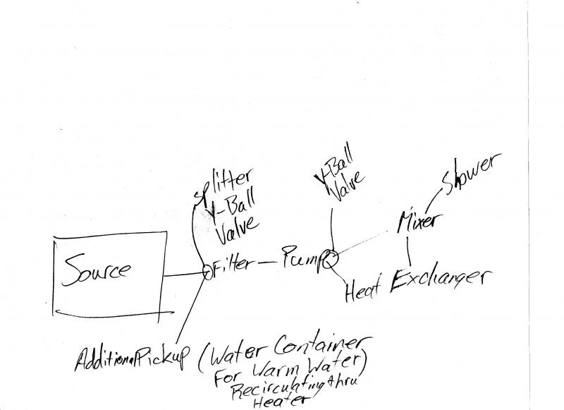

Sorry for the terrible sketch, but here is my future permanent install diagram. This will be going to a valve.
Jeremy

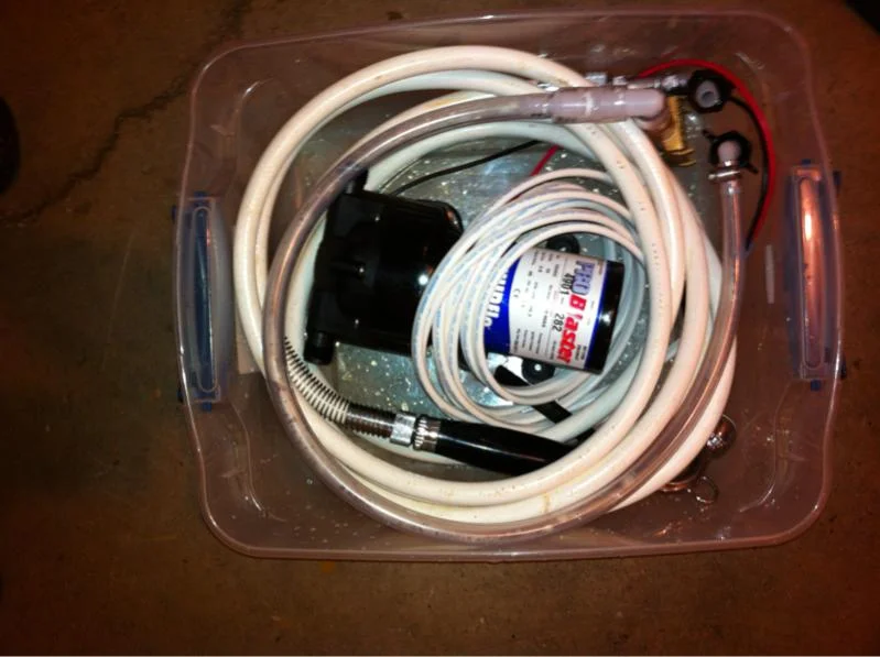

This pump worked great. Here is the new "kit"
I have the 3/8" connectors and I suspect the 3/8" somewhat restrict it. It looks like it was designed more for 1/2"
But the flow out of the shower head was great.
