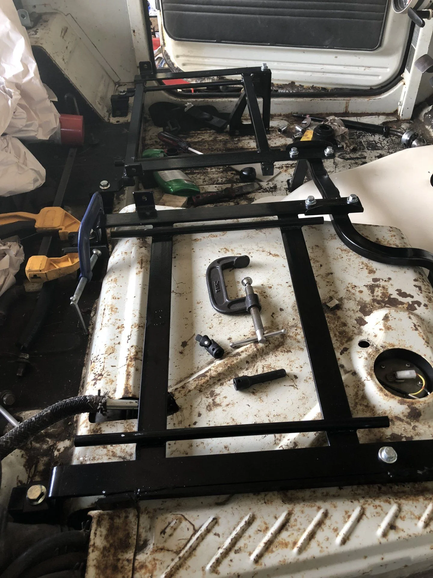

The ProCar brackets are pretty basic, really. They're essentially flat-bar and square tube stock welded into a frame with holes drilled to align (and not very well) with the stock seat mounts, with thick L-brackets for the seat belts to mount to. I had to use clamps to flex mine into position.

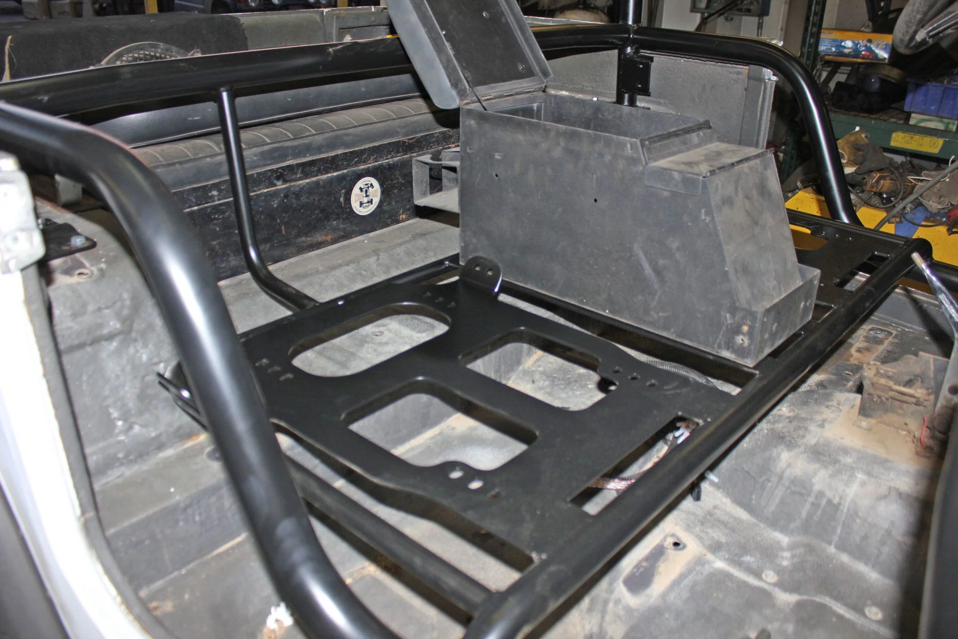

A word of warning here - if you intend to run a center console (Tuffy, Cruiser Crap, CCOT, etc.) you will need to grind off the L brackets for the seatbelt receivers on the inside of the frame, and relocate them for the console to fit. Otherwise, they interfere.
Yours will probably be a bit different if they moved the gas tank under the cab or changed the mounts by 1979, but the principal should remain the same.
The seats themselves mount horizontally into tubes welded to the main frame. It's essentially a steel tube threaded for M8x1.25 bolts. If you can weld, and have some taps and dyes, you could build them.
