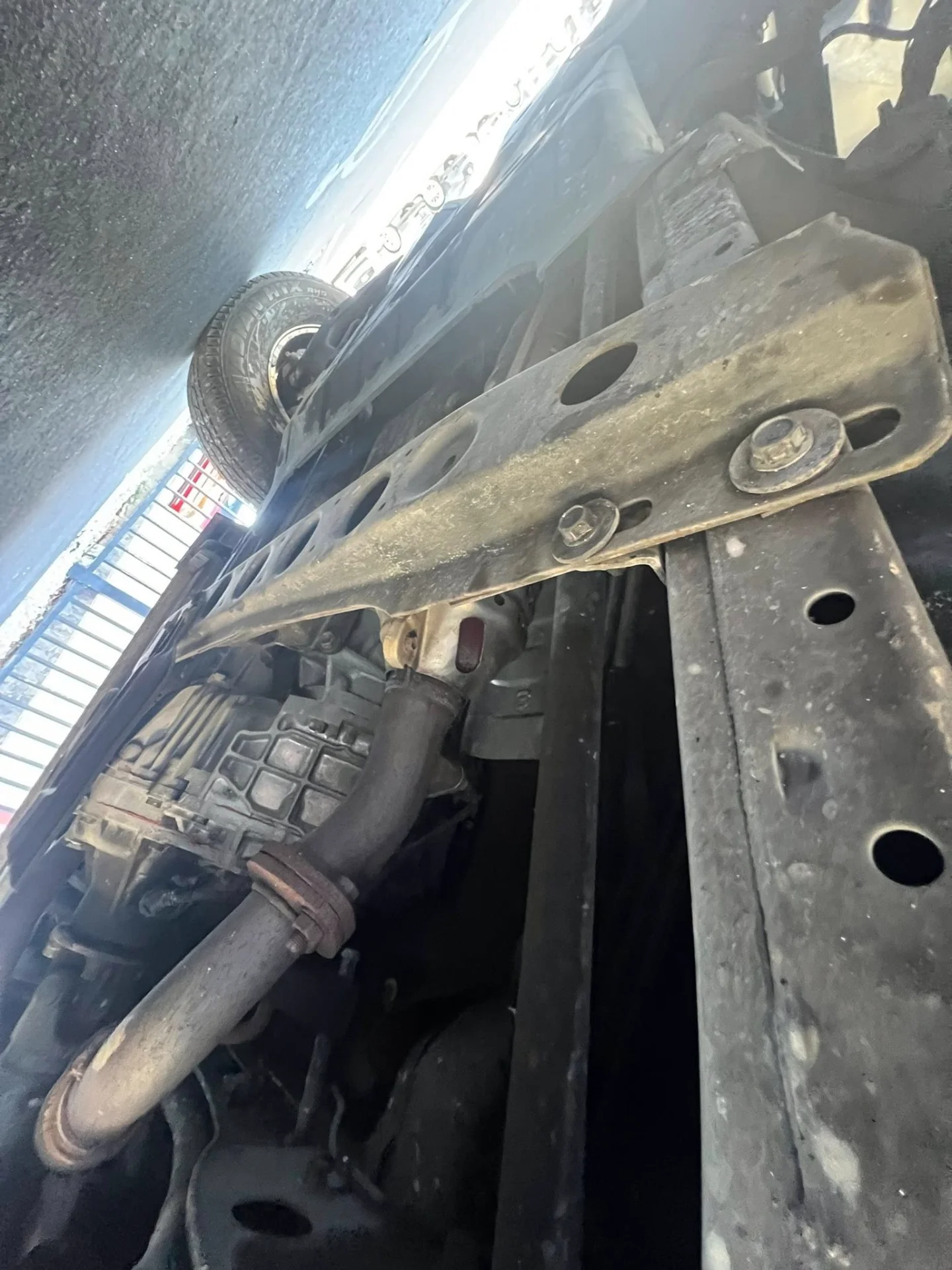

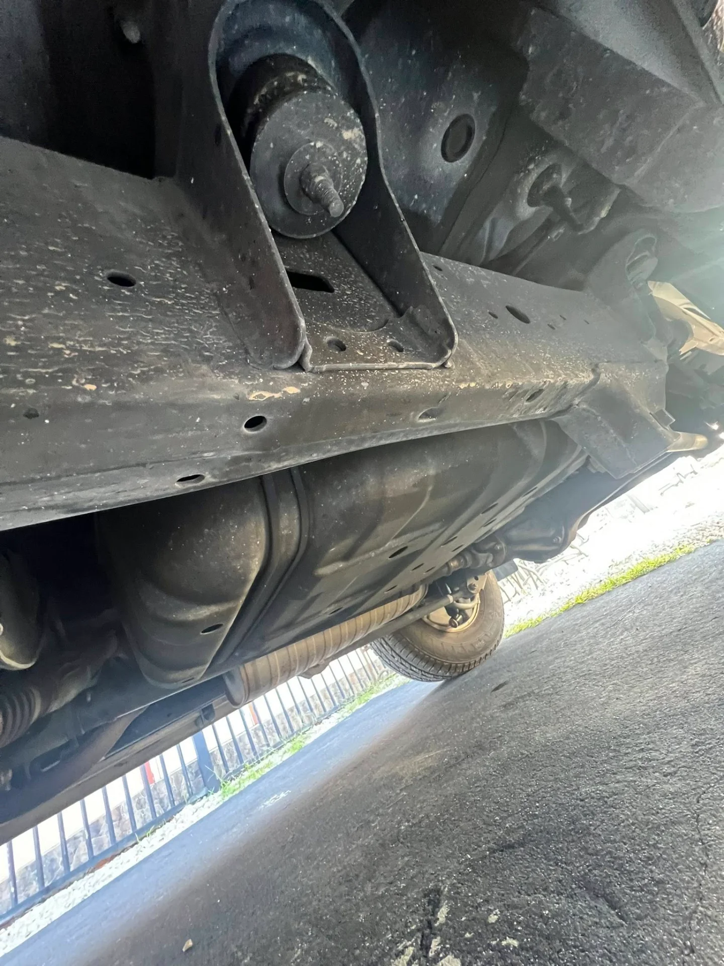

I am currently looking at this LC100 for sale, record is impeccable. every 5,000 miles by the dealer it was bought from. 1 owner through out it's 26yrs, 230,000 miles, bone stock.
They are asking $15,800, is this worth it or is it a bit high?
i plan to go to the dealership where it had all it's services done and ask about the timing belt and water pump. what else do i need to ask the dealer?

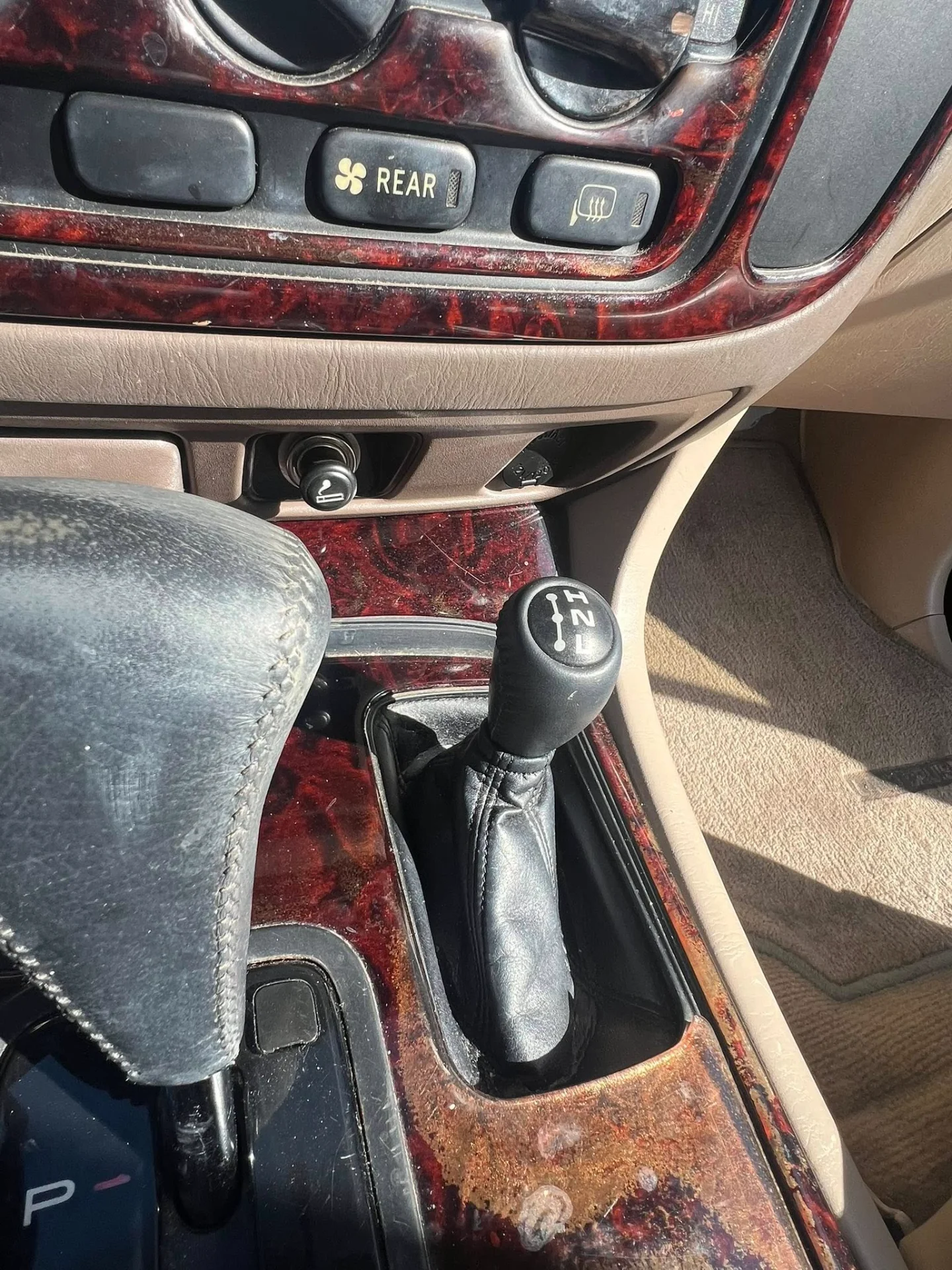

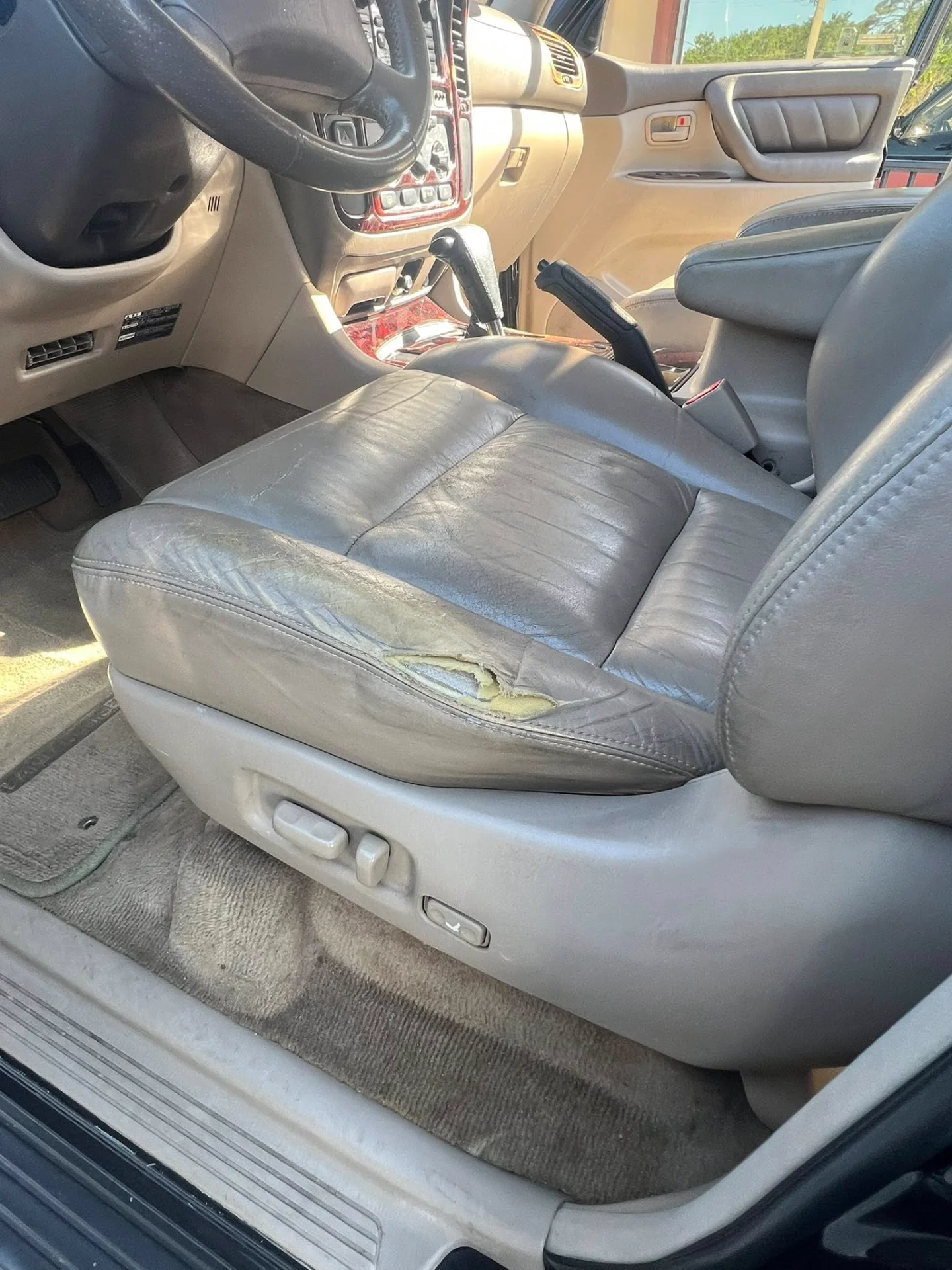

The interior looks a little rough. For that price I think I'd expect the inside to be a little nicer.

I wouldn't call this particularly "clean" other than perhaps the underside being relatively free of rust. The interior is kind of rough and we haven't seen the paint. Engine bay shows screw clamps (instead of OE clips) on the power steering hoses and the radiator hoses. Hmmm. As others have pointed out the radiator is toast. What does it mean that "records are impeccable"? That it has had regular oil changes, tire rotations and brake pads? All that (and more) should be a given. What you are really looking for in the records is how many of the known-issues and big-ticket items have been addressed? A short list of things to look for in the records, the more of these that have been done, the better:
transmission (it's a 2000)
timing belt/water pump AND associated items such as fan bracket
brake boost/master cylinder
steering rack
CV axles
control arms
radiator (well, we know about that)
coil packs/plugs
starter
alternator
recent brakes
recent tires
Heater tees are a minor item but important, seeing them in the records would be indicative of good maintenance. Also are fluid changes up to date? Diffs, TC, trans, PS. Also it is at the age and miles that many of us are replacing rubber- mounts, bushings, hoses. Any of that been done?
As far as what it is worth, prices are all over the place. Colors, paint condition, location, rust situation are all pretty important. As well as the maintenance. Good luck.

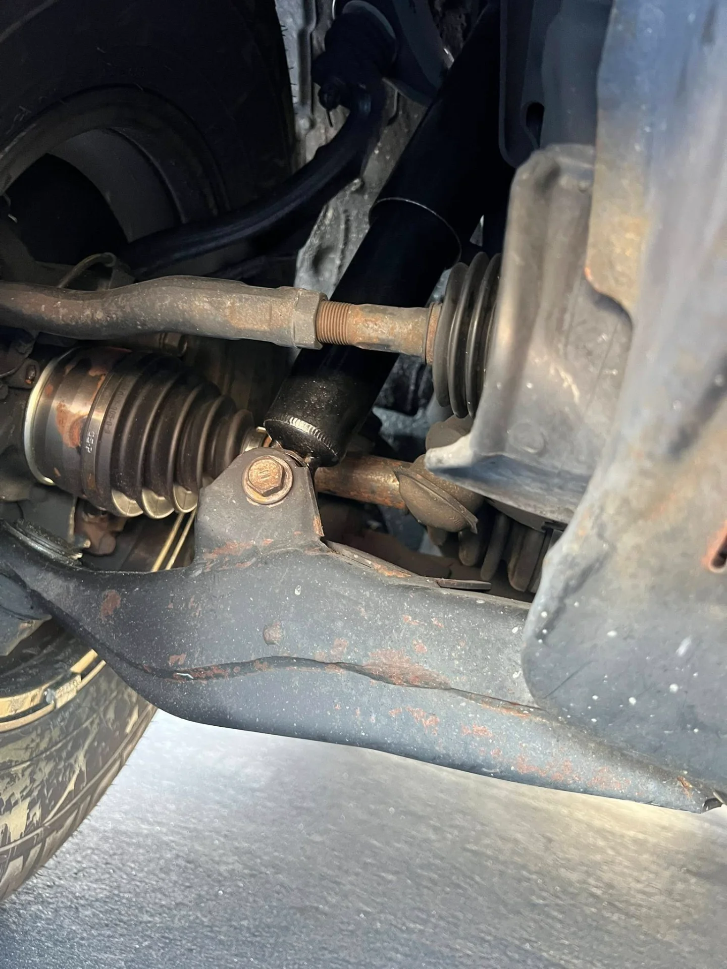

Maintenance is one thing but quality of parts is everything. Aftermarket parts do not last as long as the OEM. From the looks of the “new” CV axle it is aftermarket and they tend to fail much faster than an OEM.
