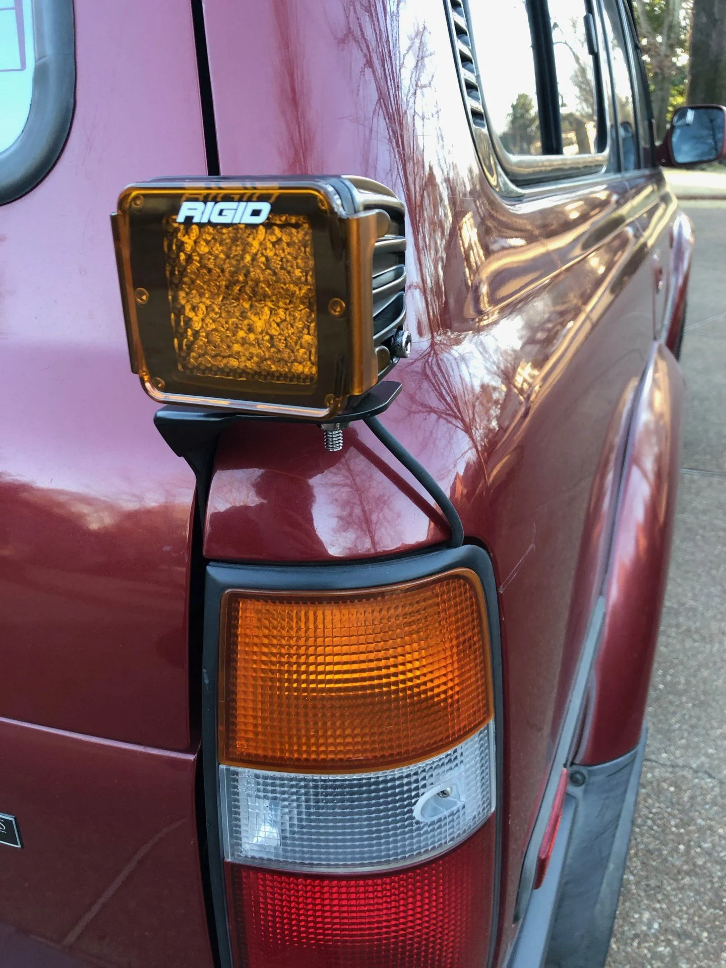

Hey guys, I did some digging trying to find the best way to wire my new Rigid D Series lights, but I've found nothing. I'm running the Yotateq rear antenna/light mounts, and I'm curious as to what you guys would recommend for running the wires. I've got them as of right now running through the tail lights and into the space behind the trim in the cargo area; however, i'm not sure if this will allow water in through the gasket. Does anyone have any tips or a better way to wire them?
Thanks,
Harrison.

Yea, I think that is going to leak. Maybe search for how people ran CB wires with that mount. Mine is drilled through the body behind a ball mount.
The compartment behind the tail lights is actually designed to shed water so long as the wiring boot is present and in good condition. But unless you can run the wire through the boot, you'll have to create a penetration in that area that will require gasketing (grommet/FIPG/or both) to maintain the moisture barrier. Otherwise, it'd be a bit easier just to run it the other way, through the hatch opening.

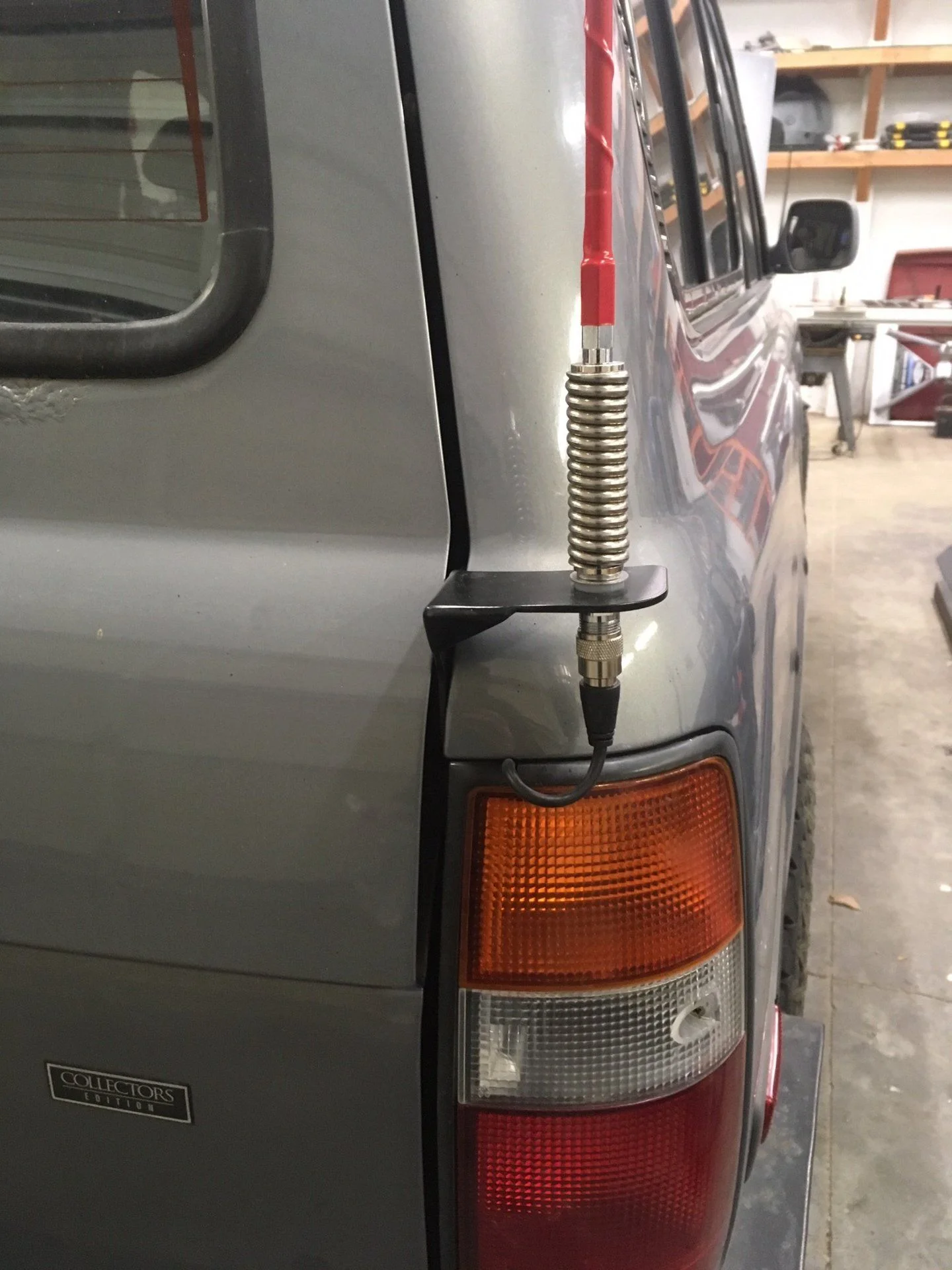

I just did my CB cable through the light like that. I ran the wire through the boot along with the lamp wiring, it was pretty easy to do. Been raining a lot here lately and no leaks. Only thing I did different is I left a little slack in the wire where it comes out of the light and looped it down a bit so any water running down the wire would drip off vs going into the lamp area.

To get back to the tech of this thread, I run a rear facing LED through the lens and I dont have water intake issues. I think 80s have drain holes like 60 series in the bottom of the quarter panel that can be cleaned out with a ziptie in case of water pooling.
