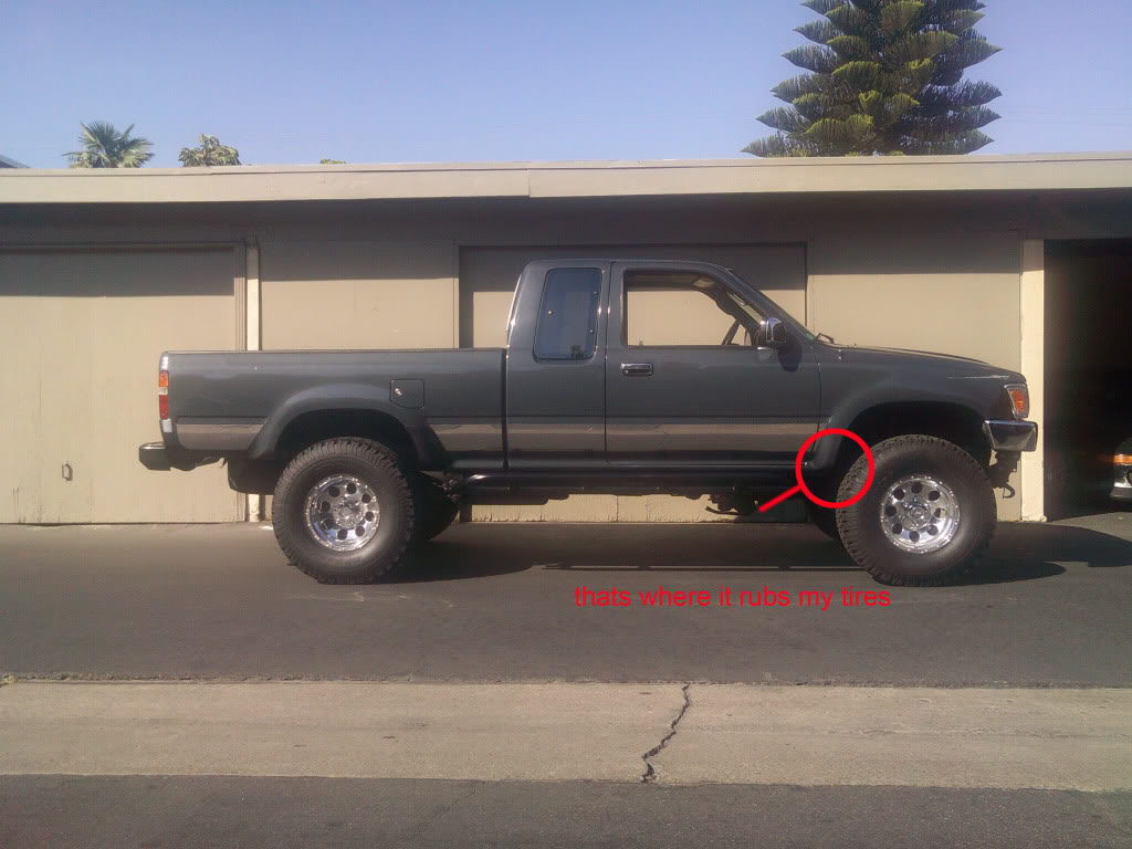

yes i know that, coz u guys teach me :D, but like i told u guys, i got no choice , my 33'' tires is RUBBING:confused::confused::confused::confused::confused::confused::confused:, i check this suspension lift kit on EBAY, ROUGH COUNTRY only $609, 4 to 5'' lift, do u guys think thats good????? i see some lift kit like, TUFF COUNTRY, SKYJAKER, PRO COMP, FAB TECH, so :confused::confused::confused::confused::confused::confused::confused::confused::confused::confused::confused::confused: which 1 guys??????????? i need your help guys, tnx

Now that I've seen the pic I have the solution..... Go buy a different truck, you don't want to wheel that nice thing!!!!!!! You'll ruin it!! :D
If they are rubbing the seam, just take the tire off and pound it flat with a 5 lb sledge.
I am planning to use my truck for a little bit of mud, and little bit of off-roading. im not looking for HARDCORE off roading!
The other problem is we do not recommend a lift of that much unless you're going to huge tires, then we'd tell you that you don't want tires bigger than 35 on the IFS for reliable operation, so it's a no win situation....... You're asking us which wrong way is the best....
You want to play in the mud and do some light off-roading... get a rear locker, and go back to 31 inch tires! None of us want to tell you what lift to get cause it's not the right thing to do.
You came here and asked us cause we know what we're talking about, but you aren't listening to the voice of experience.
