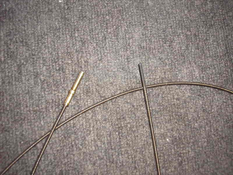

Here's a pic of the cable I pulled out. It's got the brass thing on the T-case end and a squared off end on the speedo end. Am I missing something???
So it's not supposed to have a brass thingamjig on both ends? Cool. I'll wipe it, lube it, and slap it back in there and see what happens.
