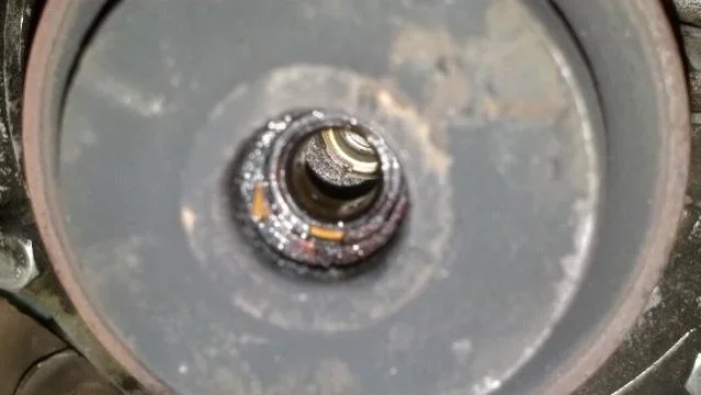

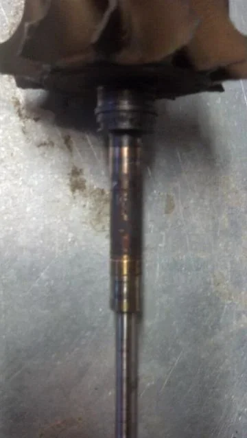

Interesting, when I pulled mine apart I was sure it was BB. I'll post up some pics in a few.
Well I'll be damned. I thought it was BB, but thinking this is journaled.

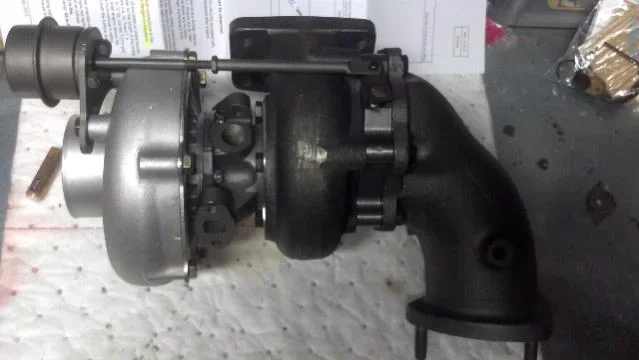

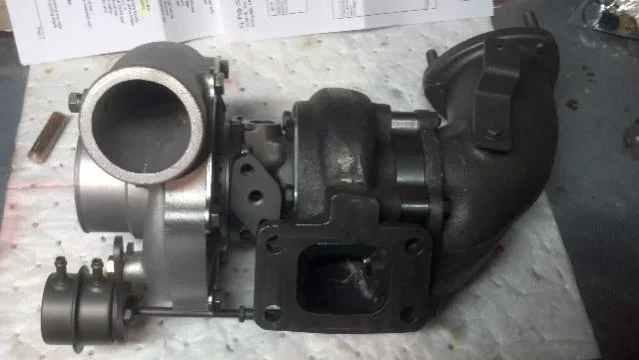

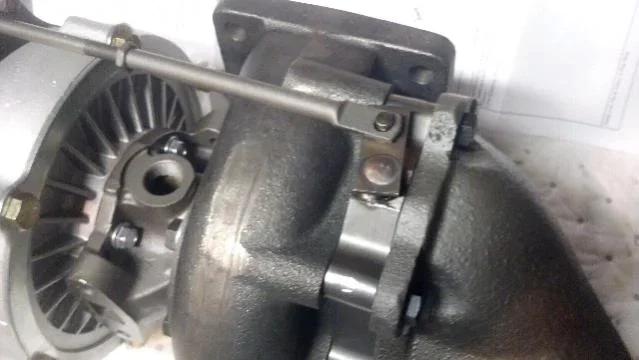

Well I gotten lucky in the sense that I've come up with a solution to all of this.
First off, before I pulled the trigger on this I had a leak down and compression test done on the engine. It was sitting cold for a few weeks so the compression test was a bit sketchy, but the leak down showed comfortably in the green for all cylinders. :D
I have to thank the guys over at G-Pop Shop the most as they were the only ones out of 10 major turbo shops I contacted that would even tackle this. With their help we came up with the following
- New turbine wheel $165 (from them)
- New Ford 5 bolt .82 housing $275 (from them, and it has provisions for an add-on Waste Gate swing valve.) They don't have a link on their site but this is what it looks like: 5 Bolt .82 Housing
- 5 Bolt waste gate swing valve $95 FROM HERE
- While they have it I opted for a complete rebuild, probably not entirely necessary but its out so might as well do it. Service runs $450 for their "performance" rebuild that includes higher grade journals and oil seals and return shipping. (Standard rebuild is $350.)
The nice parts of this combo is that the dimensions and bolt patterns are almost an exact match to the safari. The most that might have to be done a minor tweak to my new down pipe or add a flex portion.
So just about $1k for an essentially 'new' beefed up unit that matches the Safari specs almost perfectly. This is almost $1k less than I would've been looking at doing a GT35R swap out. Add the $400 to get my manifold welded up, another $50 for new studs / gaskets, and I'd say it could've been worse. :cheers:

Looks good, especially in terms of fitting back into the existing Safari stuff.

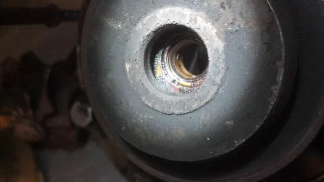

No flippen way... Reading this got me a little concerned about my Safari Turbo setup, so I pulled the heat shields, and sure enough, the turbo flange/housing is cracked very similar, maybe not quite as bad. The exhaust manifold seems to be ok from what I can see, won't know for sure until the turbo is pulled. So the turbo has been working fine, and obviously it's going to have to be rebuilt or replaced, so is it a big deal to drive her lightly until I can pull it? What am I risking besides further turbo damage? Great thread by the way, you have done A LOT of research on this.
