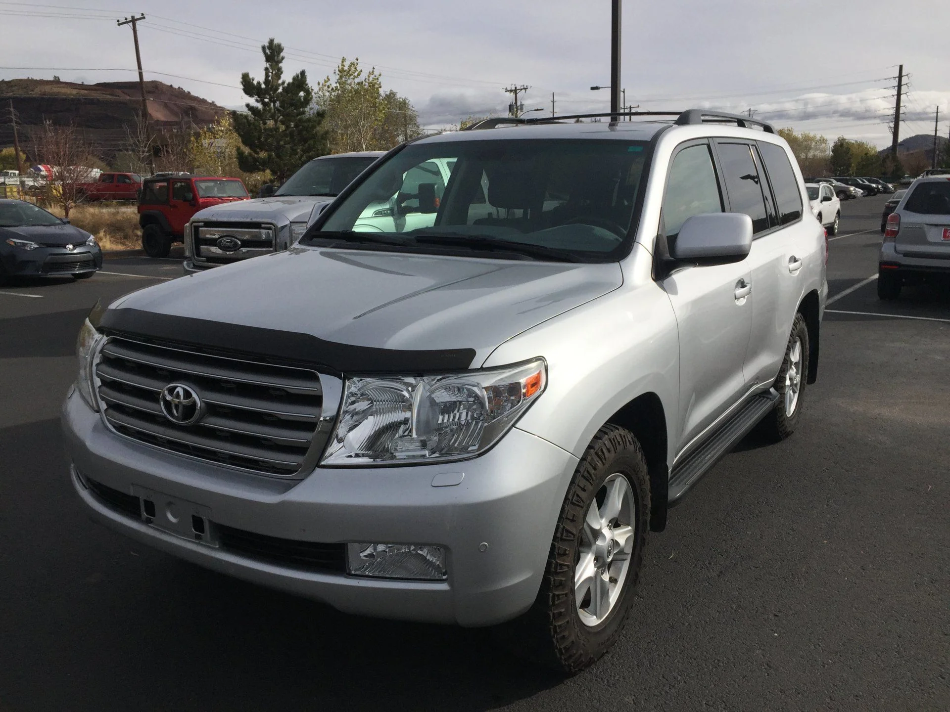

Wow, what a sad saga. Too bad to lose a cruiser but good to not have to deal with it anymore. Good info to have on Mud; lots of buyers will now be checking for windshield replacement and water damage!
I will look into buy back price from insurance. The rig was in amazing shape. Also it now has many...many new electrical parts.
