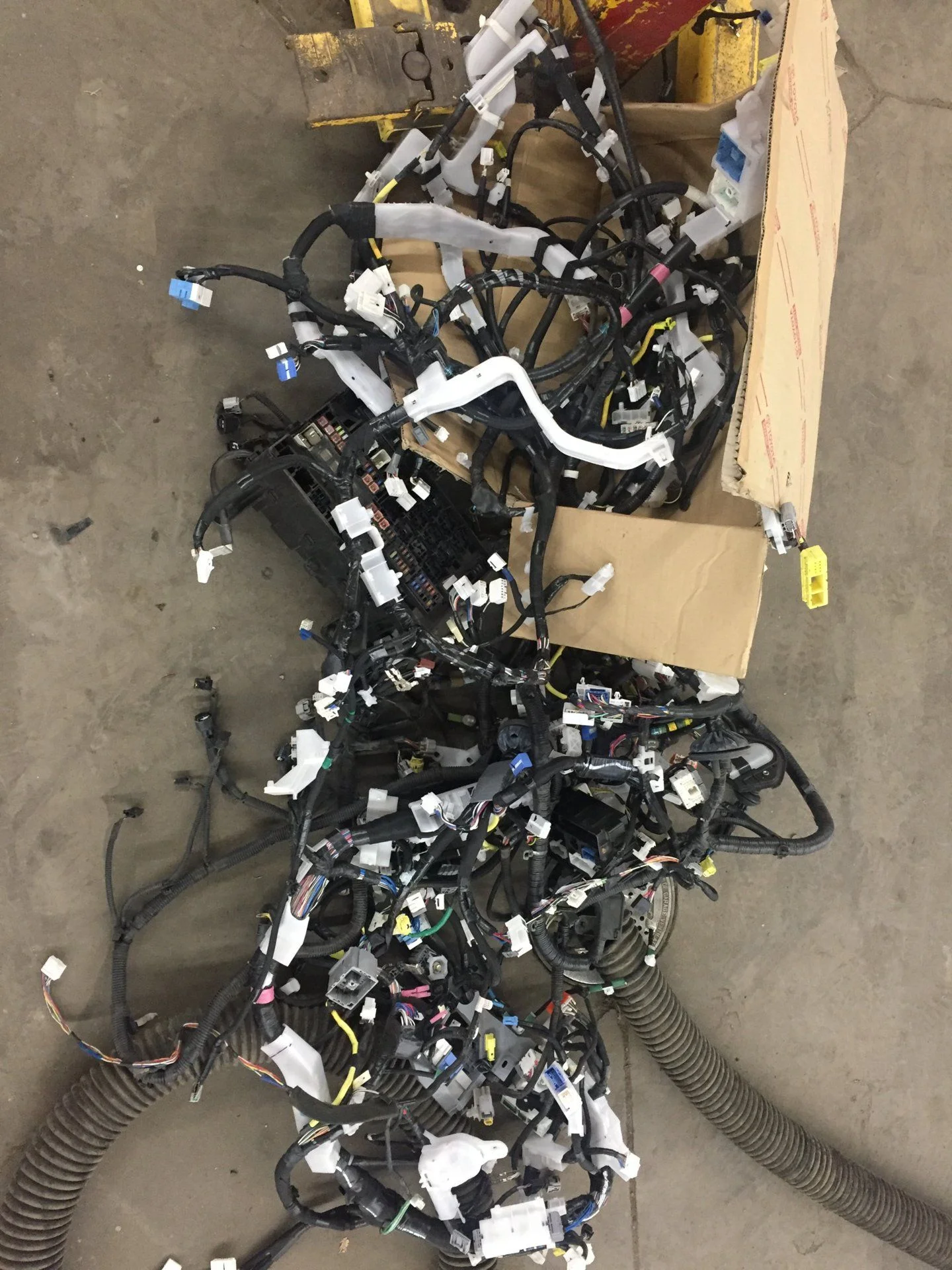

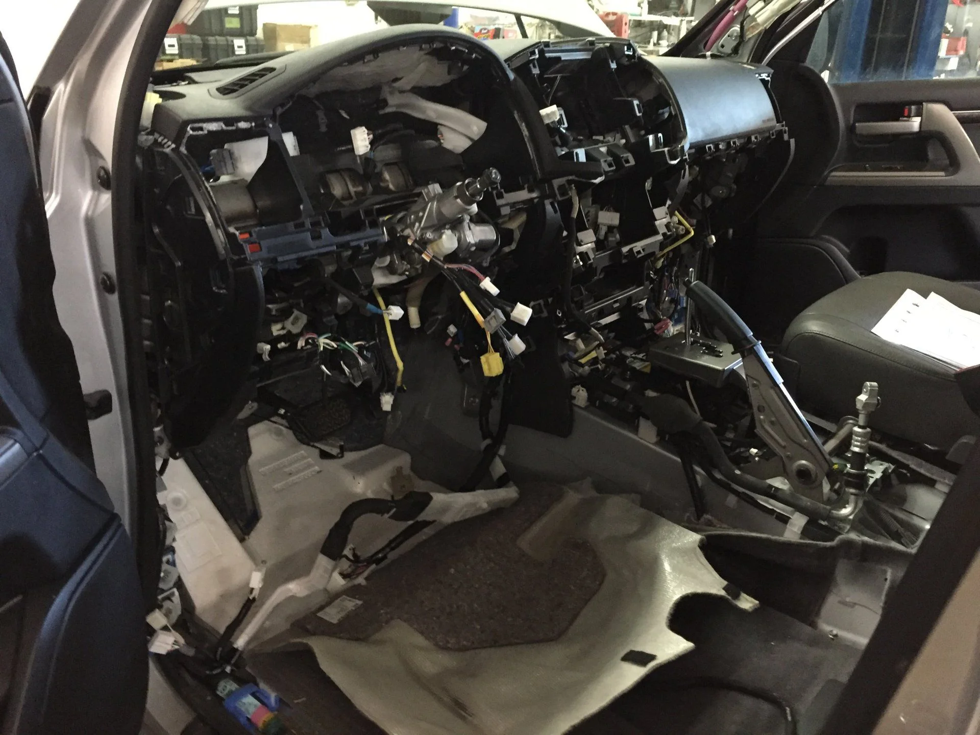

Help please - windshield leak destroyed wiring harnesses near ECU

Well thought I would give an update here. My 2011 has been in the shop for 3mos. They have put in 17k worth of parts and still can’t get it to start. I am going there tomorrow to get an itemized list of parts replaced. In need of some help here so if anyone has any ideas I am all ears. I am looking for some kind of land cruiser master technician. Does anyone know of such a person.
I assume they checked the starter?
They did. They replaced the starter. I will post the list of goodies that have gone in so far. Seems like my insurance is going to total it. Such a bummer the cruiser is in pristine condition other than it won’t start.

Yeah. I’m torn. This has been a brutal experience. If I didn’t have insurance involved I would be in tears. I loved that truck for the first 5 drives. As soon as it didn’t start i was shocked. I had searched for months to find a rig with helpful advice from this amazing forum. The one I found I vetted heavily. There was no way to know the windshield had been leaking to the mainframe. Which in my opinion is a terrible design that allowed this to actually happen. The fact that these parts are so expensive to replace/repair is another deterrent.
Upon having the local Toyota service call me and say we found the problem and it is going to be in the tens of thousands I was terrified.

Leaked from the bottom of the passenger side windshield. Turns out there are a lot of electronics there

Well its definitely their fault. How long ago was it done? I guess you notified them that this happened? What was their response? This should not change your opinion of the TLC or make you insist on a CPO or warranty for next purchase, it has nothing to do with the TLC design. Simply a case of a bad installer. Sorry this happened, really stinks. Would be even worse if your insurance company jacks your rates up through no fault of yours. The windshield installer should be paying for it.
I don't know, folks ... that sure looks like flood damage to me.
Just sayin' :ninja:
It seems odd that a car that spent its life in AZ would have any kind of moisture/leaking damage from the windshield. They do have the monsoon season, but in general it's the desert, not much rain, and assuming an owner of an LC would have it garaged. There have been a few really severe flash floods in AZ the last couple of years, cars under water, could be the case with this one. From now on, if I'm looking at a 200, I'll be checking every fuse box and under dash.
Yes no doubt. It seems incredibly odd. I would definitely pull the glove box and check the connectors/fuse boxes etc. of any other used 200 I were to buy.
