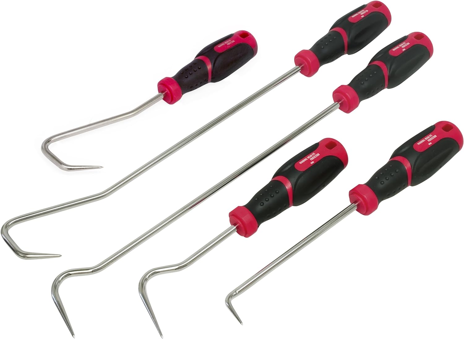

Spray with windex , and use a small pic or thin plastic wedge ( like a drugstore tooth cleaning pick or the tip of a zip tie ) to get the windex to seep between hose and tee.
And : Your Tees are going to break , crack and disintegrate in the process .
Therefore : remove the tees and hoses while assembled , so that you can retrieve the broken T plastic pieces on the bench .
