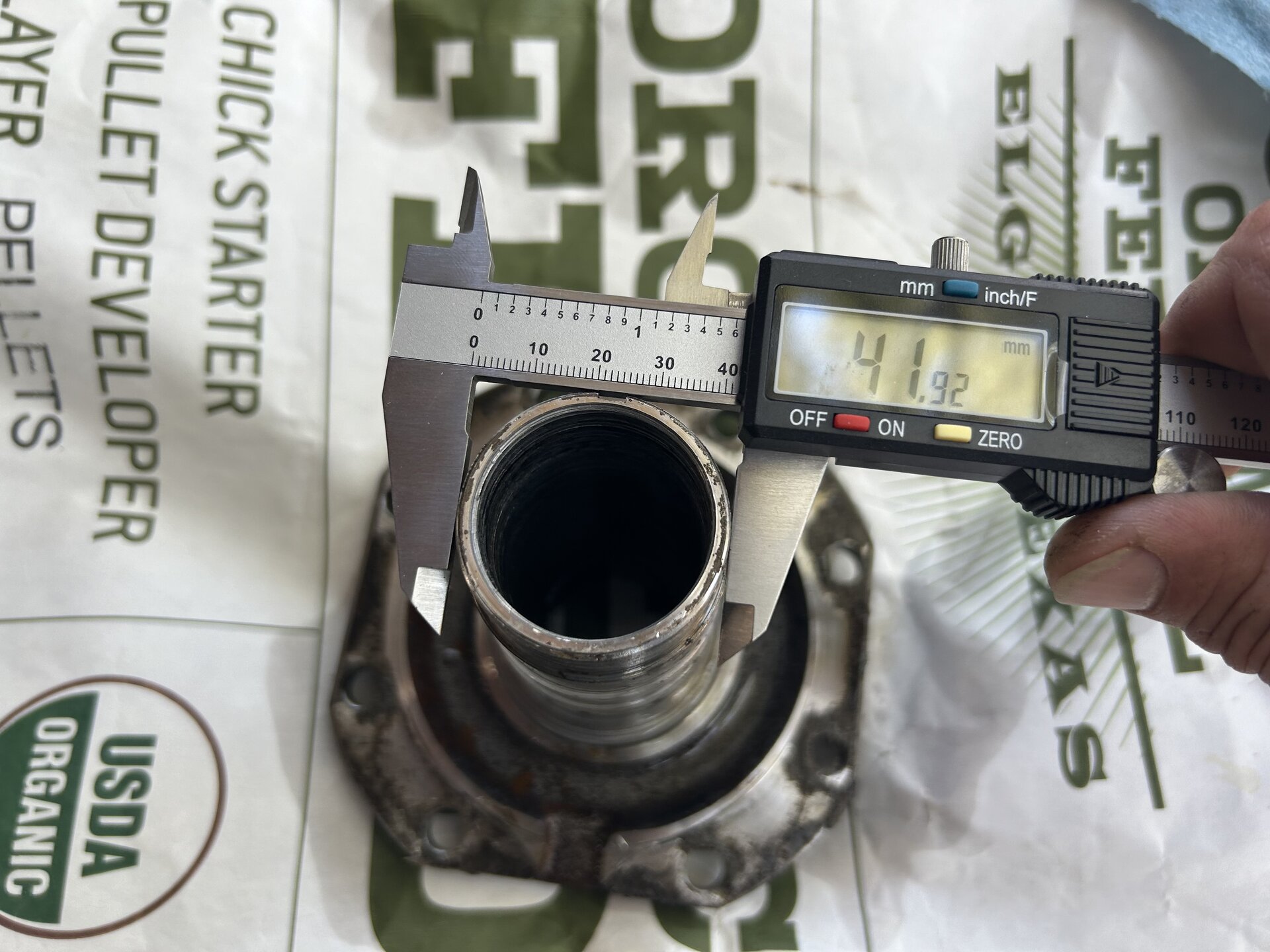

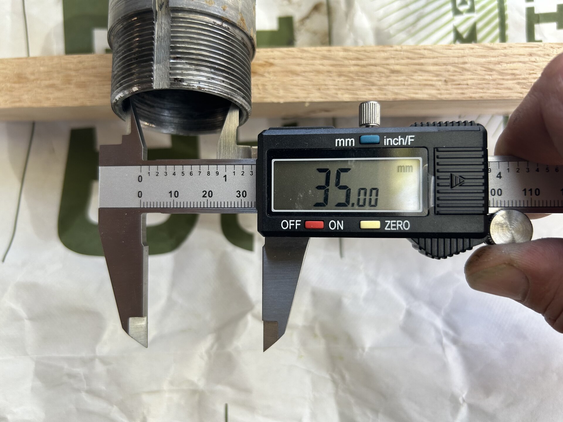

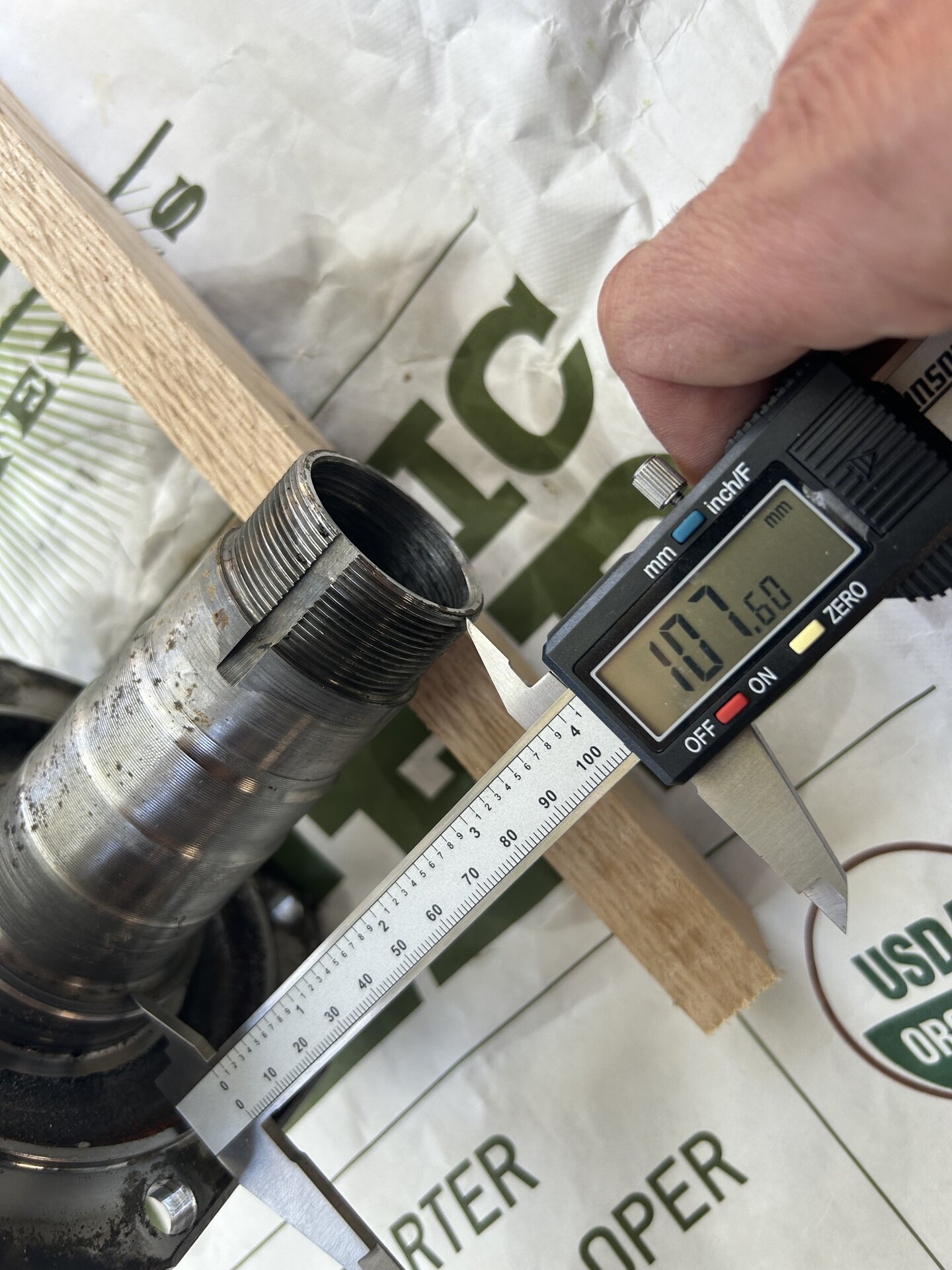

If it helps you at all, mine is taken apart for a knuckle job. Just waiting for paint to dry.
I can take measurements of mine (April of ‘80) and you can compare? May help you deduce.

That would be great! Much appreciated!

Is it a drum brake or disc frt end. 76 was the 1st yr for disc's. Do the dates you ref include a month. 75 to 90 ref a month, like 9/75?
Also, spindle length had a few years off a longer set up, I believe the year range you posted was for drum vs. disc spindles but beware of the long spindle, what I am trying to say is that a year range of 75 to 90 for spindles doesnt make sense, there should be an odd gap like 76 - 79 when the longer set up was used. It does make sense for drum vs disc knuckles.
KISS. If it’s held on with 8mm bolts, it’s a drum spindle. Disc uses 10mm.

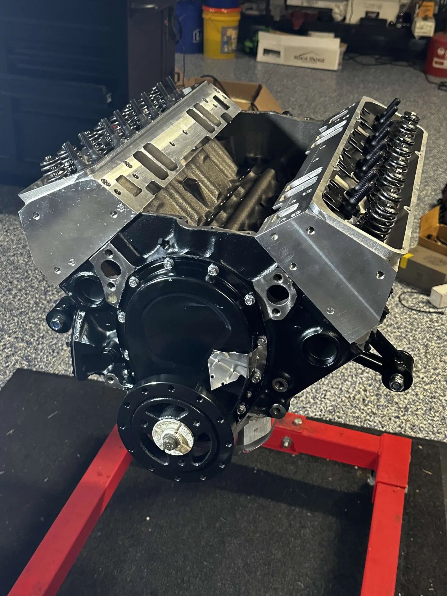

It actually had the motor in it when I bought it, and I was fighting overheating issues constantly. Put in new fan, shroud, all kinds of work. Decided to pull the motor and take a look at inside (it was burning oil and rear main was leaking anyways), and found the the back passages for cooling the heads were rusted shut!
So, decided to upgrade it with a trusted builder that built my LS7 after it dropped a valve.
This build has a smaller harmonic balancer on it, but I do have to do real motor mounts as this was hacked in before. Long story short, I appreciate the guidance for looking at that as I set the motor mounts up.
