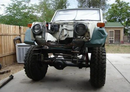

treeroot and i are putting the v8 in the piggie today...
sbc350 with cruiser 4spd and, for now, stock armstrong steering, with advance adapters front mounts.
does anyone have this setup that can help us on positioning. the mounts look like they need to be above the frame, and we'd have to be tight to the firewall to get them behind the steering box/mount. is this correct?

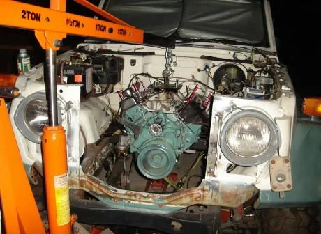

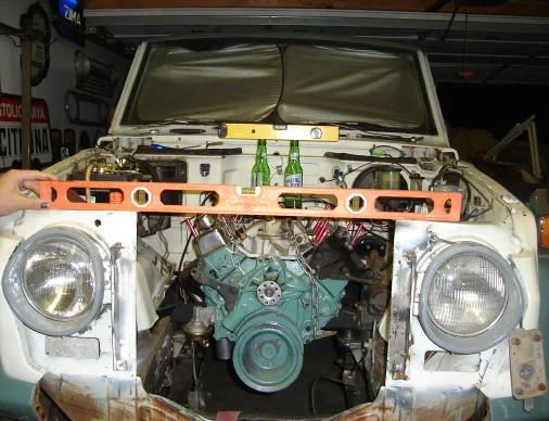

well, we winged it and it's in...just tacked for now. got to set axles and tack and pull it all out and weld everything in solid...started the morning stripping everything off and grinding the old motor mounts down...ended the day checking it all on a level.
I think it took us longer to bolt the transmission together than it tok to weld the motor in. and....I needed my beauty rest :flipoff2: This OT is killing me.
Heh heh, at first I thought your level was the Rolling Rock!
The Piggy is looking REAL good!!!
the only way to get the level above all the crap where we could set it level on the engine was "risers" :D we enjoyed a few of these yesterday :grinpimp:
