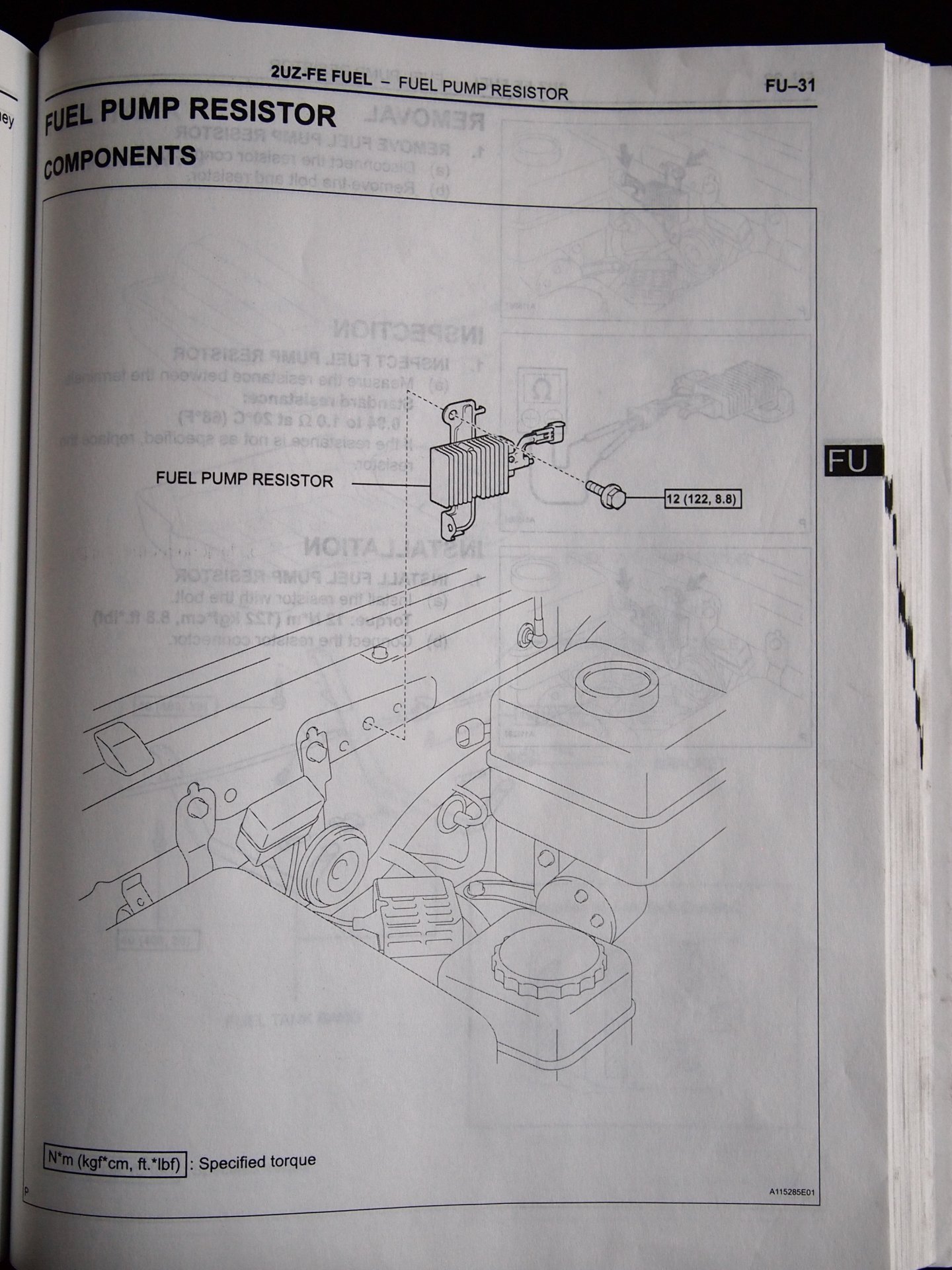

2) Most common is fuel pump in the 06-07 resulting in shut down. I would think the new OEM fuel pump took care of. But it possible you got a bad one. I've never R&R with OEM. I've only used Denso (Not Toyota Denso), which we must remove pump from cage (housing/holder). With the Denso I've never had issue. But if Denso used it must be installed correctly at all points. Which an O-ring we must install, cage set correctly and wire house block connect securely.
3) Just recently a teenage in high school near me, made an observation (very smart and observant of him). He had stall issues, after installing air pump. The pump block the fuel pump resistor which is on RH fender, which has a heat sinks. He moved the resistor into air box, which gives constant air flow to dissipating heat. It's not been very hot here yet, but to-date he's issue cleared. About the some time. A builder and I talking about this fuel pump resistor. He's seen then go bad (not 100 series) on Toyota's. He also said we must have great than 2:" cleaner (air space). They will get hot (increasing resistance) and reduce power (volts/amp) to fuel pump, by to much at low RPMs. During high RPM, ECM routs around resistor and gives full voltage to fuel pump. Fuel flow/pressure drops at low RPM to much if this reply bad or over heating.
