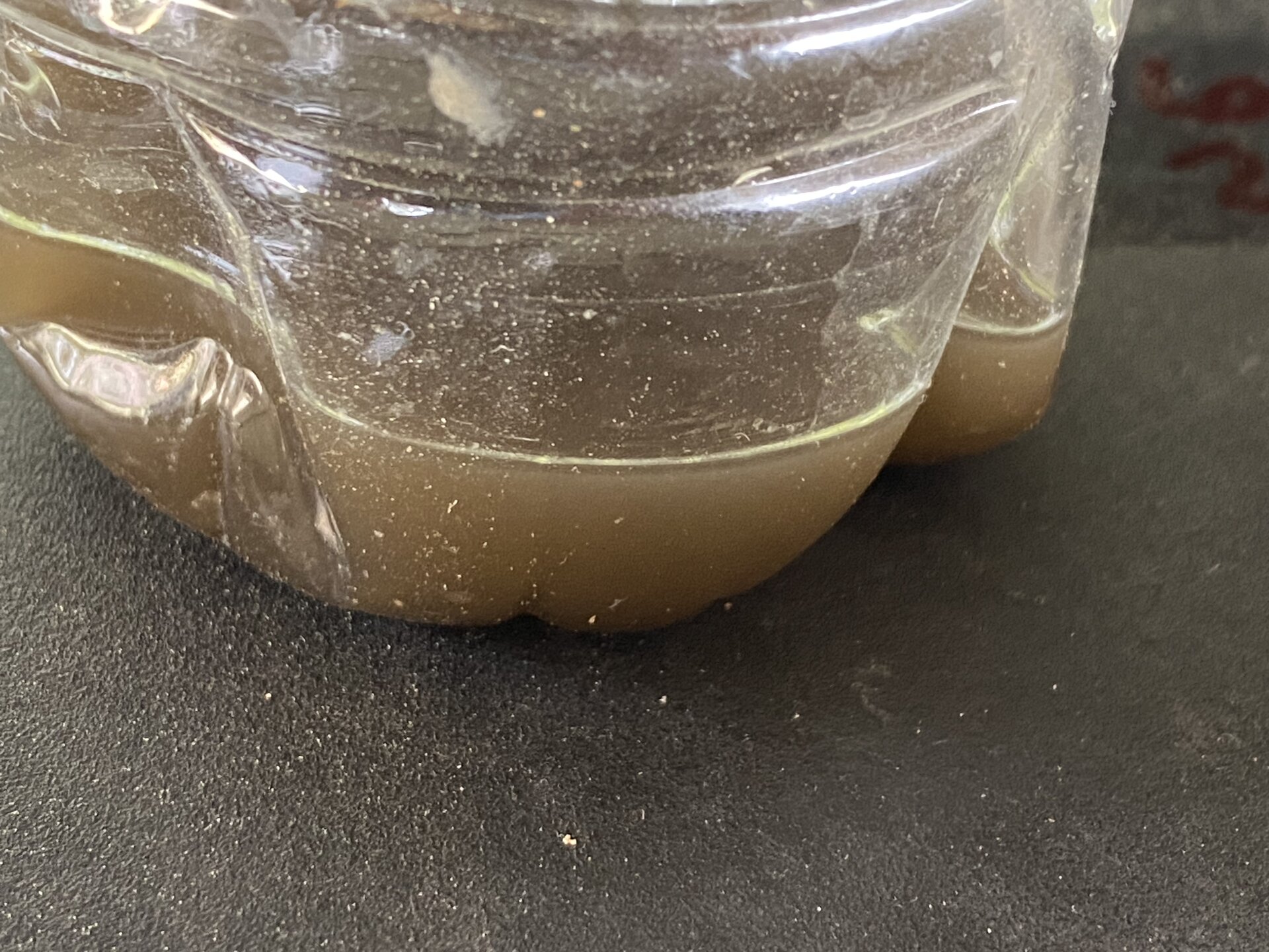

I hooked up my scanner,no codes stored,let it cool for a few minutes,fired it up and drove 300 more miles with no problems Until I was a few blocks from my destination.Then it stumbled at a traffic light but never shut down.It was running like a carbureted engine would with fuel filter full of trash,where when you shut the engine off the trash would fall out and allow fuel to flow.I added sea foam ,cleaned the maf sensor and throttle body. I returned home (550 miles) without incidence.After swapping out the fuel filter I noticed much better acceleration and less downshifting on long grades.The fuel from my old filter was literally gray. I don’t have a definite answer as to what caused my problem but with no codes I have to suspect it was fuel related.

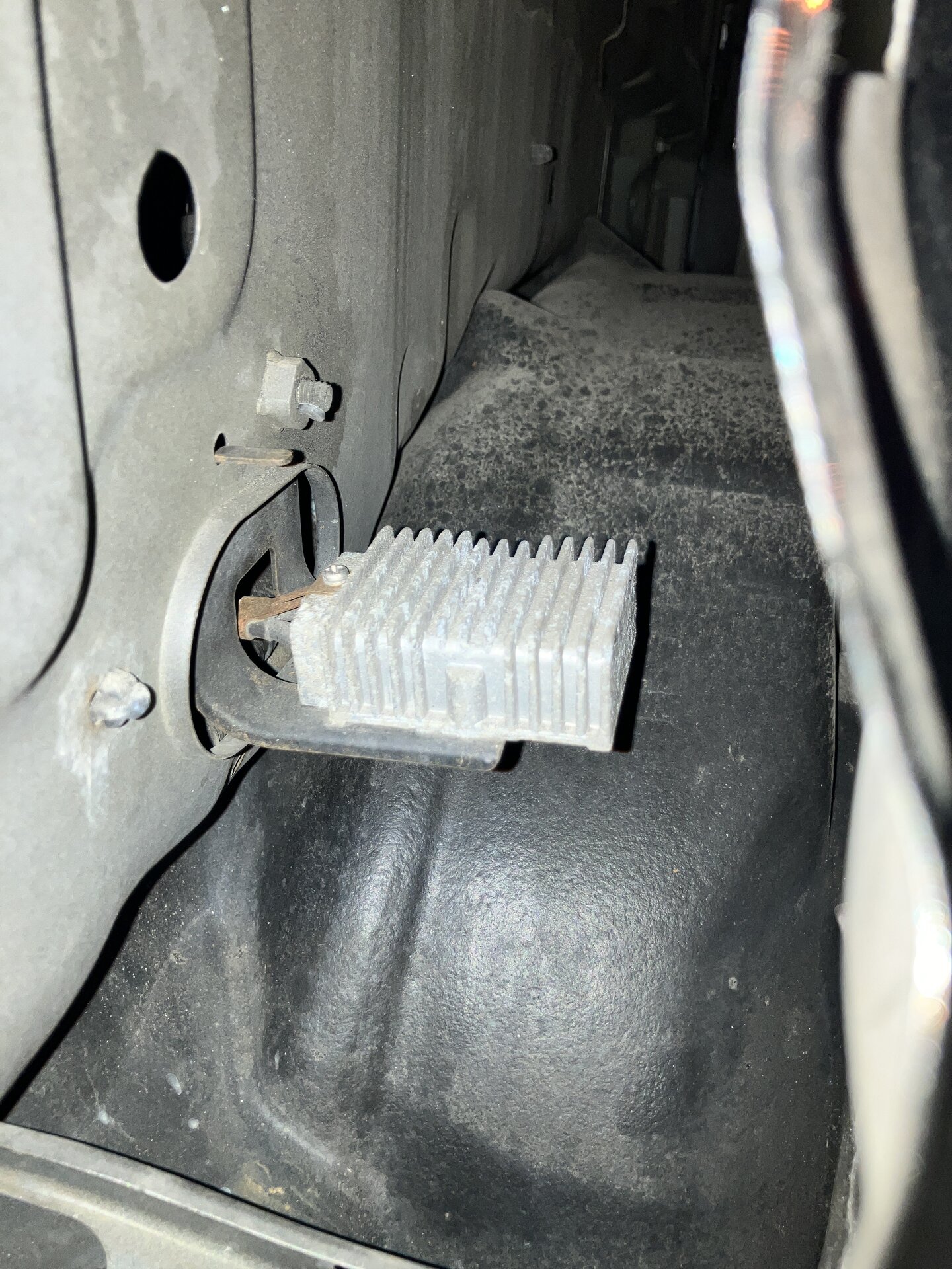

Oddly enough when I was rebuilding my wife’s LED projectors in her 2005 Sequoia I noticed Toyota stuck the fuel heal sink thing in the DS fender well. Its located behind the battery on my Gx and get no air flow.

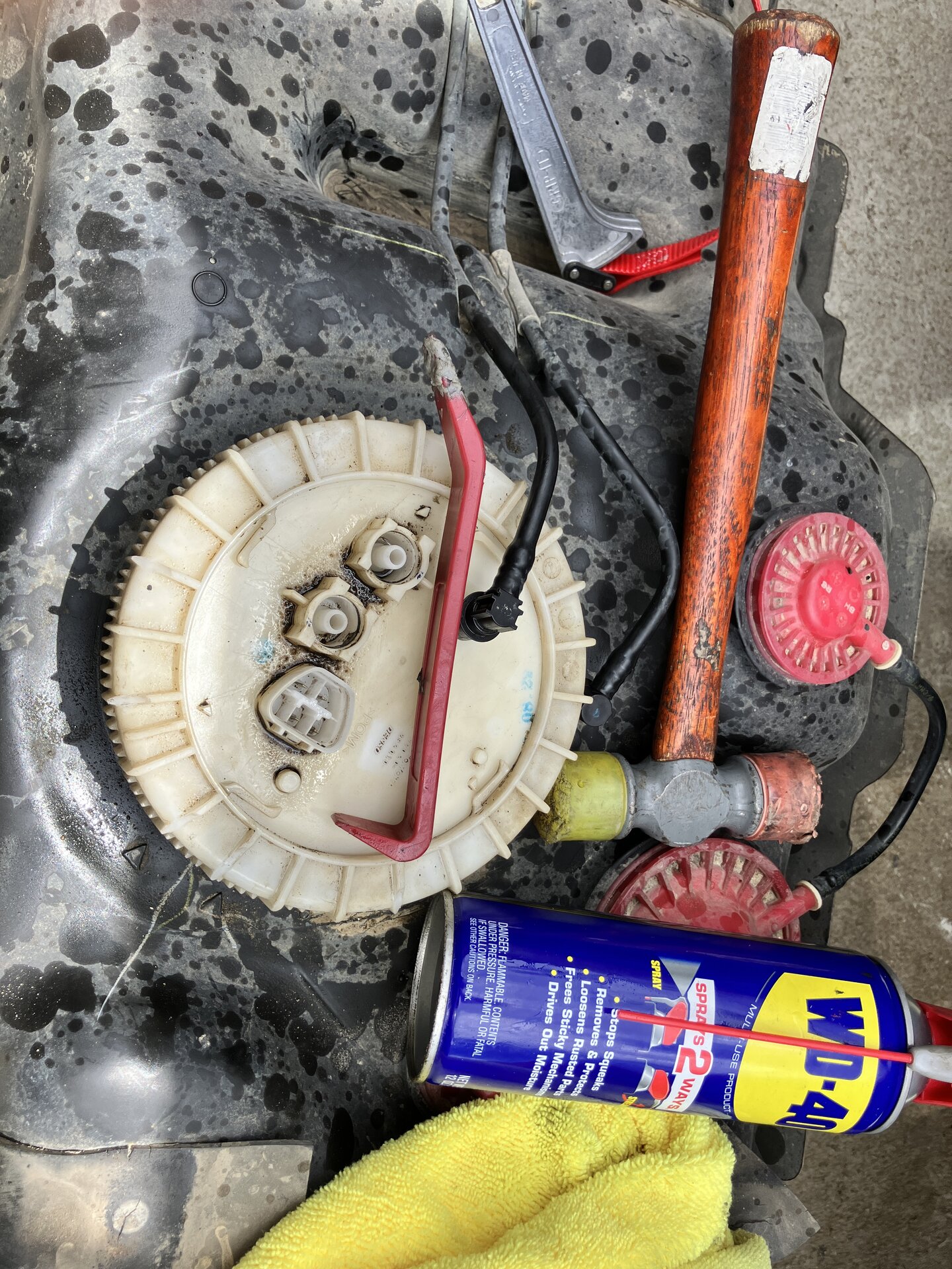

So far so good, I did 2 things,
1st I lengthened my fuel pump wiring, it was taught from the 2" body lift installed a few years ago.
2nd I replaced the fuel pump.
