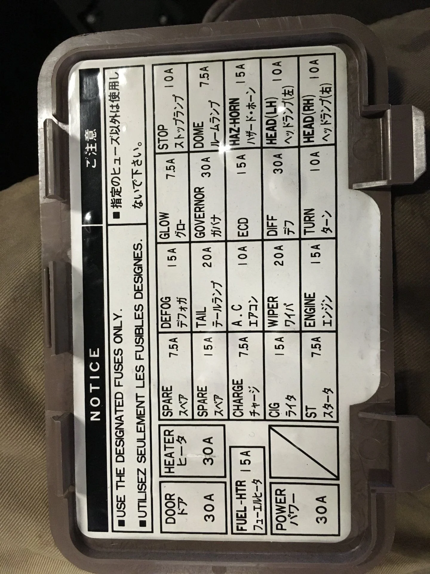

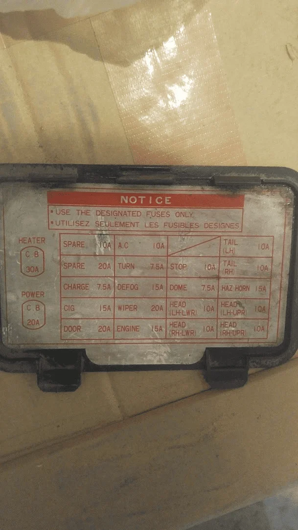

I need help locating the right fuse for the indicators on my LJ70. I know the fuse box is located at the feet of the drivers side but unfortunately I’ve lost the cover! Which fuse coresponds to the indicators? Thanks guys :)
This is from a 1991 LJ78, but it should be the same.
It helps if you tell us the year, model and market. Many things are updated over the timeline of a model.
I think yours will be the same as this one , part number 82683-90K04
