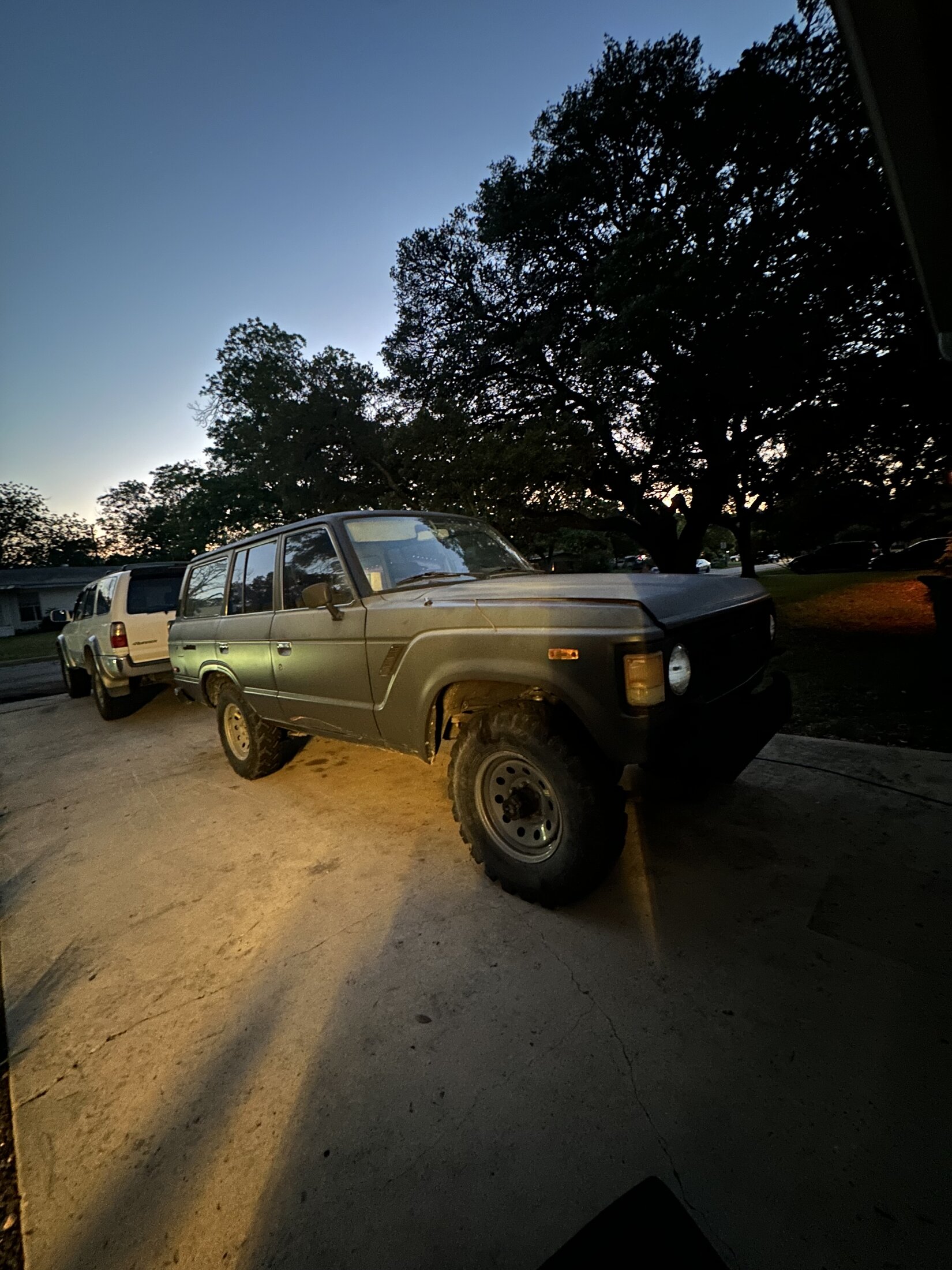

Evening, guys. Long time listener, first time caller.
I am SUPER excited to finally be a part of this family. I bought a 1984 just this past Friday.
