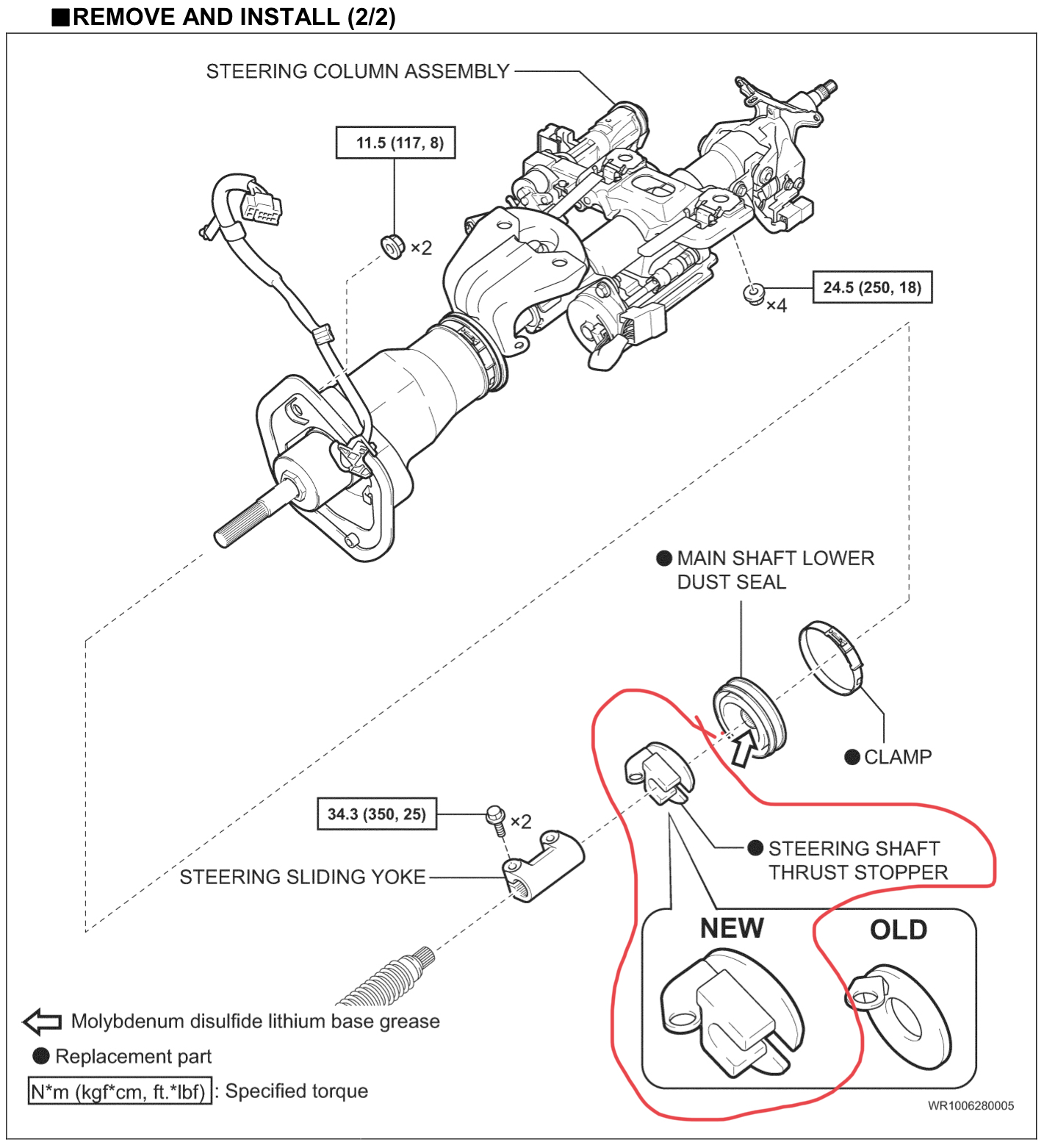

Looks like the steering shaft thrust stopper. Any chance the recall work was done recently?
I think this is it. Glad I asked before I died in a fiery wreck!
The previous owner took it to the dealer for everything so my guess is it was addressed when the recall was first announced.
According to the diagram this should be the replacament part. It may have been installed incorrectly if it fell out. I'd investigate this ASAP!
I thought the bolt backed off and the part fell off, but it looks like that wasn't the case?
Correct me if I'm wrong but the part is supposed to between that boot and yoke right?
Did the dealership never bolt in the part?
I'm guessing the upper sliding yoke bolt should pass thru the tab on the part to hold it in place?
