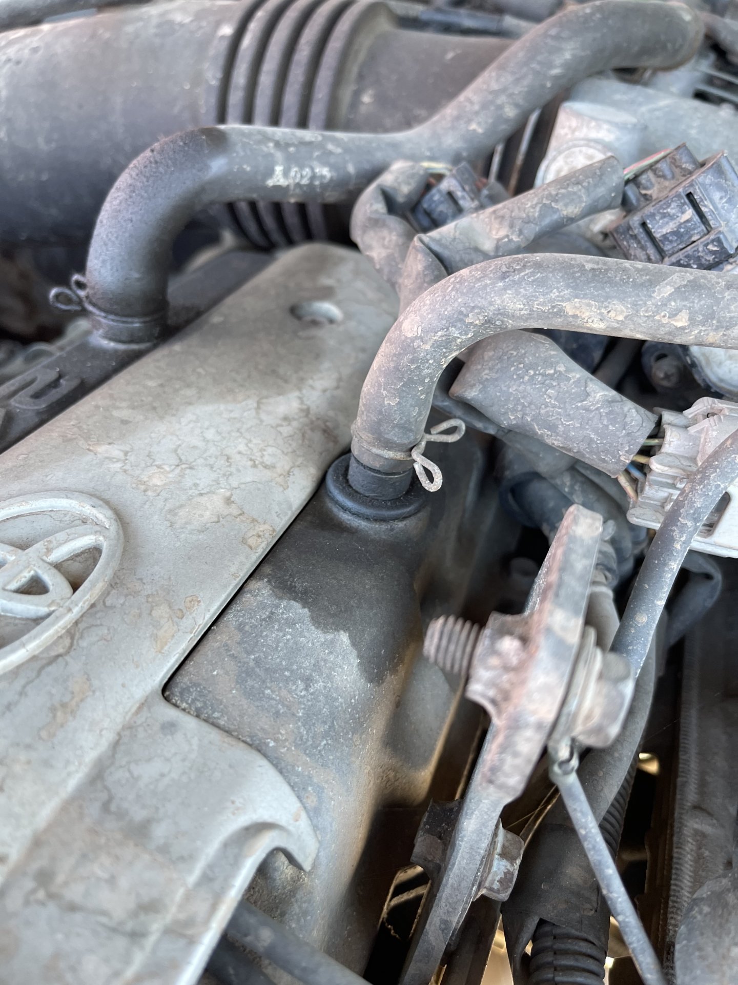

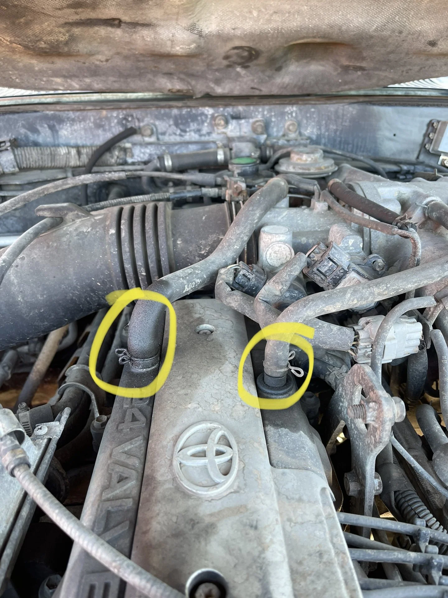

Hello all,
I am back with some n00b questions.
Was doing some work earlier and found these two to be leaking. Just wondering what they are, and what issues this could cause as it is.

What are the codes for the engine light?
One on the right is the pcv. The valve itself probably needs to be replaced as well and the grommet in the valve cover.
The other is just a breather/vent hose, just replaced mine but not sure what it's technically called.
Partsouq will have them cheap or any of the other online spots.
Search around tons of information on them.

Those leaking hoses in conjunction with a non-functioning PCV valve might also be adding to the build up of condensation in the engine. One 80 I picked up a few years ago had a completely blocked PCV valve.
Also, on top of reading the FAQ's section, learn to do searches, top right of any page in the 80 forum, choose "this forum", for example, type in "baselining" or "PM" or "Preventive Maintenance" and read, read, read.
Just a thing to note...that PCV and its grommet actually look fairly recent. If the grommet is still pliable (i.e. rubbery and not hard plastic feeling) and the PCV rattles when you shake it back and forth they are probably good. On the other hand, if the PCV does not rattle, it could be clogged shut...which would explain the seepage out the other hose...which too, is split at the end.
Either way tho, the parts are cheap enough to just replace and mark off the baseline list.
If you end up replacing the PCV grommet, and it is not pliable enough to remove out the top of the valve cover, highly recommend removing the valve cover first to get the grommet out. you don't want any of it falling back down, into the valve cover. The pieces won't make it directly to the valve train in that area, but you'll still need to remove the cover to get the pieces out anyway before running the engine again.
And lastly, to get the PCV out, it is simply friction fit into that grommet. A firm gasp and wobble/spin to pull it straight up and out is the ticket. This tho will not happen if the grommet is petrified. lol
