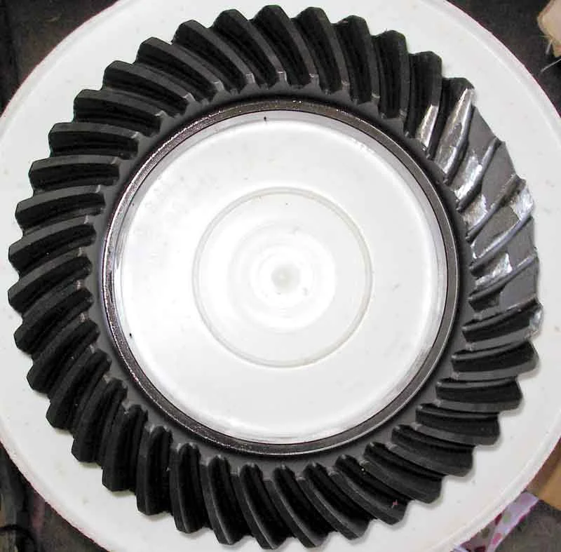

Just say "NO" to mini truck ring and pinion in a Cruiser! 80 birfs and axles are really tough but the reverse rotation 8" R&P is a huge downgrade to what you already have! You can hybrid a 6x housing and 80 ends using 80 birfs and 6x inners but then you still are only the width of the 6x and you still need to deal with hi steer issues. The ONLY advantage of a Cruiser full floater in the rear over semi floater is the lack of c-clips. Unless of course you plan on hauling some weight.
Edit: What happens when you combine mini truck stuff on a Cruiser?
So you think cutting up my current rear axle housing and centering the diff is the way to go? OUCH! I am scared. Is cutting up a full float cable locker housing worse than putting a mini truck ring and pinion in my cruiser? I wouldn't need the full float I was just curious if it would work with my current axle. If I go that route I will just keep the cable lockers.
