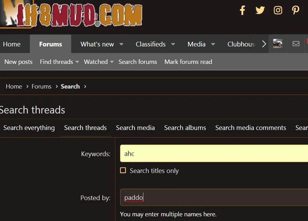

You are noticing how the ahc works. It's Automatic Height Control, meaning that it controls the set height automatically, not primarily a height adjusting feature. That means that it will automatically adjust the height, without your input, whenever it feels that one axle is out of spec height. The ahc will always work, even when you don't touch the buttons for years. It will adjust the height when you go uphill, when you go downhill, when you stop, when you speed, when you add or remove weight; but only in certain conditions. It will always wait a bit and check height over time (a few secs), and might well adjust when you start up again. All this is in the introduction to the ahc in the FSM and in a few forum posts here. I've posted your search terms under here, gives you a few threads to start with.
And here is one of the important ones - maybe a place to start: forum.ih8mud.com/threads/definitive-list-of-ahc-maintenance-items.604577/
