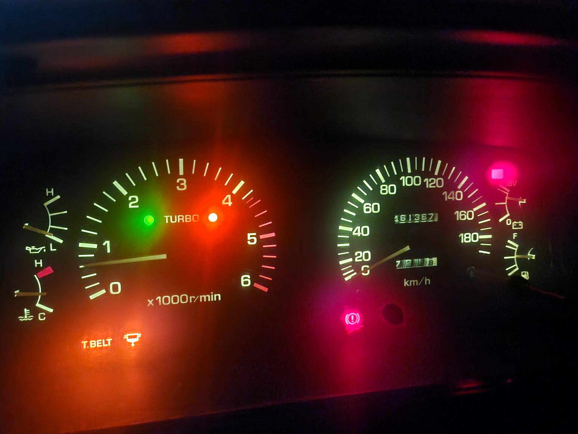

HELP. All this dash lights at the same time?
Sep 13, 2021
12
208
Montenegro, Europe
Sometimes while driving I get all this lights at the same time. Thay stay like that for a few moments and go... and come back without aparent reason. Sometimes they blink... Does anyone know what is the problem? I wouldn''t like to get on fire. It is 1991 HDJ80 EU spec
You might have better luck in the Diesel section !! North American Market did not get the HDJ80 :(
I'd start with the alternator:
Do you have a FSM Factory Service Manual for your truck?
They have the troubleshooting charts in there.
That looks like an alternator going bad to me, but with diesel and timing belt, you need to be sure.
In oem manual I found that I should check belt tension, fusible link and alternator in general (cables, connectors etc)
And the oil presser looks low o_O
