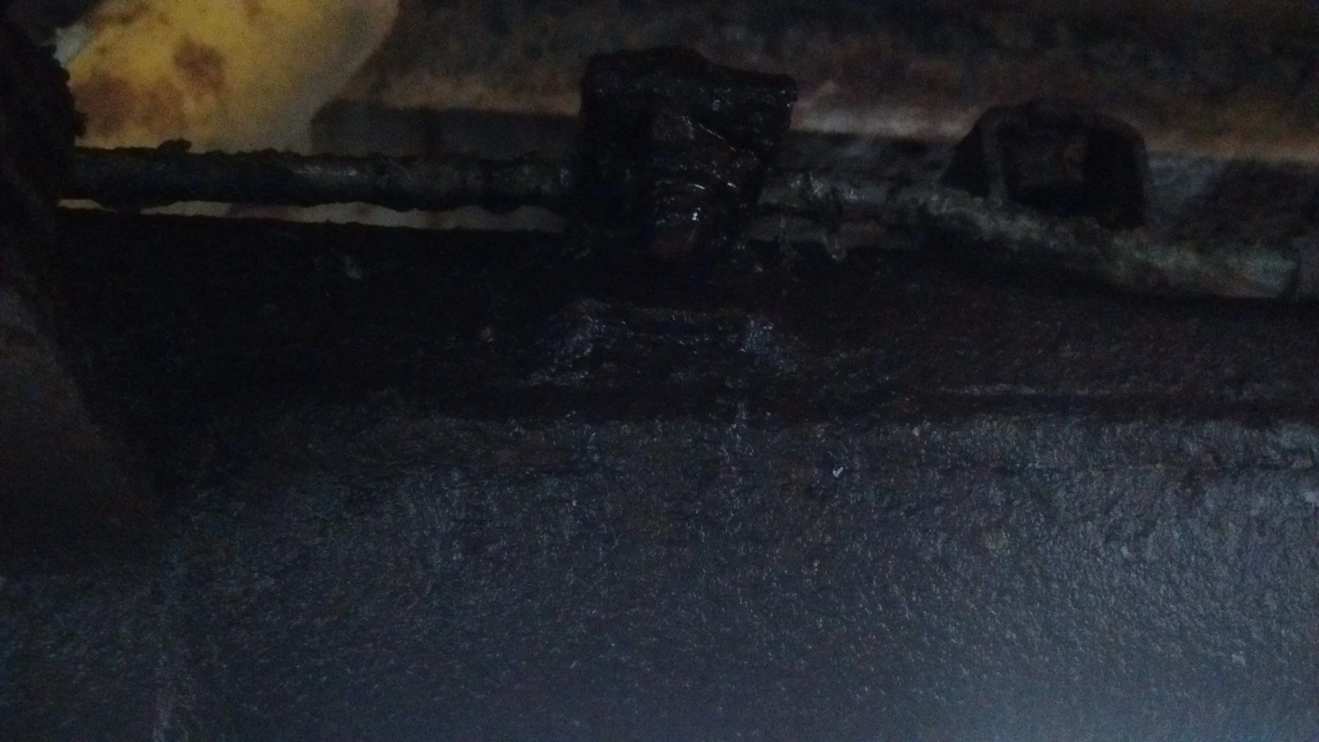

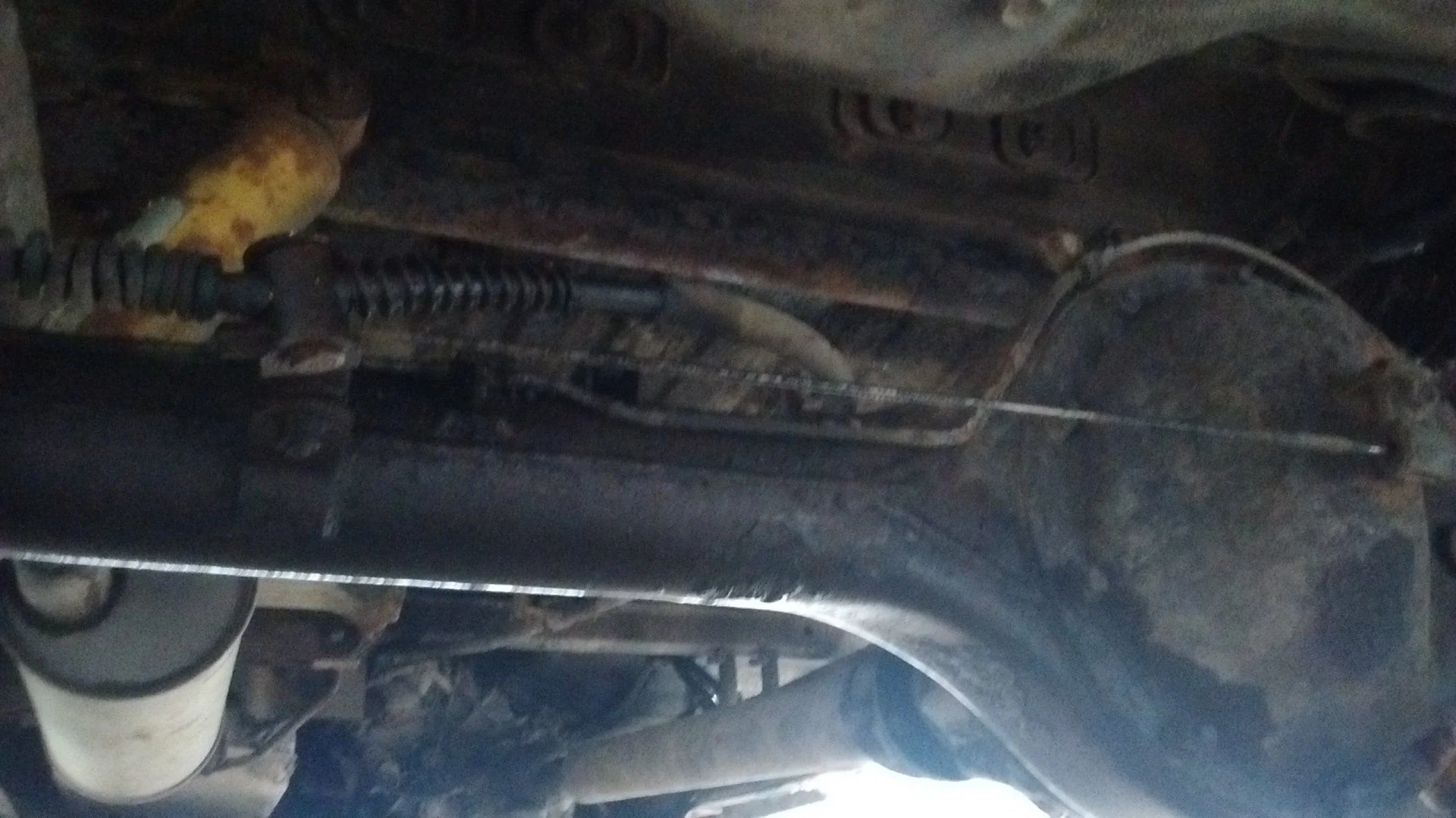

i just developed a leak in my rear metal brake line between the two wheels going across the rear axle, so i need to know the metal line size the fitting size/type and the flare type these lines have?

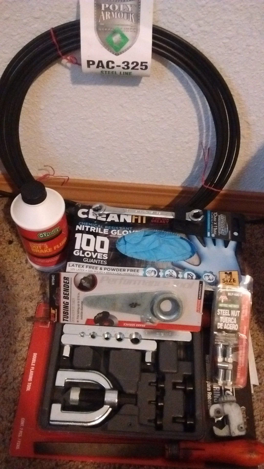

ok just got back with everything i needed thanks again everyone. oh and harbor freight didn't have anything i needed and i ended up with POLY ARMOUR steel line only in stock that were my size...
