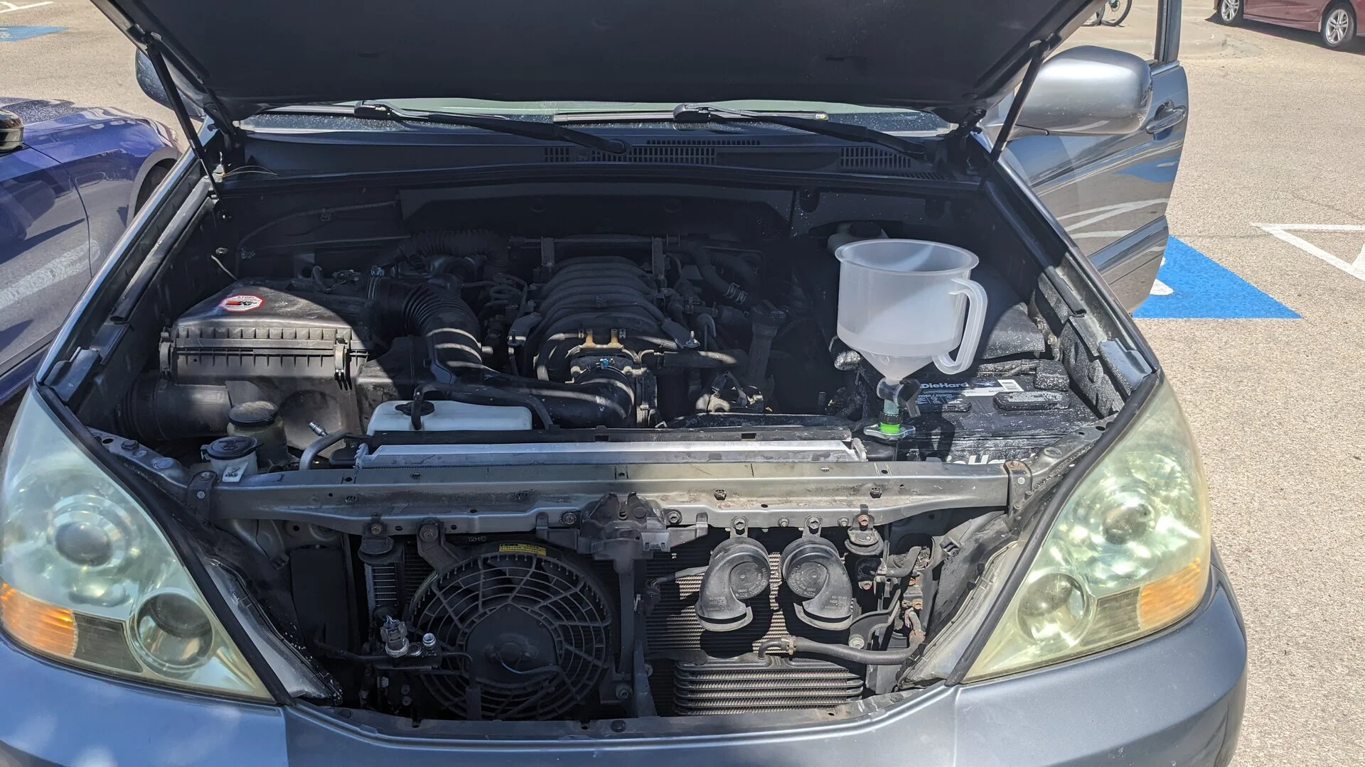

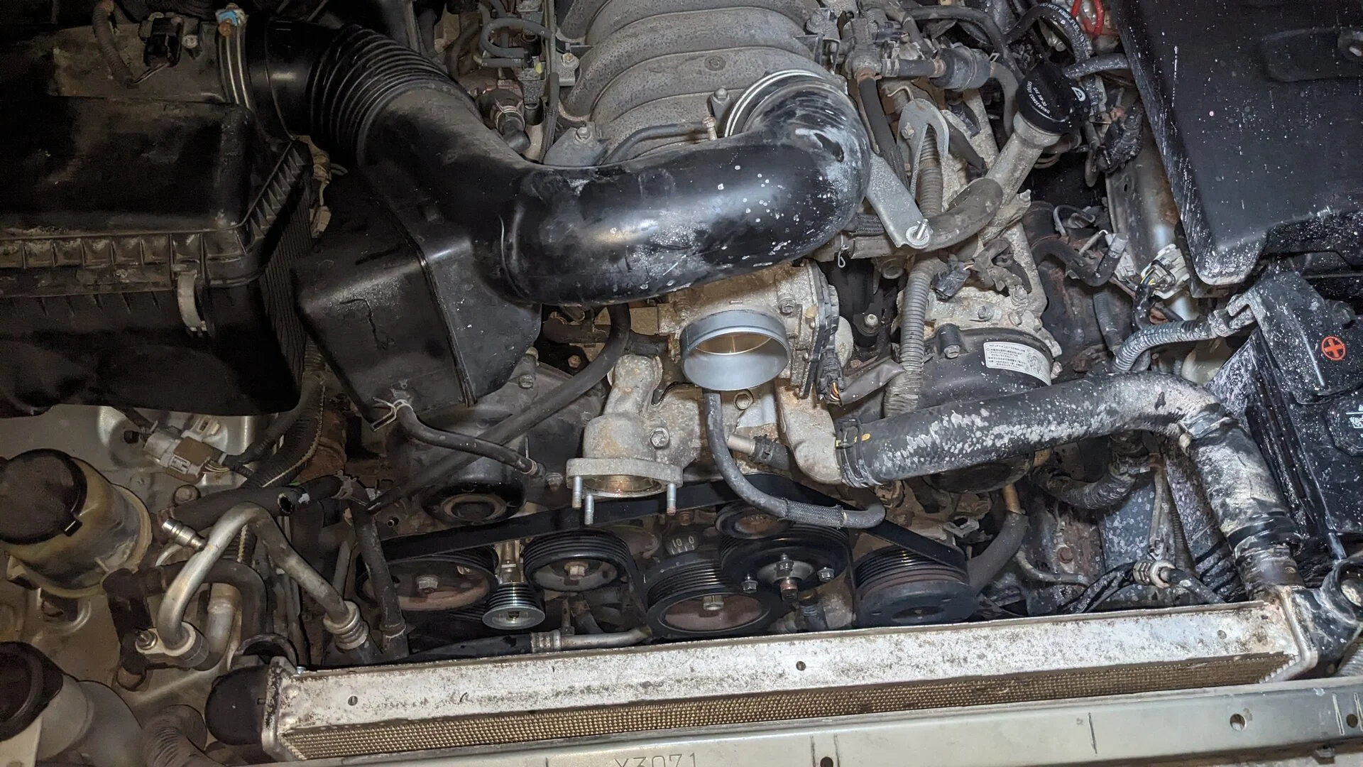

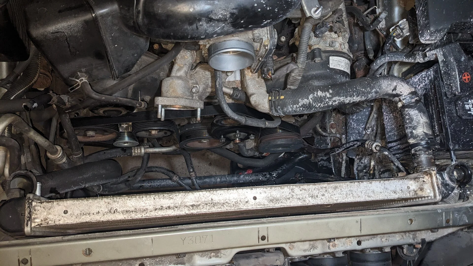

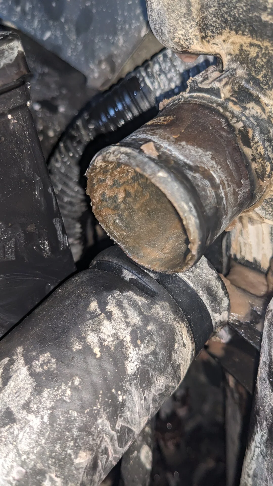

All parts and tools have been secured. Will post progress pics tomorrow. thanks all for you knowledge
Job done. Car running good, not overheating. Gonna flush the entire system this week (drain engine.) I checked the manual and the coolant was supposed to be changed at 100k. I dont think the previous owner did that, plus the radiator was leaking bad.
