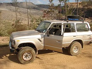

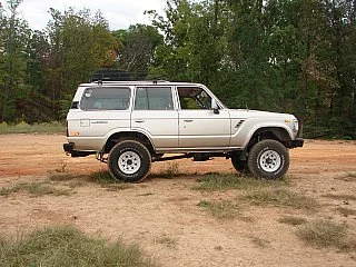

Before pics (Shoulda done this at first)
Here are a few shots pre-lift

I talked to Tom today and he wants everyone to know that he'll hit full production once he's sure every detail is worked out on the lift kit. I have the new, shorter rear springs which we think will raise the rear end more and be better overall. I also need to get him my rear sway bar so he can add the extension pieces to the kit.
Nice !!What size tires did you put on? Yours is the 4" lift. Could you take a close up of the shackle angle?
Well, I'm still running the smaller 31 BFG AT's because I'm still saving for some 33s. At the SCC, I borrowed some 33 BFG ATs from Volunteer. I'd like to get those pretty soon because they filled that area pretty well.
I have some shackle angle pics too that I will upload later if y'all are interested. The rear ones aren't good to look at because they will change and straighten once I put on the new springs.
Very interested. Particularly when you fit the shorter springs. I'm having doubts as to whether that'll be a good thing, or not, honestly.

Will do. When Tom saw the pics I took, he said he wanted to shorten the rear springs. I don't know what is up with the group doing the 2.5 inch lift. Don't know if they are dealing with the same thing.
