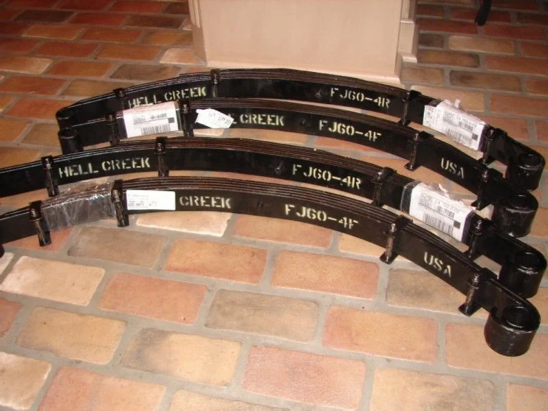

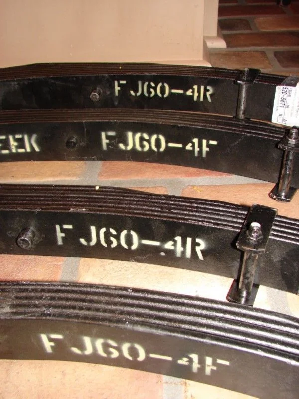

The Kit
What you get

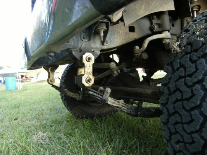

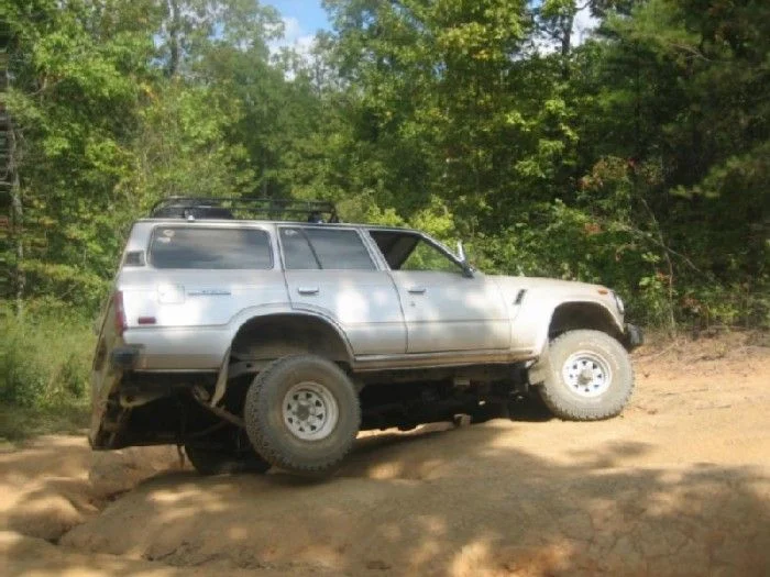

Looks like the spring is on the verge of inverting.... so why make them shorter??
Usually it points more to the rear of the rig under normal conditions. In the bind I'm in there in that hole, my front driver side is dug in and all the weight is pushing that way. I think that pulled that rear driver tire and shifted the other up pretty far. At least that's what I'm thinkin'.
