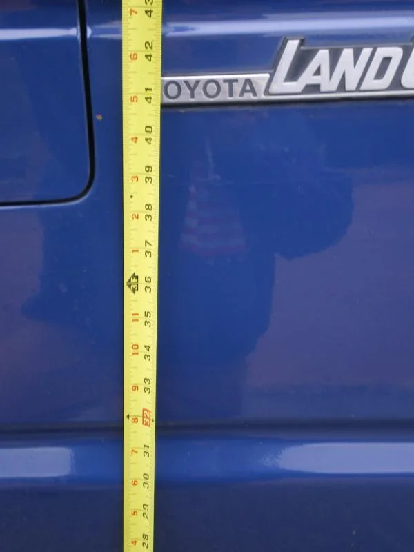

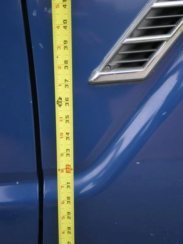

I think it may be an optical illusion b/c of the different cut outs of the wheel wells, but I'll run a tape measure on it and try to post some pictures.

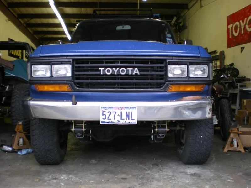

Here are a few so far...

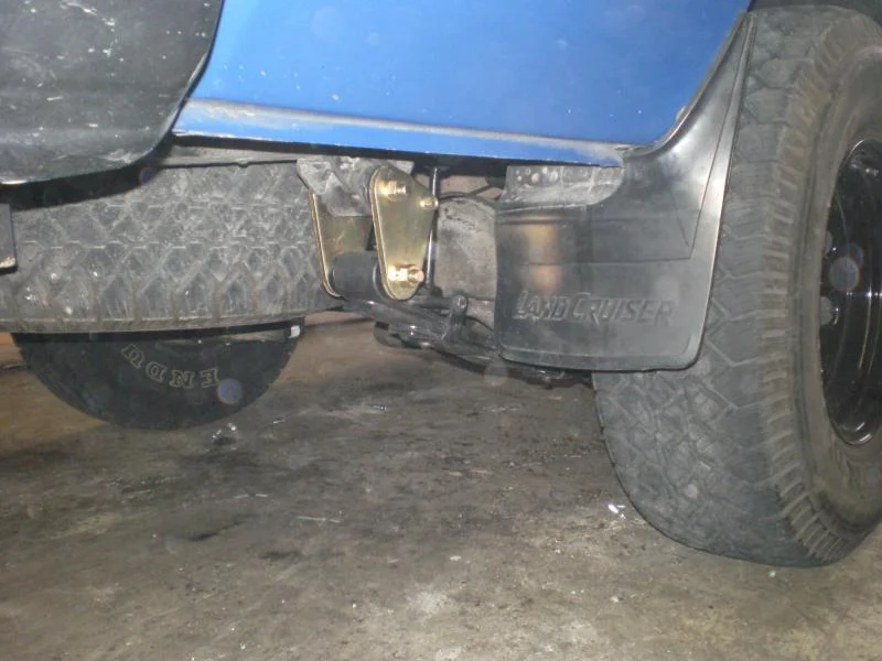

1 from the front and 1 of the rear shackle

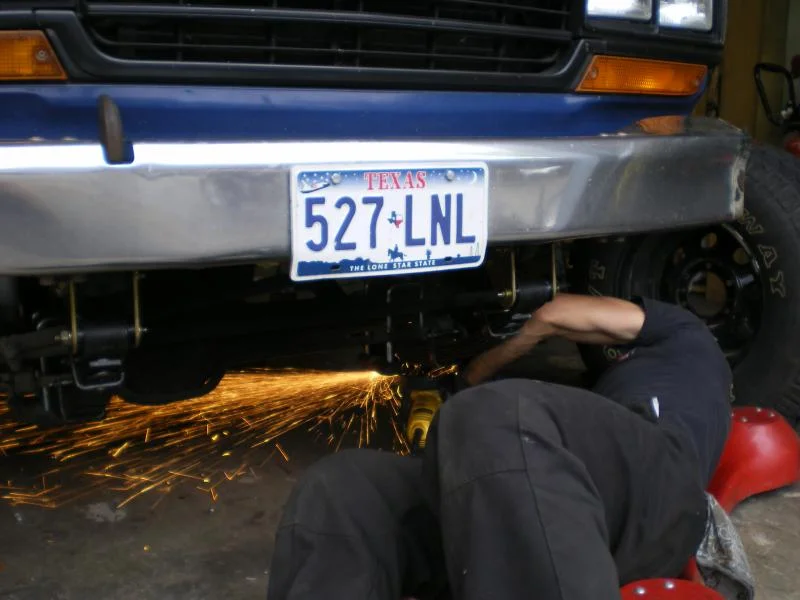

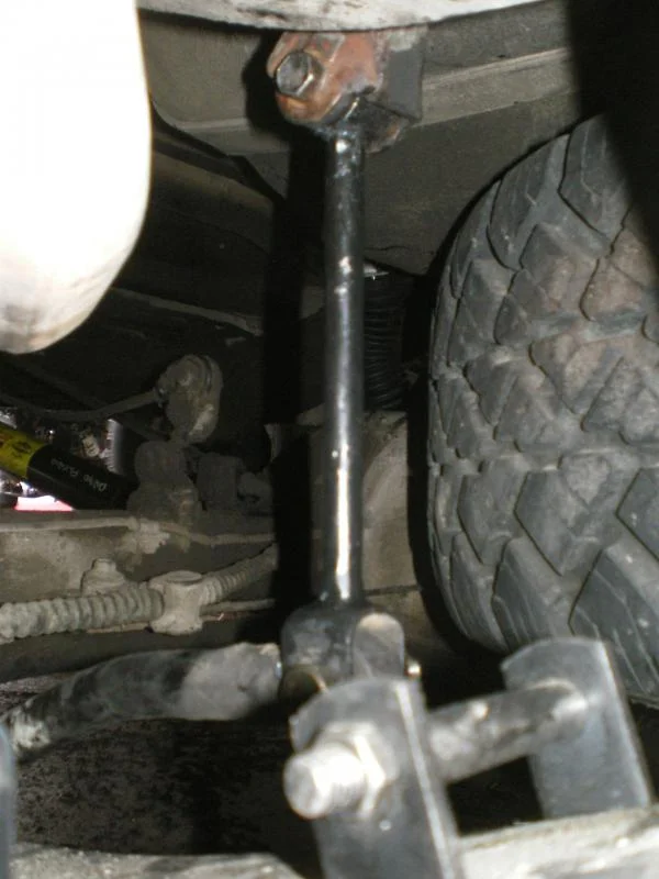

Fab work done by my buddy here in Austin at Freeride Fabrications and cutting off the U-bolts
Yes, but not until Sunday or Monday...it's parked on even ground and I'm headed to Supercross in Dallas...will do it as soon as I can

Tom is very hands on and will help you out if you have any questions, the install isn't the hard part...getting the old suspension parts off is and I think it's a great value. I ended up buying new spring hanger pins from SOR b/c to get the old ones out we basically ruined them and they were so corroded I didn't want to put new bushings on them. I think w/ the cost of the kit shipped to my door, the new shackles and hangers from SOR my total cost came to around $1200. Luckily I have a buddy who welds so he was able to fab up the extensions for the sway bar links. If not you can buy new ones from SOR...way cheaper to have them made!!
