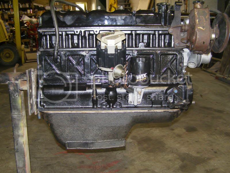

I got an HEI out of a 80-something GMC pickup with a straight 6. Swapped gear, ground flange and made a bushing for the hold down clamp.
Followed this article............
http://www.geocities.com/calcide/fj402fhei.html
Read it to the end, he mentions grinding off the flange
GL
Ed
I went with a gm hei with more mods to keep the original flange. I made a longer lower portion of the shaft by roughly 1/2" and redrilled the gear to sit lower on the shaft. I felt that it turned out reasonably clean. I did it all with simple tools. If you want more information on how to make a longer lower segment of the GM dizzy let me know. You'll need two distributors. So far it's been ok, but it's not a DD so I can't really give a reasonable analysis of long term reliability. I have noticed that it requries about 10 volts to fire, so on a low battery that will still crank it may not start. That may be a coil issue with mine. I'm not sure, but for a non DD it sits a lot and I have noticed that. I'm thinking that it may make it more difficult to push start as well. Anyway, good luck.

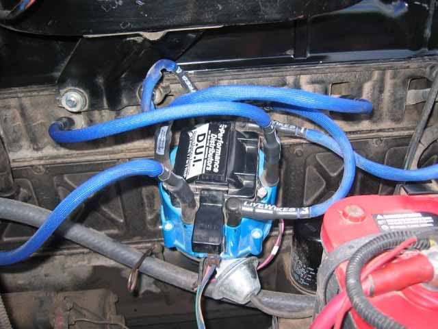

I had a DUI HEI distributor in my 40. It worked great and was basically plug-n-play. I will however mention that I had one problem with the gear stripping out and taking out the camshaft with it. DUI replaced the faulty part and replaced the Camshaft. After that, everything was just peachy.
http://www.performancedistributors.com/
Here are a few links to my threads on Pirate where I discussed my experience with the DUI. Hopefully its helpful to someone.
http://www.pirate4x4.com/forum/showthread.php?t=180234&highlight=DUI+distributor
http://www.pirate4x4.com/forum/showthread.php?t=191087&highlight=DUI+distributor
http://www.pirate4x4.com/forum/showthread.php?t=195873&highlight=DUI+distributor
