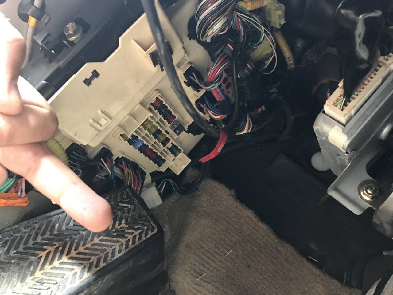

We had a large storm cell too through last night in Texas. Around 3:00am I was awoken by not thunder, but a horn blaring intermittently outside the house.
By the time I got dressed it was stuck on. I had to scramble to find tools and disconnect the battery while being half asleep.
My wife had left the sunroof in the up position and it must have overwhelmed the drain at one point. There was water in the DS floor under the mat. Passenger side is dry.
I removed the relay now that I can see which is what and it looked good inside. No moisture or corrosion.
I am hoping it's not the infamous kick panel fuse panel/BCM.
If you guys can help me save some time I would be eternally grateful.
I'm too frustrated to be working on it at the moment but it needs to get fixed.

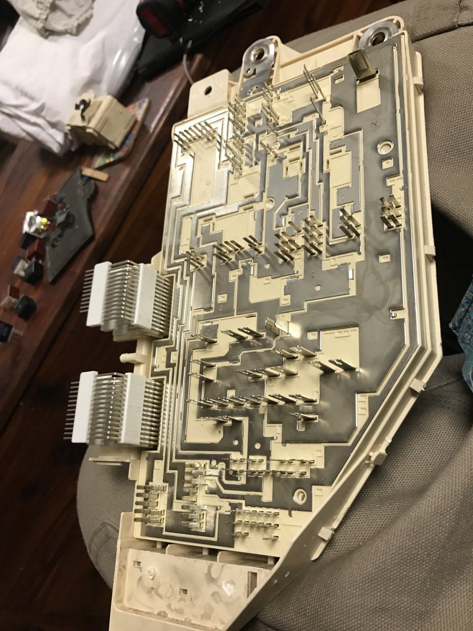

I went ahead and removed the fuse panel and cracked it open. If you for any reason decide to do this be very careful.
The internals consist of several layers of plastic boards with pins sticking up. They can easily be bent if you are not paying attention.
BE SURE TO REMOVE ALL THE FUSES AND RELAYS BEFORE PULLING THE COVER OFF.
No I do not have a replacement on hand.
It's not as bad as you think it is. Although the pins actually sit loosely on the board so if you were to drop it or bump it they could all fall off and you have to find out where they go.
It is definitely not for the faint of heart.
I did not find any considerable amount of moisture but I did find some residue or sediment at the bottom of it indicating that there was moisture pooled in there at one point.
I went ahead and blew everything out thoroughly and will put it back together so we will see what happens.

Here you can see where funk has been accumulating. I'd wager water has been leaking into it for a while.

Most folks (including me) have gotten away with a good drying out session being the long term solution.
