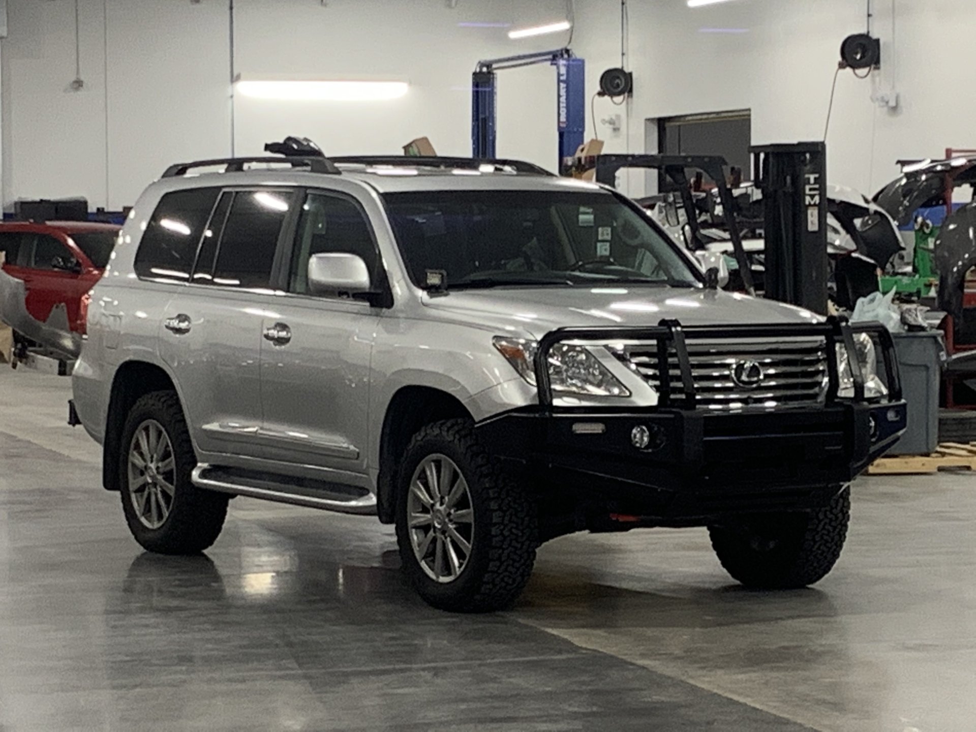

Bumper and winch ballast is already installed. Very pleased with the Ironman bumper. I was able to do a slight modification to it and use my arb recovery points.

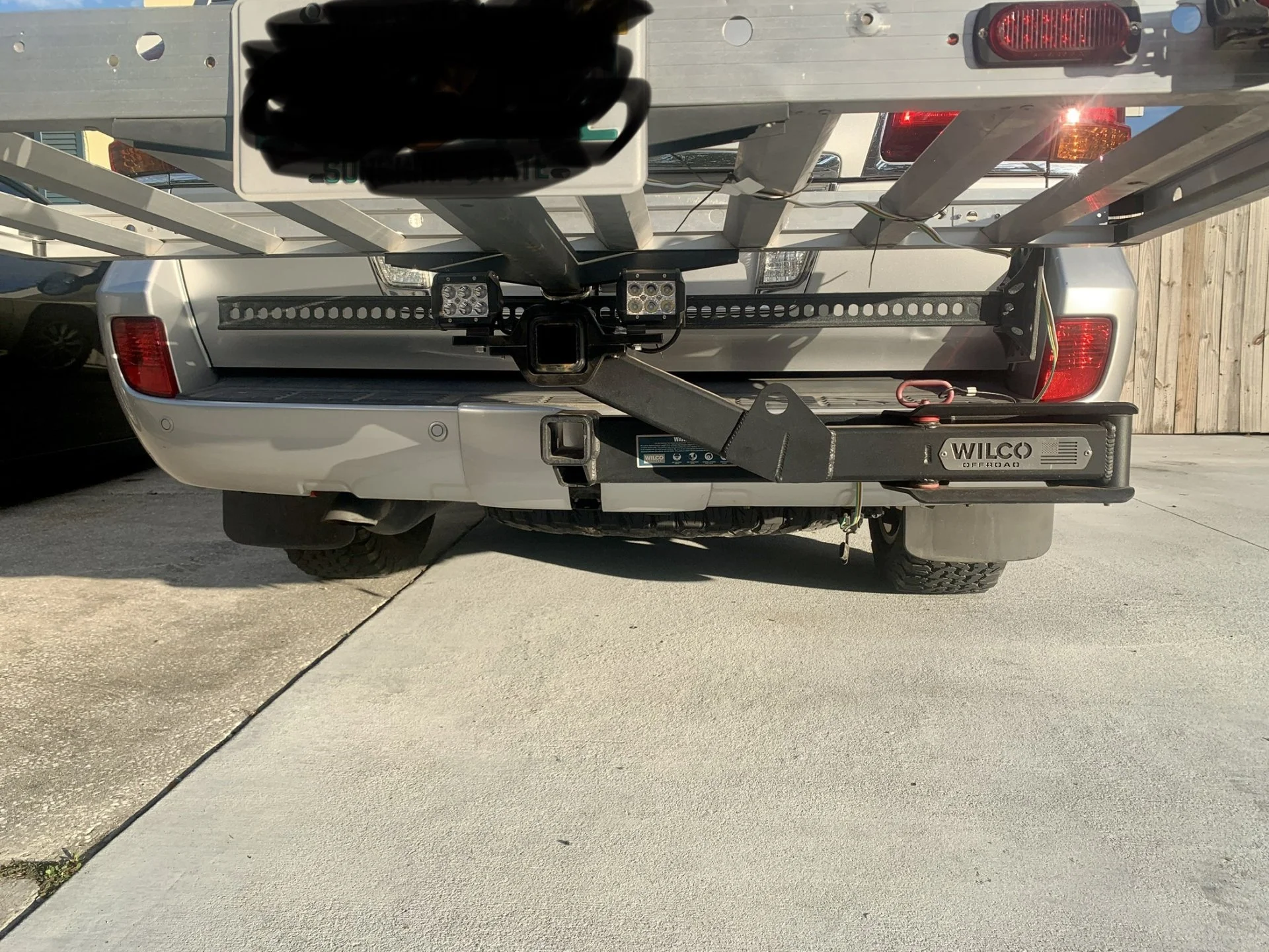

The Wilco is currently configured as such in the picture. I measured and, with the hitch riser, the rear of the hitch carrier is equivalent to the lx’s departure angle. I’ve got a slightly higher riser I’m going to install soon so I can fit my hilift and an axe under the hitch carrier as pictured though.
The Wilco is heavy, but it’s not the thing probably weighing me down.

It seems like you would need to have a significant amount of weight on the carrier to cause that. Possibly more than the safe weight rating of the carrier itself. I have had my carrier loaded with a few bags of concrete and never had that issue.

Other than the Wilco, a hilift, and a hitch riser, there’s no weight in the hitch carrier section.

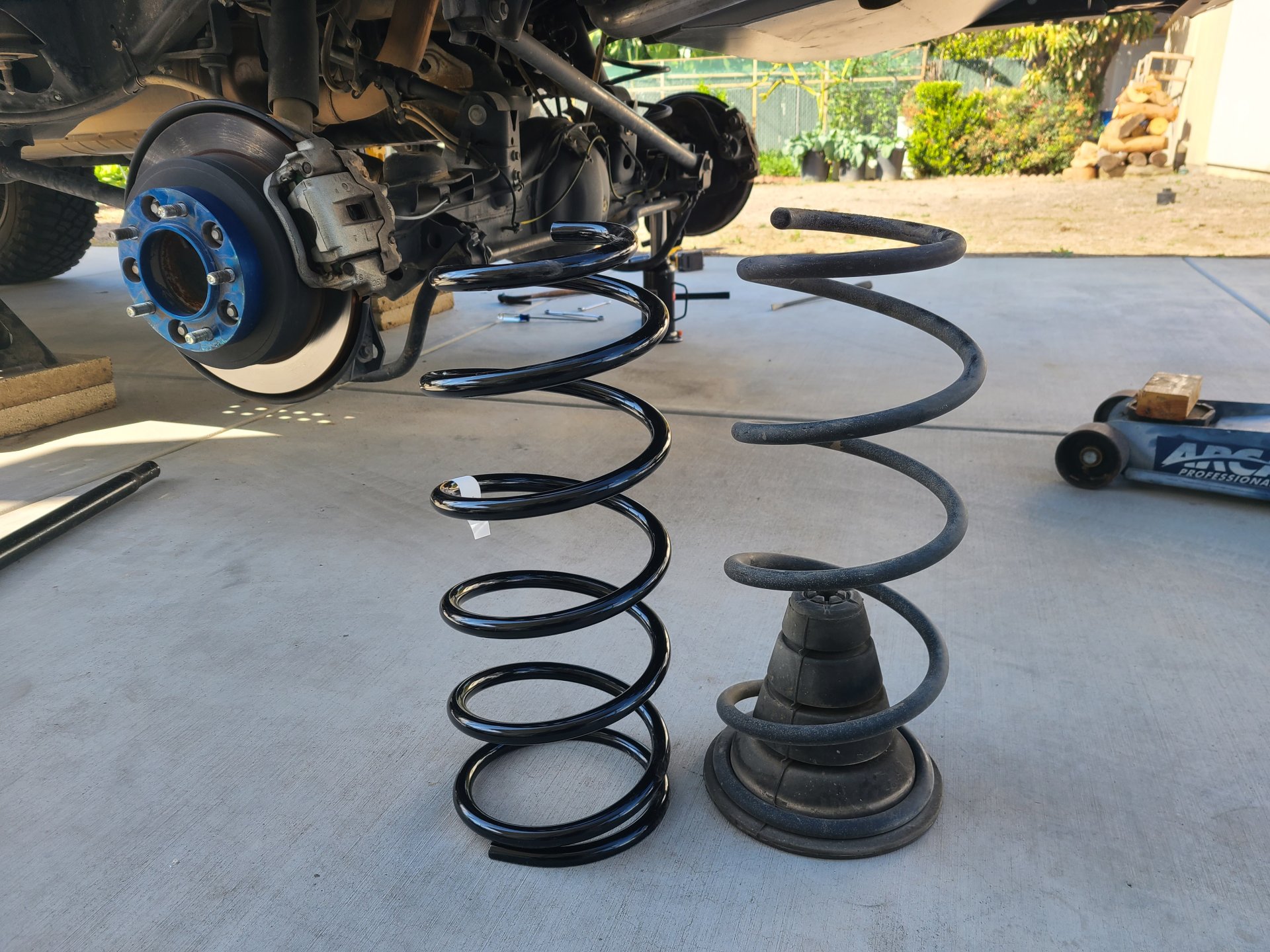

Just got the TT springs direct from TT. I can measure them if that would be helpful for anyone. Will get some comparison pics with stock springs when I do the swap.
Yes please do!

Looking back into these shocks. Did anyone ever figure out the spring rate and length?
TT springs vs Stock
