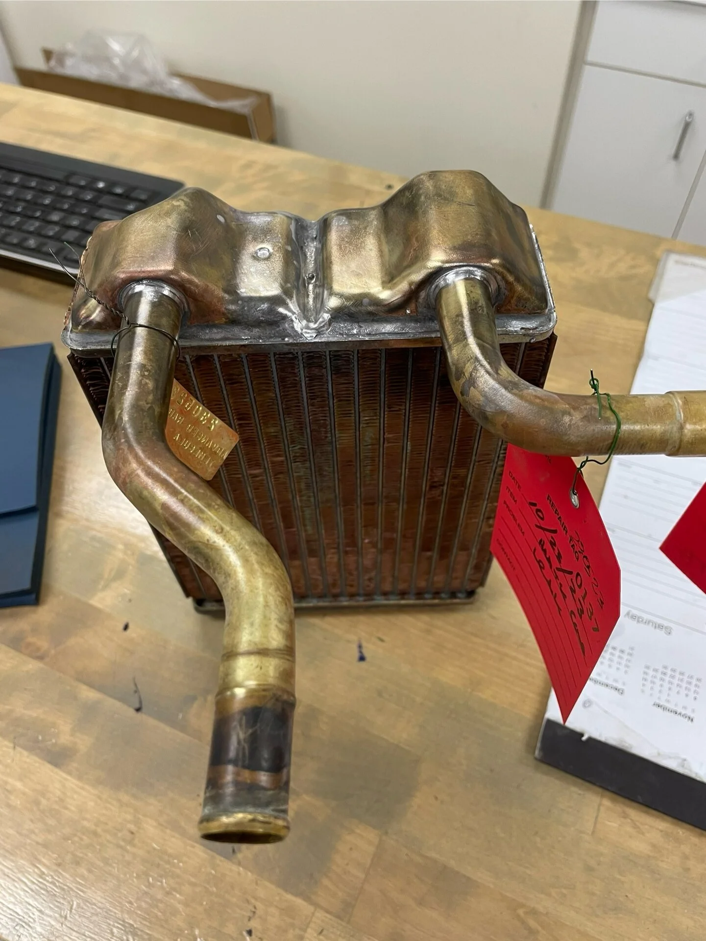

Back to the original point of this thread, I know its not in the Tuscon market, but I just had my OE heater core rebuilt and pressure tested for $85 at Advanced Radiator in Temecula and they did a great job. Worth looking into this option if you are ok shipping it to them IMO. Only took them a week to complete, but varies depending on their backlog. Shipping should only cost you about $20 each way.
Depending on the condition of yours, they may be able to re-solder the tanks/tubes and be done with it. If its not repairable and you need a "new" used core, another great option is to contact @Alex79 to see if he has any sitting around.
Im in that market. What did you do with the foam that goes around the core?
Bought new foam for everything in the HVAC (1/2" x 1/8" seals and 1/8" sheets for the flaps) off Amazon.
For the heater core specifically, this is the seal I bought:
Amazon product ASIN B071RDDC2R
It is denser than the OE and does not compress much and will create a VERY tight fit when you slide the core back into the housing...but it works.
