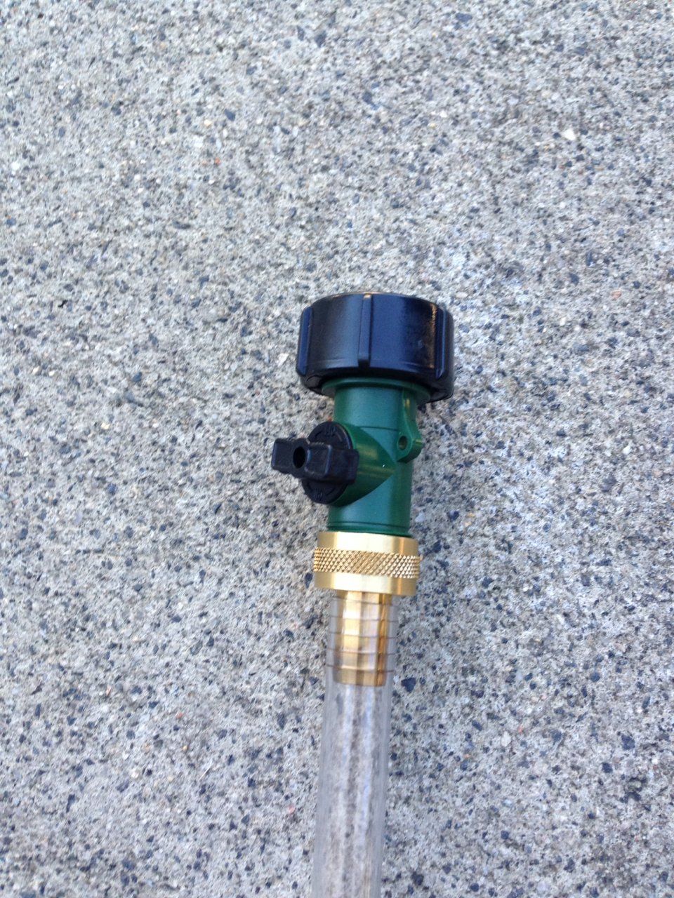

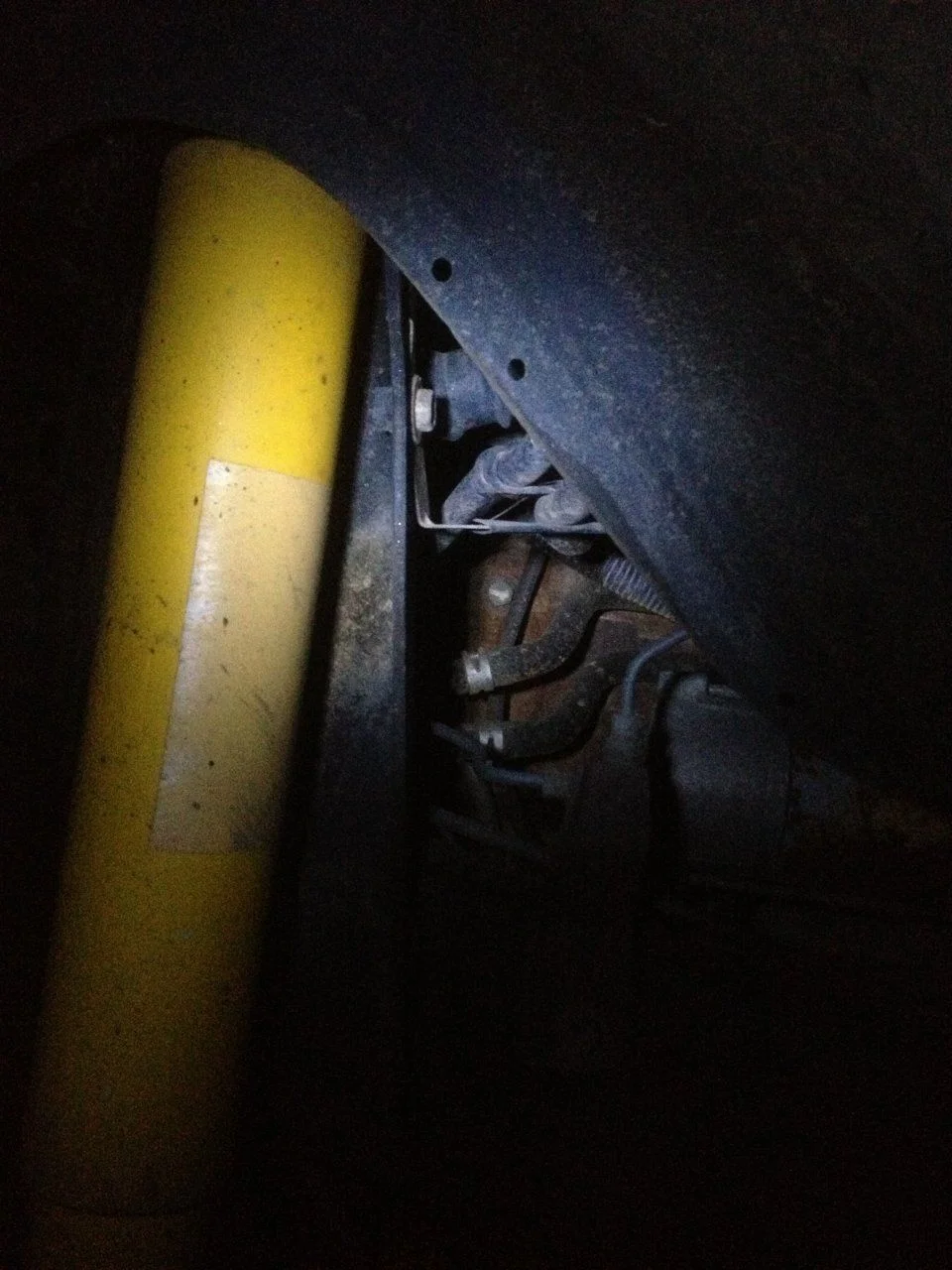

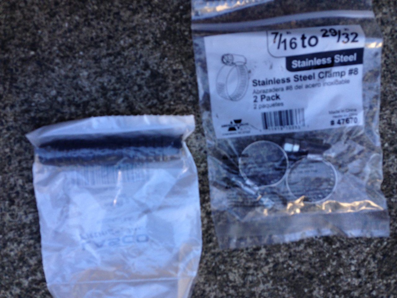

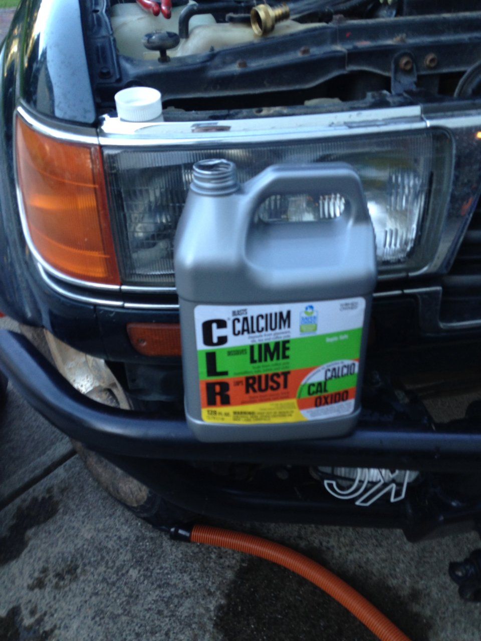

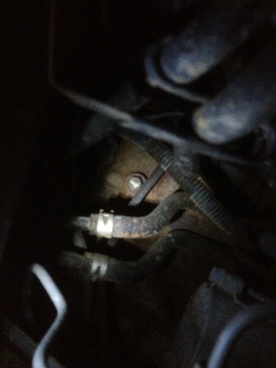

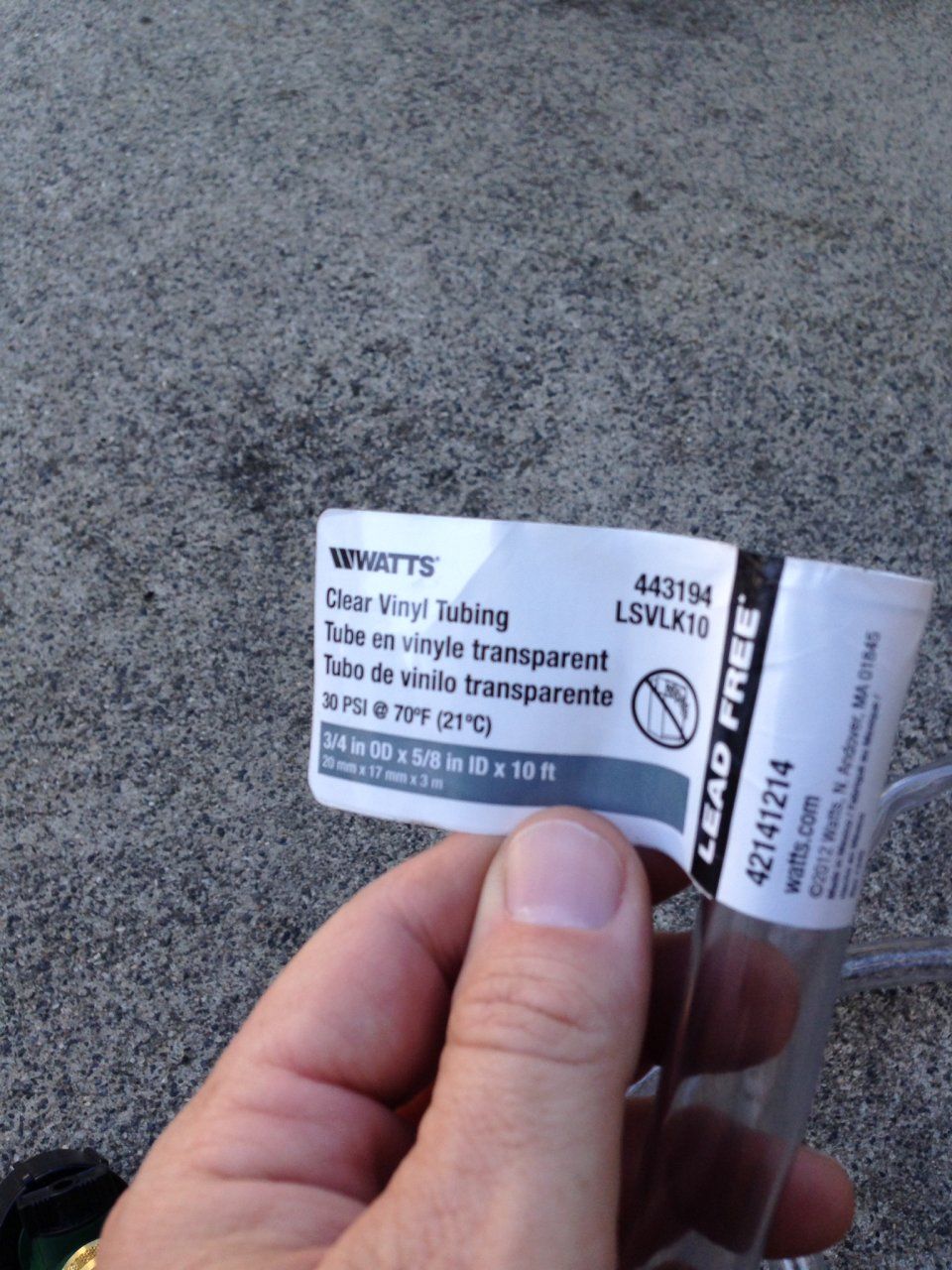

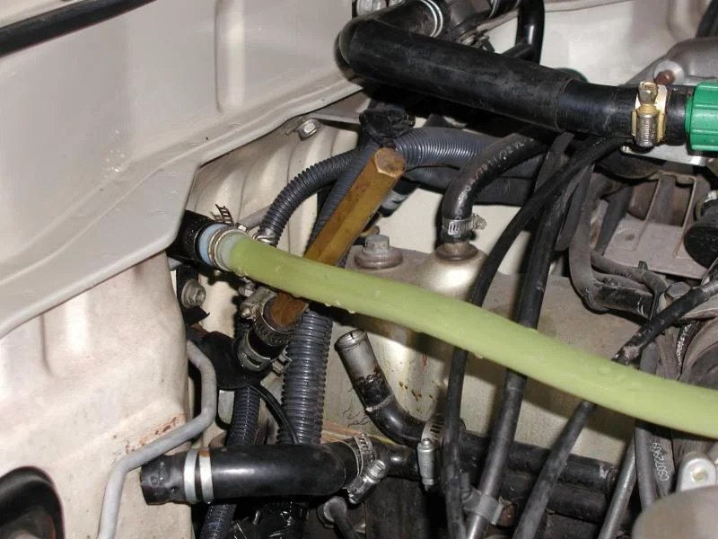

In ya face mama! I did it, I am not a total idiot (only partial idiot)! Here's what I did.
From Lowes got this morning
CLR 128 oz
10 ft of 5/8 ID Clear hose
6 ft automotive coolant hose (for the screw ups I knew would happen)
2 1/2" barbs coupling
1 brass hose connector to 5/8" barbed fitting ( most expensive item at $7)
1 hose connector with ball valve
1 gallon Toyota Rd coolant
3/4" hose band clamps
5 gallon Home Depot bucket
Shop vac connected to blow air
Clean funnel
View attachment 1144249View attachment 1144250View attachment 1144251View attachment 1144252
Stole my wife's remaining distilled water . Don't tell her.

Did this today, went all last winter with literally no heat in the 80. Feel really stupid for waiting so long to try this. I kept thinking all along that my problem was in the automatic climate control but was the gunked up heater core all along. Followed your write up and list Izzy and it worked like a champ only deviating where my rear heat has been deleted. Also on a side note, as far as supplies go if you get the 5/8 barbed to garden hose adapter in the garden section at Lowe’s it’s only $3 versus the $8 one in the plumbing section.
