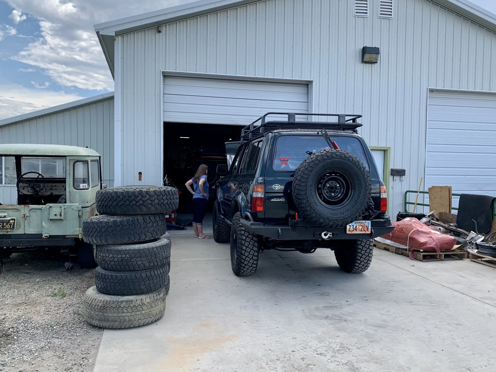

Friday morning we left Ogden for Billings, it's about an 8-hour drive. About half-way into it, just like in the spring, A/C started to fade out. But this time it was WAY HOTTER outside. Blindly following the instructions of the Toyota dealership I started calling parts houses in Billings for a new compressor and checking car-part.com for used. Nothing to be found. Then started this thread.

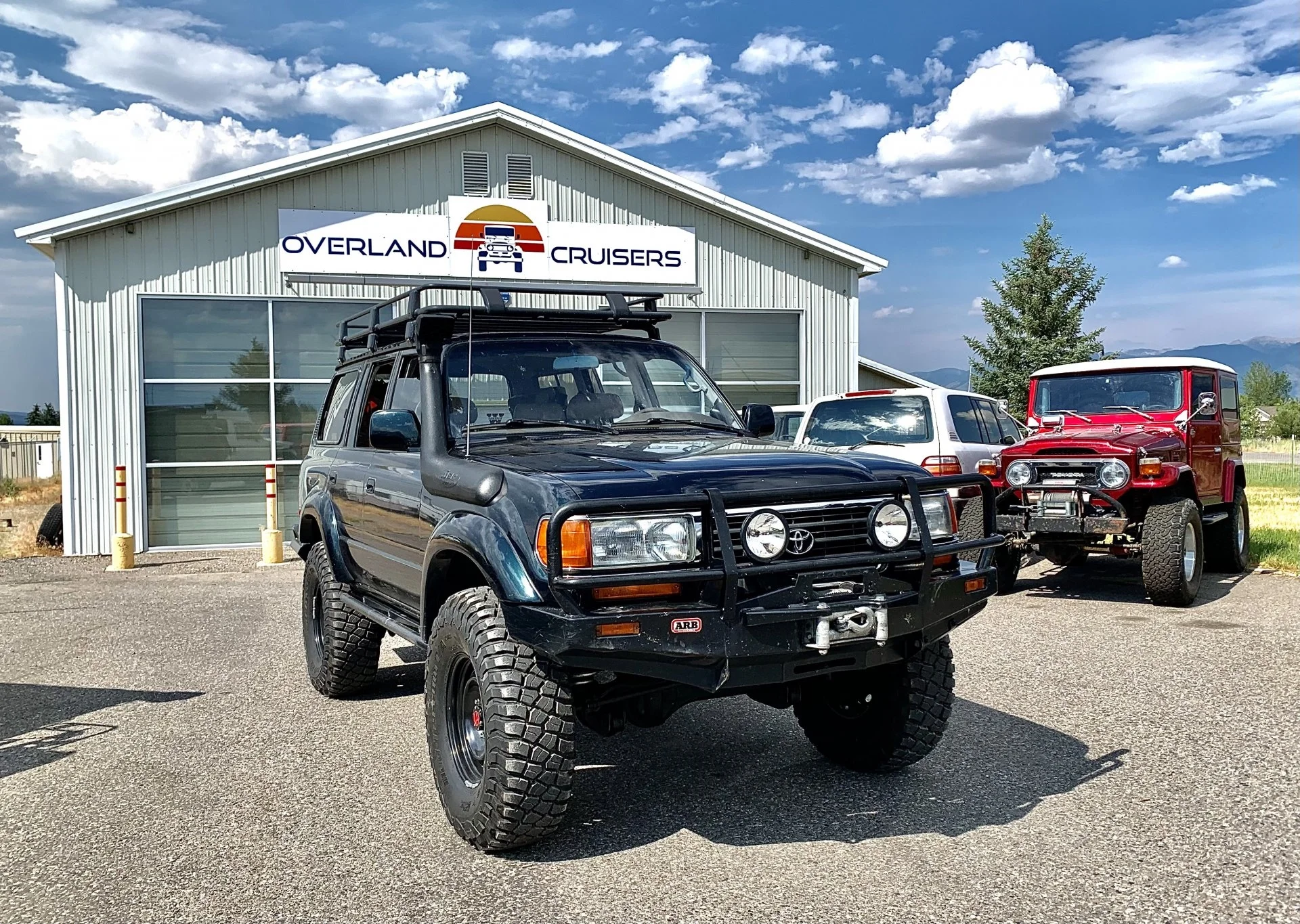

By the time we came down from the mountains past Big Sky we were suffering pretty badly. On Highway 191 outside of Bozeman we passed a place called Mike's Off Road that had a modded 60 and a couple of 40s parked out front. I stopped and asked if they knew where I might source a used compressor. Nice guys there. One tech apparently was a Toyota fan and quickly spammed all his cruiser friends. Then they mentioned Overland Cruisers on the other side of town so we set out for them.

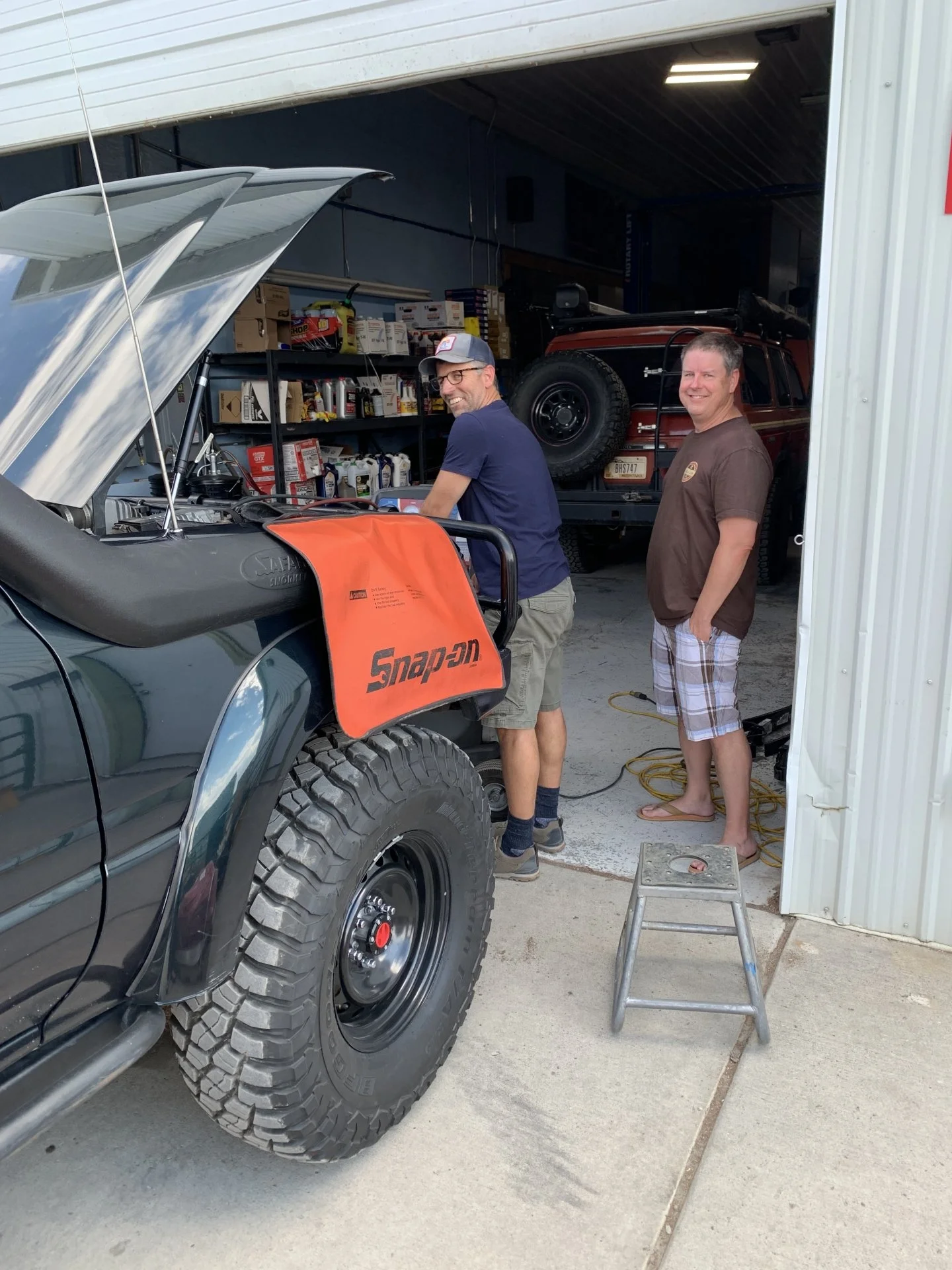

We were bummed when we pulled into Overland Cruisers and found posted they're closed on Friday. I tried the door anyway and it opened... Long story short Stephen and Darren at Overland Cruisers are two of the coolest, most generous, cruiser knowledgeable people you'll meet. They took time away from their own projects to try and help us out.
After evac and recharge and watching the gauges I could see the low side dropped too low. We all came to the conclusion there is likely a restriction in the system. More head scratching. I knew from calls earlier there were receiver/dryers available. Cheap and easy to replace so I decided I would start there. Stephen evacuated the system for us and we got back on the road, better for meeting and getting to know those guys, but still boiling in the cab.
In Bozeman I stopped at an O'Reilly and picked up a receiver/dryer, a bit of PAG 46 and a couple of cans of 134 and threw that at it. I could tell when I looked inside and blew on the old receiver/dryer I was wasting my time and money...

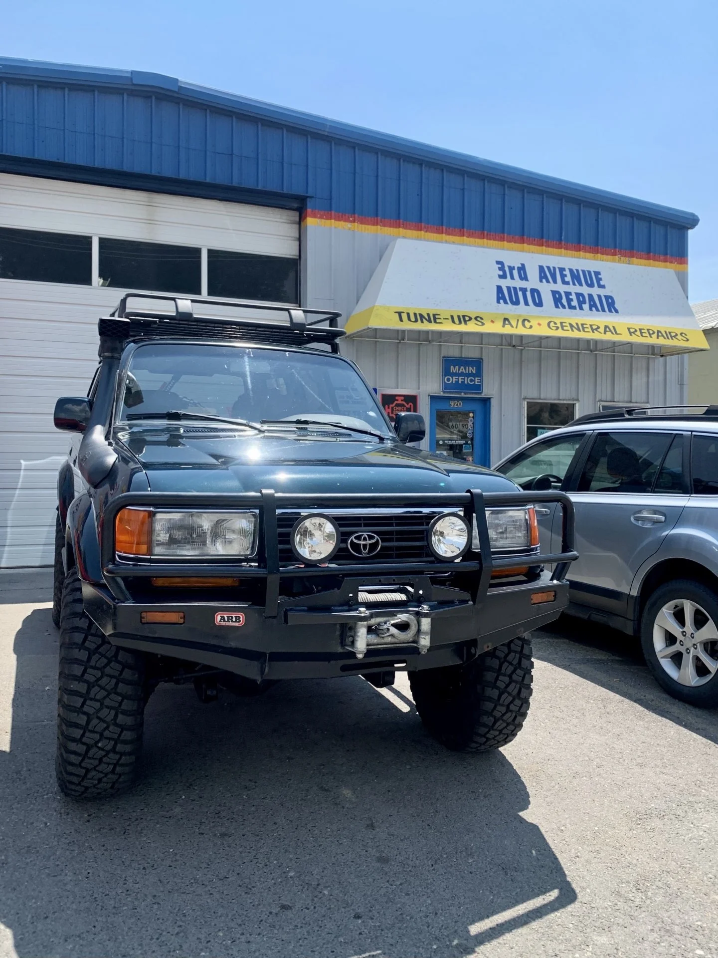

Driving from Bozeman to billings was miserable, but gave me time to think. After my conversation with Stephen and Darren, and starting to remember how AC systems work from a course I took 25-years ago, and how unlikely it is the compressor would have an intermittent problem, and because a compressor is expensive as hell, and because a sticking expansion valve seemed a more plausible cause of an intermittent restriction, and because I called and found an expansion valve in stock at Napa in Billings, and because it was only $34, replacing the expansion valve was obvious next step.
On Saturday morning I drove around (AC started working of course) Billings and called a bunch of places hoping to find someone who could properly evacuate the system again, and recharge after I got the expansion valve in. I found EVERYTHING was closed for the holiday weekend. I was to was about to give up hope when I stumbled upon a hole-in-the-wall shop, 3rd Avenue Auto Repair, that was open. Again, SUPER great people. Owner Don Stokoe is on of the nicest, knowledgeable people you'd meet. (I always thought people moved to Montana for the beautiful open country. I'm beginning to think it's more than that.)
I told my story to Don as we hooked up the gauges. Again, more head scratching. While he still has some reservations about the pump, he agreed replacing the expansion valve is the move.

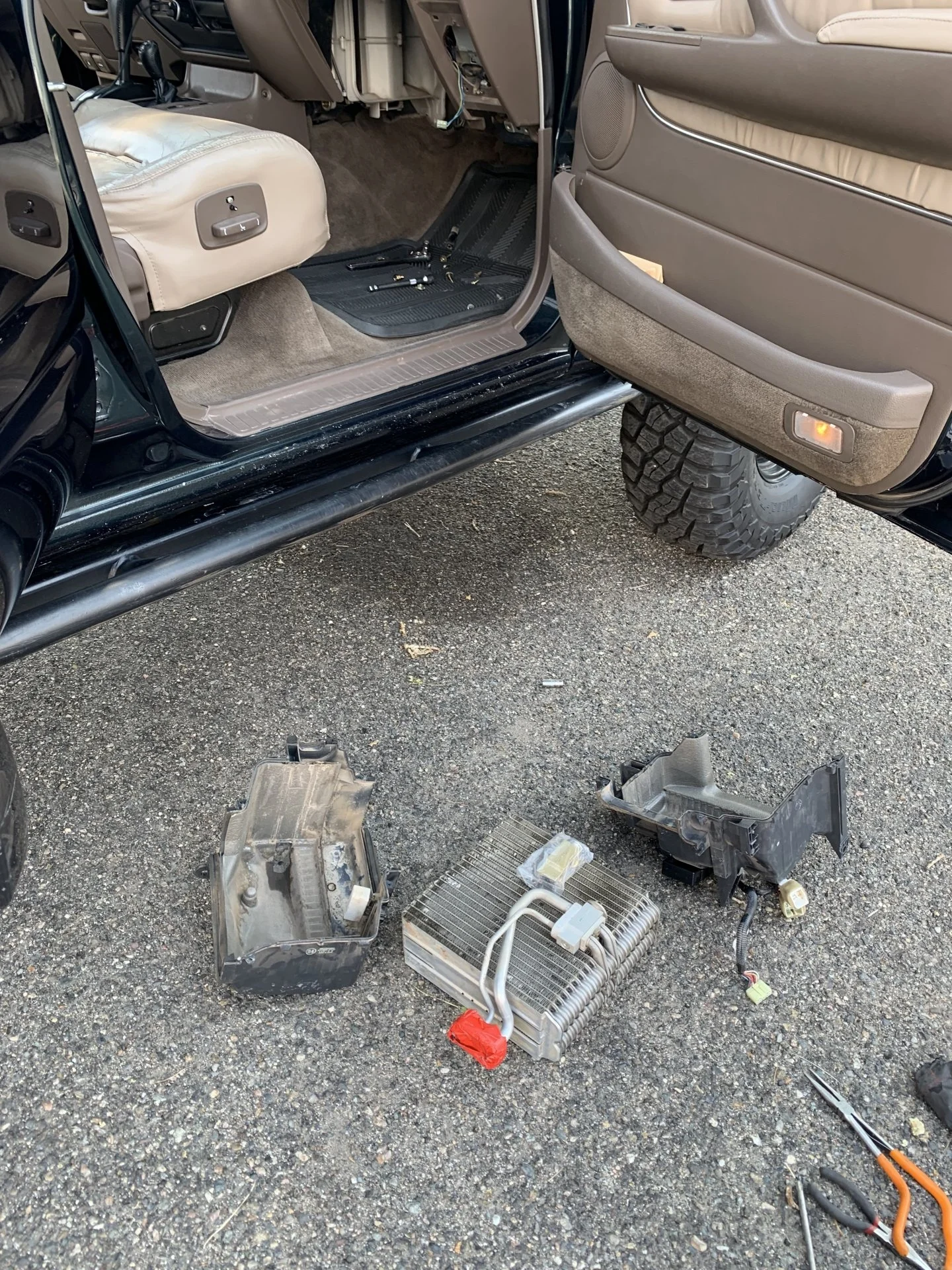

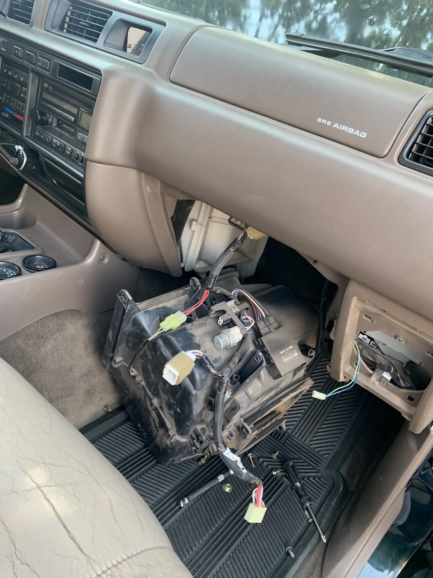

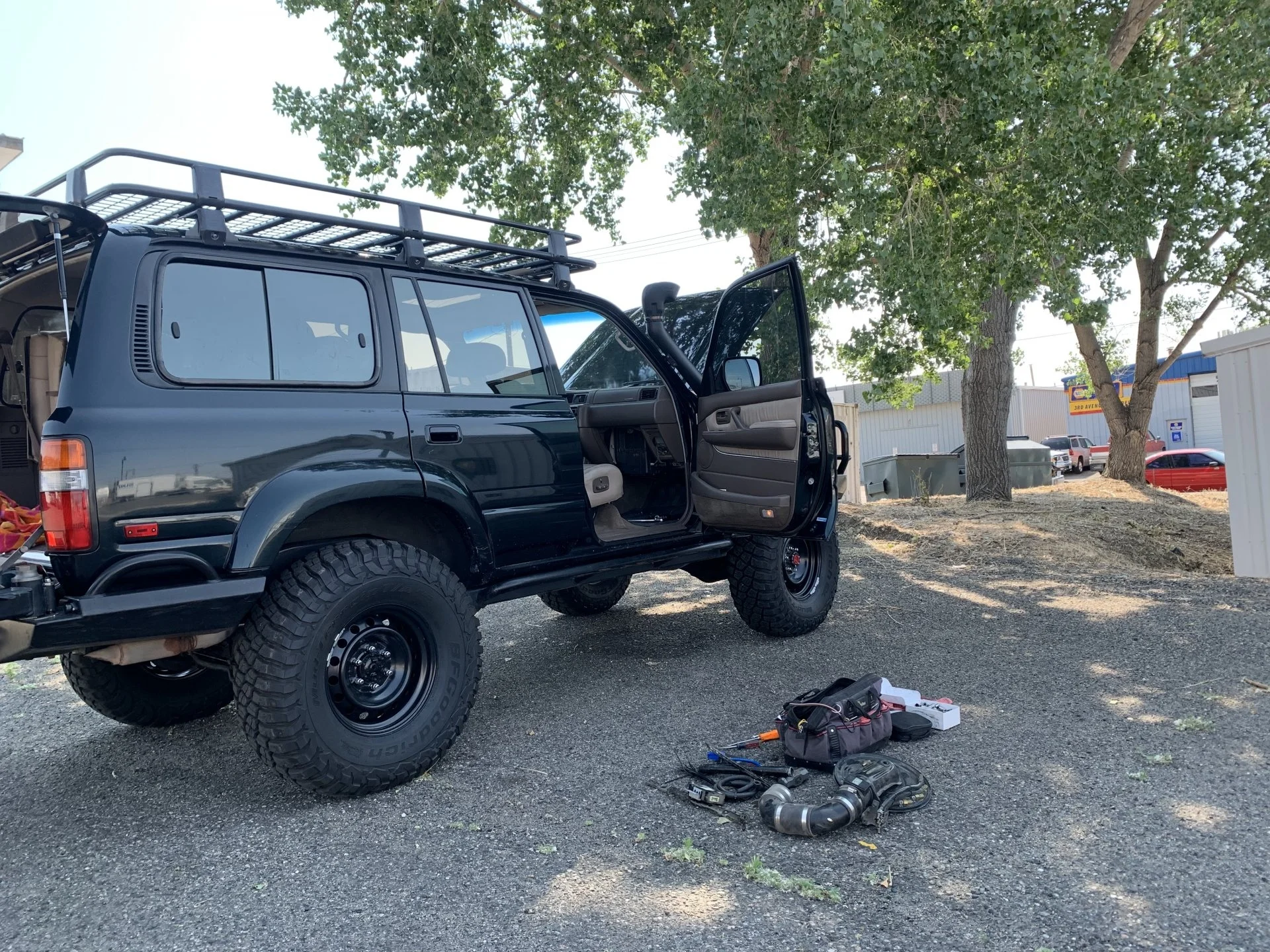

After Don evacuated the system I found a nice big shade tree to work under in a parking lot across the street and started taking the glove box apart. I had the expansion valve in my hand in about 45 minutes. Carried it over to the shop and Don helped me clean 26-years worth of dirt and garbage out of the evaporator fins and the case. Had it all back together in about an hour. Then vacuumed and charged...
I drove around Billings for a bit, then took the freeway out to Shepherd where we're staying. Drove for over an hour. A/C worked flawlessly. Maybe it's just because we were freaking dying of the heat the day before, but I swear the A/C works better than it ever has since I bought the truck with 45k miles. Still don't know for sure the expansion valve fixed it, but have a good feeling it did. We'll likely know for certain tomorrow when we head for home 🤞🏽

After Don evacuated the system I found a nice big tree in a parking lot across the street and started taking the glove box apart. I had the expansion valve in my hand in about 45 minutes. Carried it over to the shop and Don helped me clean 26-years worth of dirt and garbage out of the evaporator fins and the case. Had it all back together in about an hour. Then vacuumed and charged...
