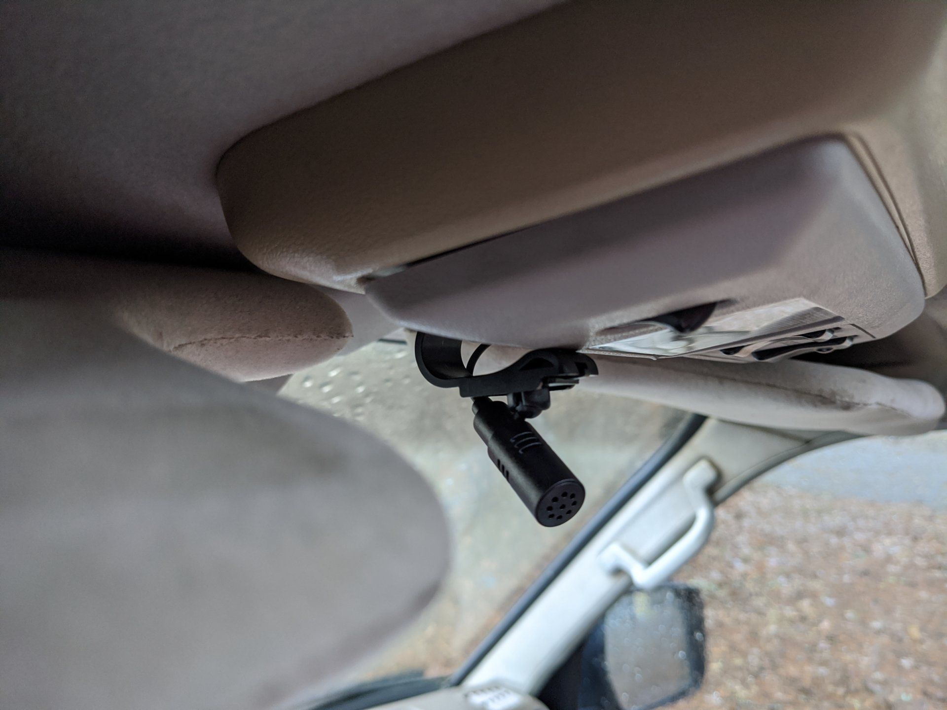

I ran the cable across the headliner and down the passenger A pillar. Then I clipped it into the sunroof controls. It's as close to the driver's mouth as possible, but I'm not happy that it's as clean looking as I would like. I'm still considering something a little more subtle, but it works for now.

View attachment 2271313View attachment 2271313
If you get rid of the clip and just use a piece of double sided tape it'll look a lot more subtle, especially taped to the front edge of the control panel.
I'm in the top of the steering column camp. It's easy to pop the wire over to the radio from there and really doesn't stand out unless you're looking for it. I only get complaints about not being heard if I have the windows down and I doubt any different placement will fix that.

Mine is at the sunroof area by the dome light:

I disassembled the clip and just left the metal tab (cut in half). It is held in place by tension of the dome light cover.
